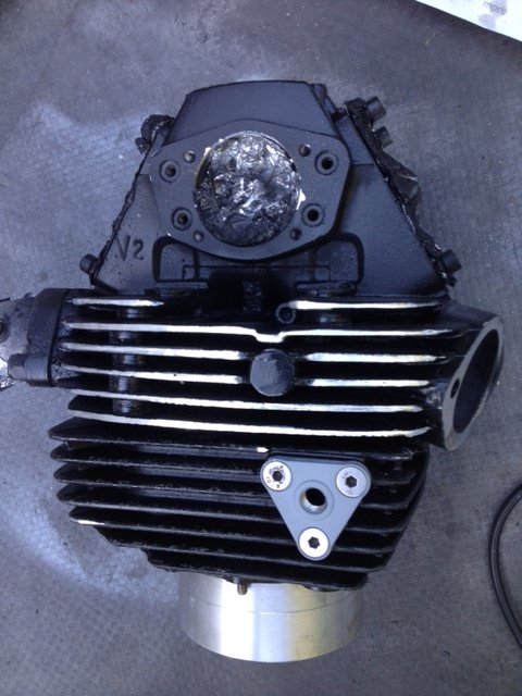

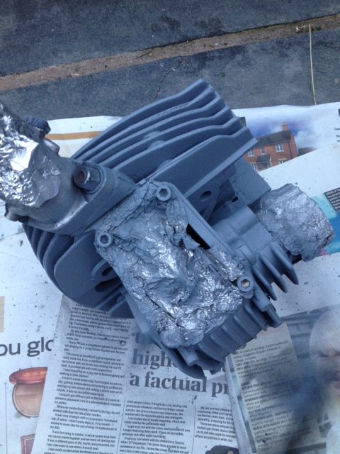

  1. Inspired by NYDESMO.com I've resprayed my heads using etch primer and then satin black, then dremel'd the fins edges to achieve the required finish. This works best on the lower cylinder head half which is the original powder coat finish, but the resprayed upper is trickier as some of the paint around the edges has flaked off in the process. Any ideas how I can overcome this?

  2. I've been thinking about this. I think I will finish the polishing, then mask the polished edges and respray where the paint has flaked off. Then lacquer to prevent corrosion of the edges (as suggested to me on a previous post) and hopefully 'seal' everything. It probably won't be as durable as powder coat but the cost for that would be much higher.

  4. Etch primer does not stand up to heat very well unfortunately so high heat can cause flaking at a later stage. Polishing the edges might be easier if you do it when the paint is still soft and is less likely to flake or tear, or you could try scraping it when soft with a plastic grouting tool. This makes a good strong scraper for soft surfaces and does not dig in to the metal.
    I use Hammerite satin black for painting cases and that stands up to wear and tear very well, although it obviously does not get as much heat transference as a cylinder would. If cured correctly though it is one of the best finishes I have tried and it is not necessary to use a primer.
  5. i would say paint and then use a fine sand paper to sand through edges without chipping paint.. maybe 180 0r 220 grit on a block
  6. Thanks for the tips and advice, for info I used Auto Glym Satin Black but never thought about Hammerite although I see that comes in aerosol spray form too.
