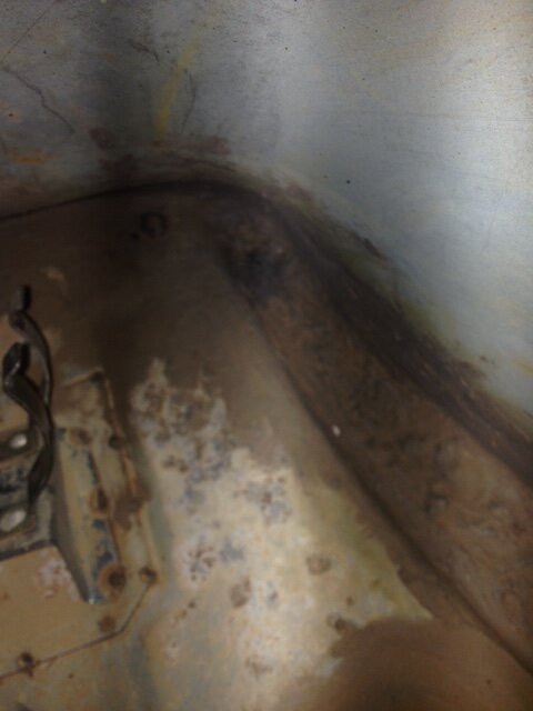

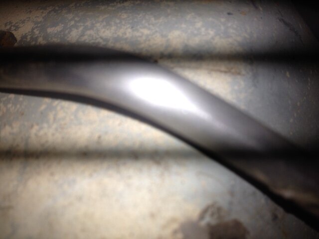

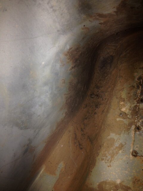

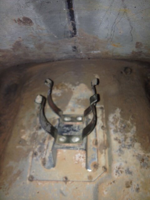

  1. I bought this as an extra tank, because it's the earlier version which I need for my refurb project. It is supposedly water tight (fuel tight), but does show some signs of surface rust. I've never used it myself yet, so thinking that belt and braces approach would be best, and treat the inside.
    What's the best product for the job? POR 15 ?
    Sorry about the photos, I need a proper inspection camera really.
