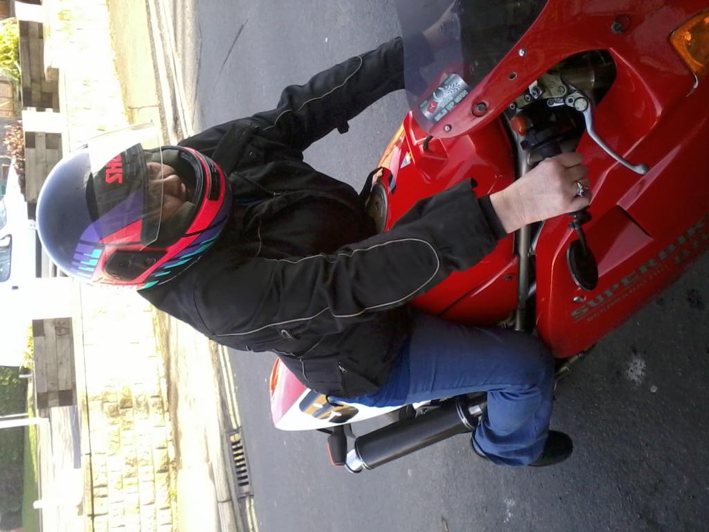

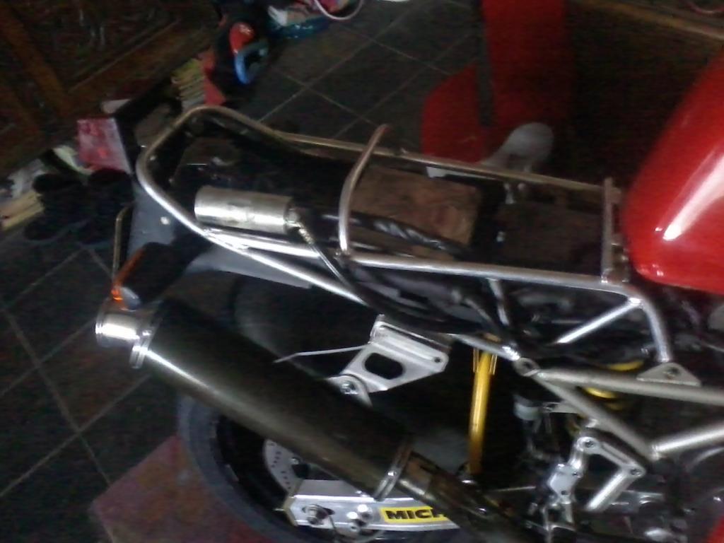

  4. 2013-01-09 12.59.30.jpg 2012-12-08 11.17.06.jpg they are superlight pattern link pipes
    that are the same as the 888 SP's
    regards Steve B

  10. that's a better view of how my links pipes run
    Steve B
