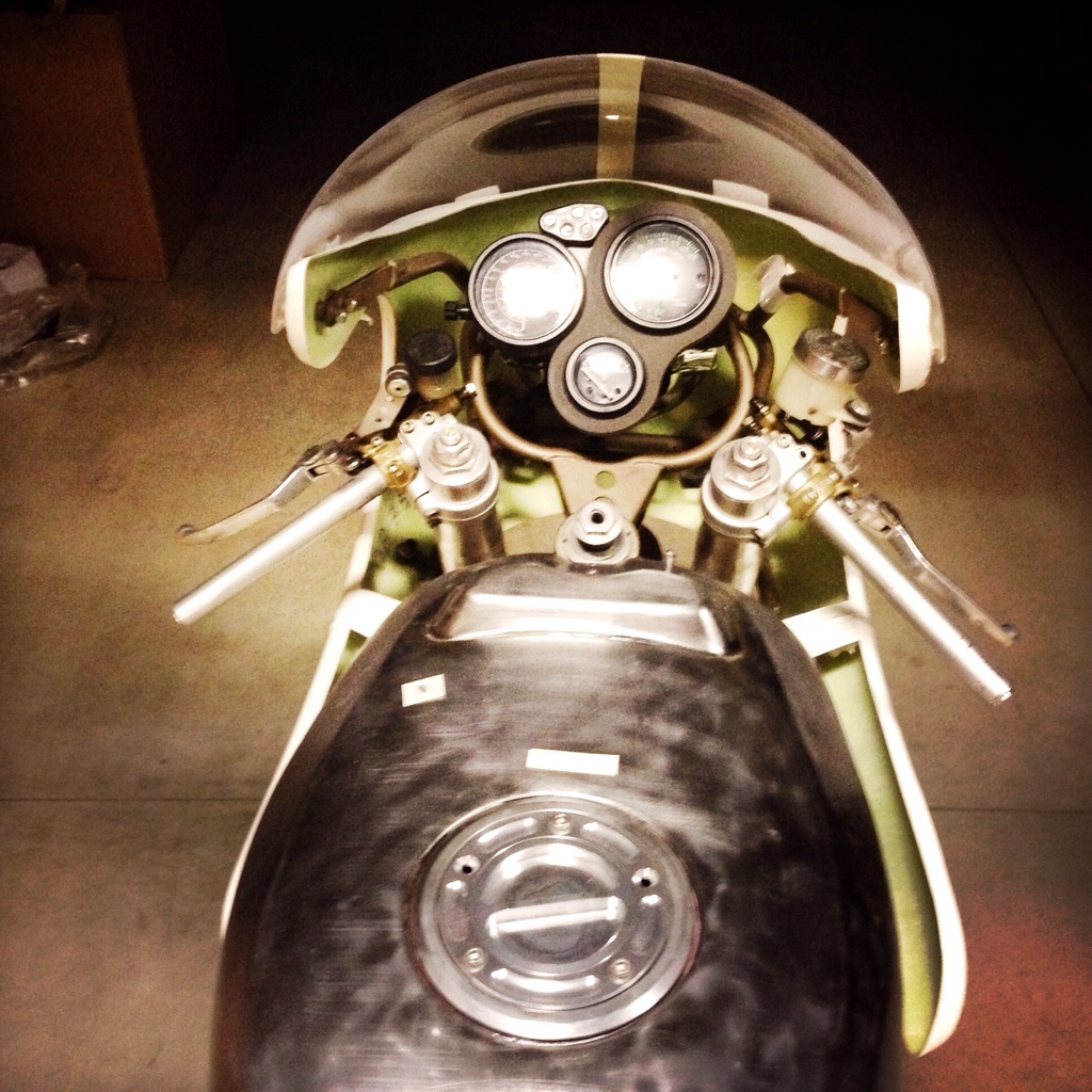

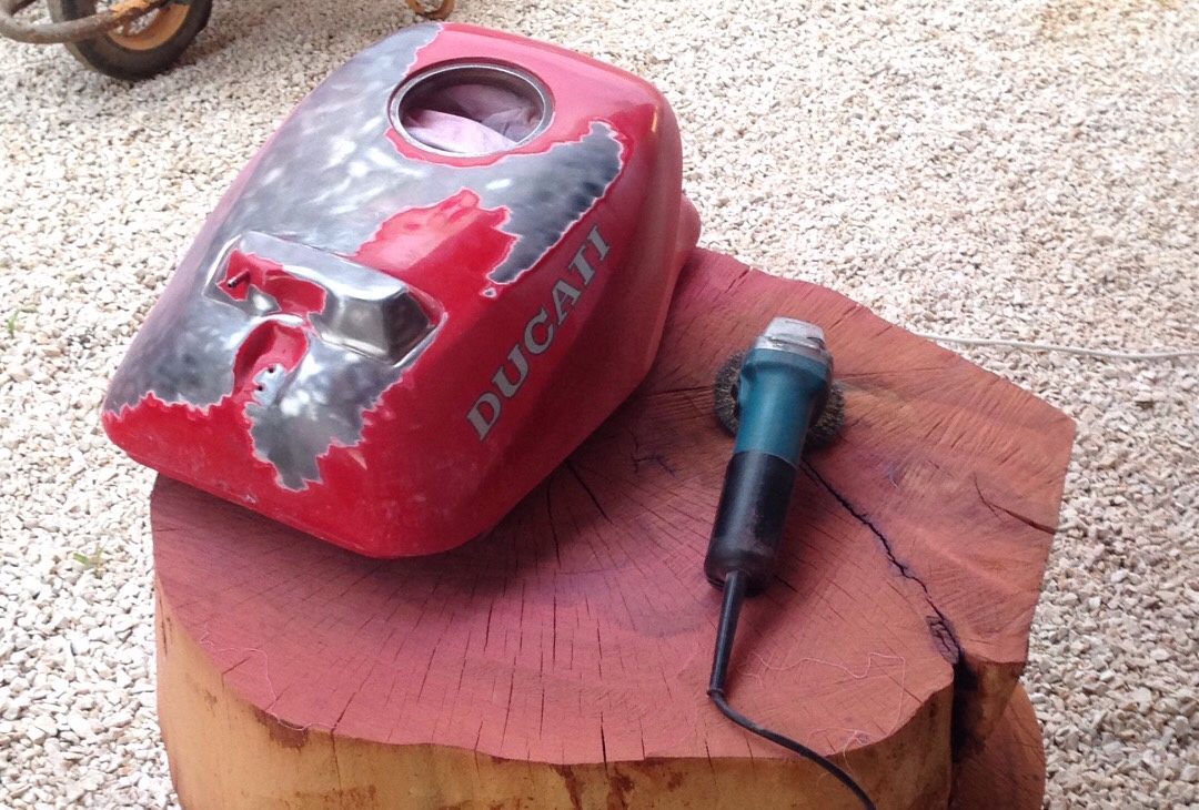

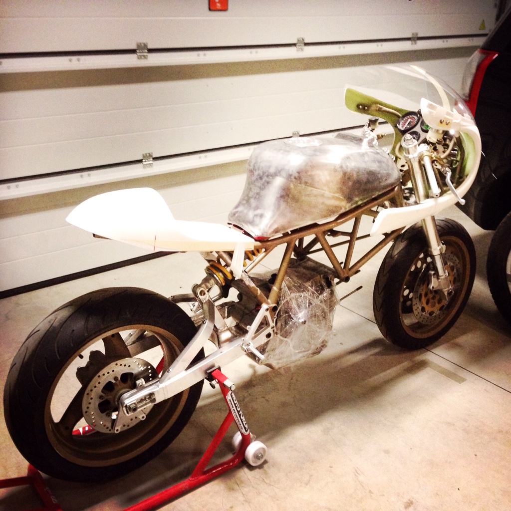

  1. I am restoring(yes) my 98 SS ie, and i wire stripped the tank, and the look is amazing. Is there any treatment i can apply in order to keep the bare look(except switching to aluminium)? Maybe laquer, with a previous treatment under it? How about under laquer decals? Many tanks for the input. [​IMG][​IMG][​IMG]

  4. Sorry to the OP, but I think it will look awful, and the slightest chip of the lacquer will soon cause rust creep under it, so it will look even worse.
  5. I want to give the buke that old pantah look, but alliminum tanks are expensive, and the shape of the pre 98 is alright. I don't want to try a silver paint, as it will not fall as nice as hand polished, battle bruised bare metal. If i wanted a new bike, i would just get one:)
