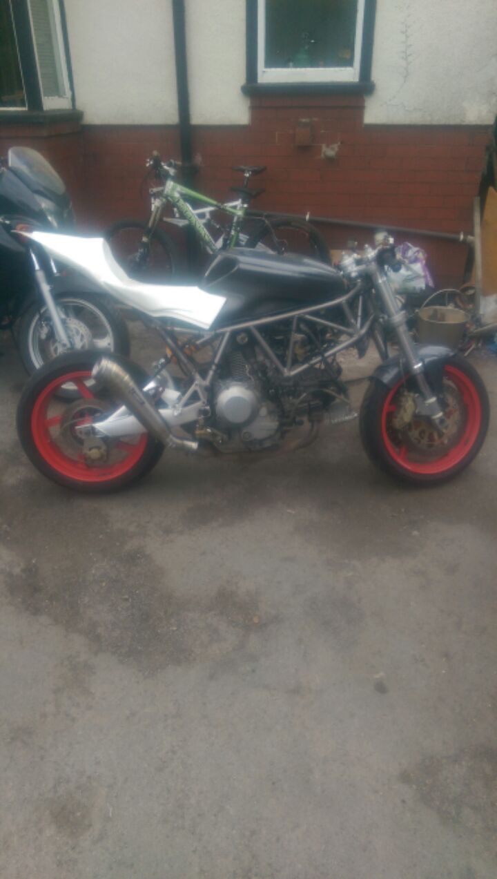

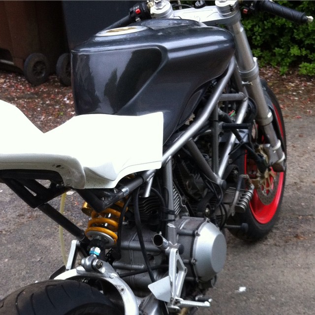

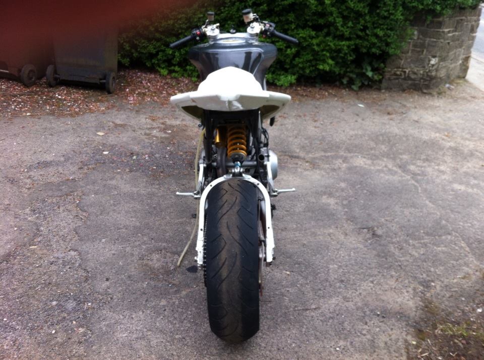

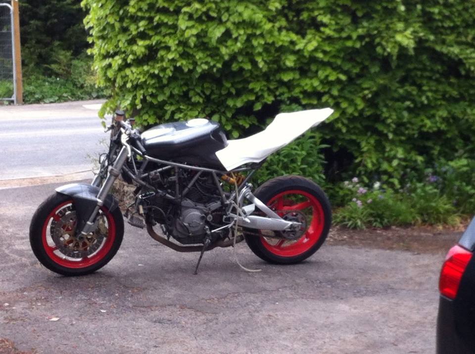

  1. Hi this is my 900ss ie build some pics
    subframe.jpg welding completed.jpg bike side on.jpg rear view.jpg subframe.jpg welding completed.jpg bike side on.jpg rear view.jpg rear 34.jpg
  2. Looking good Karl.
  3. More pics please!

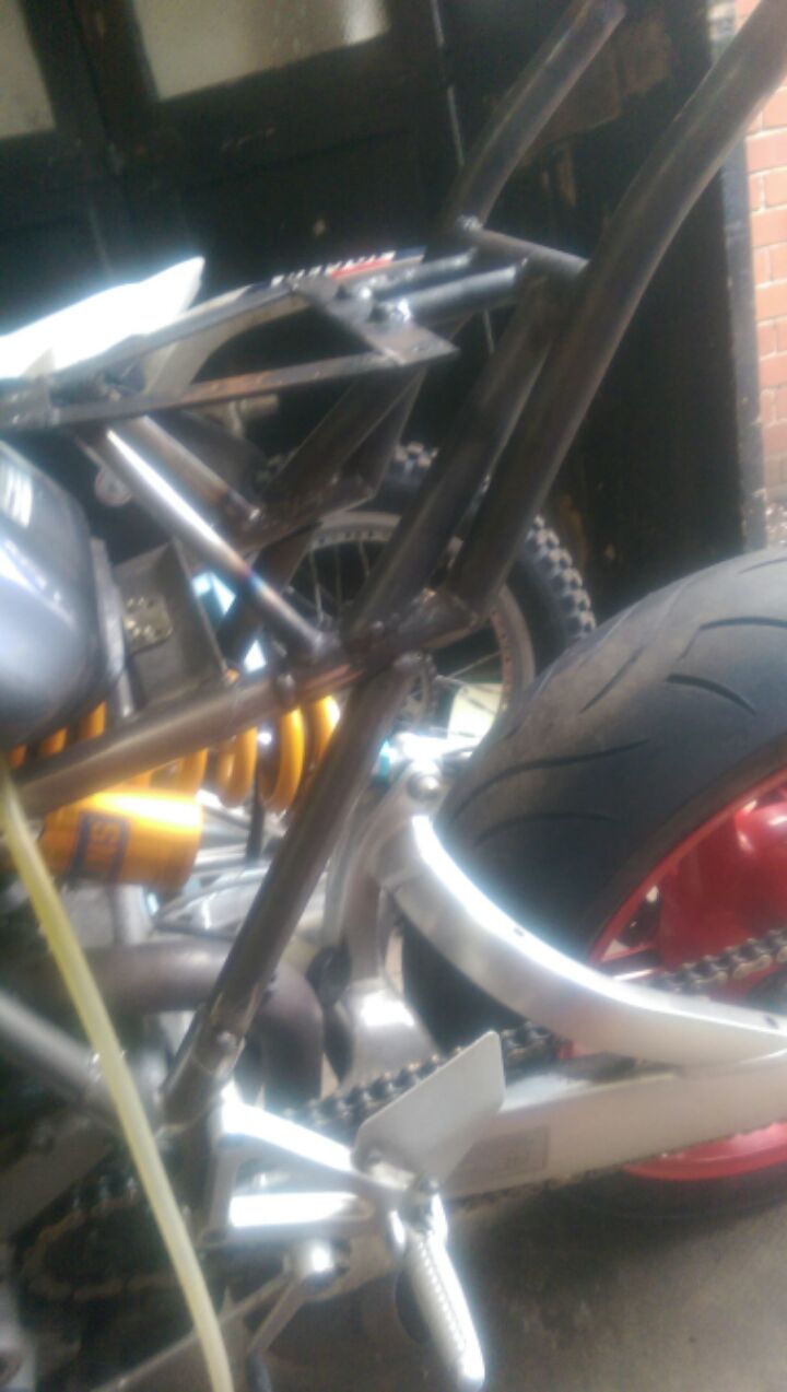

  4. The tail piece is a race bodywork kit from a BMW 1000ss we are going to cut it to line up better with the tank and also take about 5 cm off the back.
    We will also add a single sided exhaust.
    The subframe was fabricated from 4130 chromoly tubing from TW metals and the thinner bracing from a bike frame made of the same material.
    Currently fabricating some velocity stacks.
    Next steps are fabricate exhaust for a single sided silencer, source a headlight, delug frame and relocate electrics.

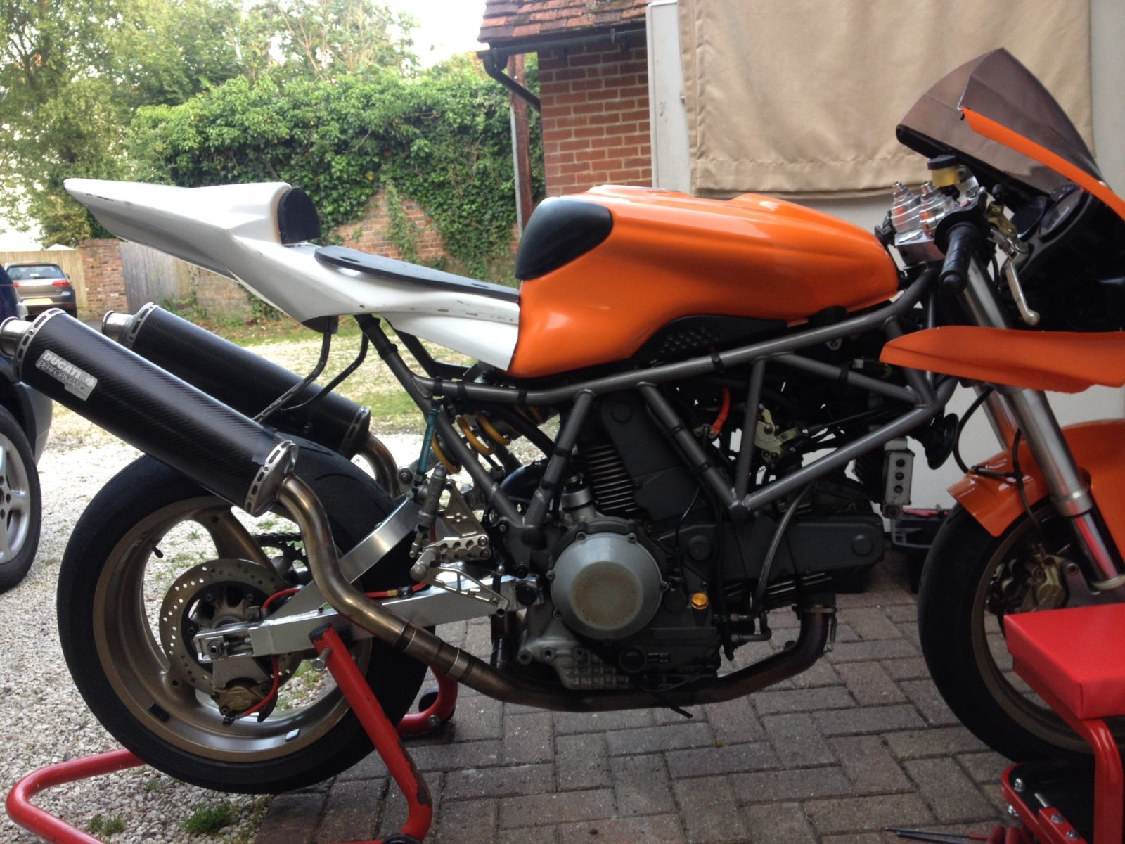

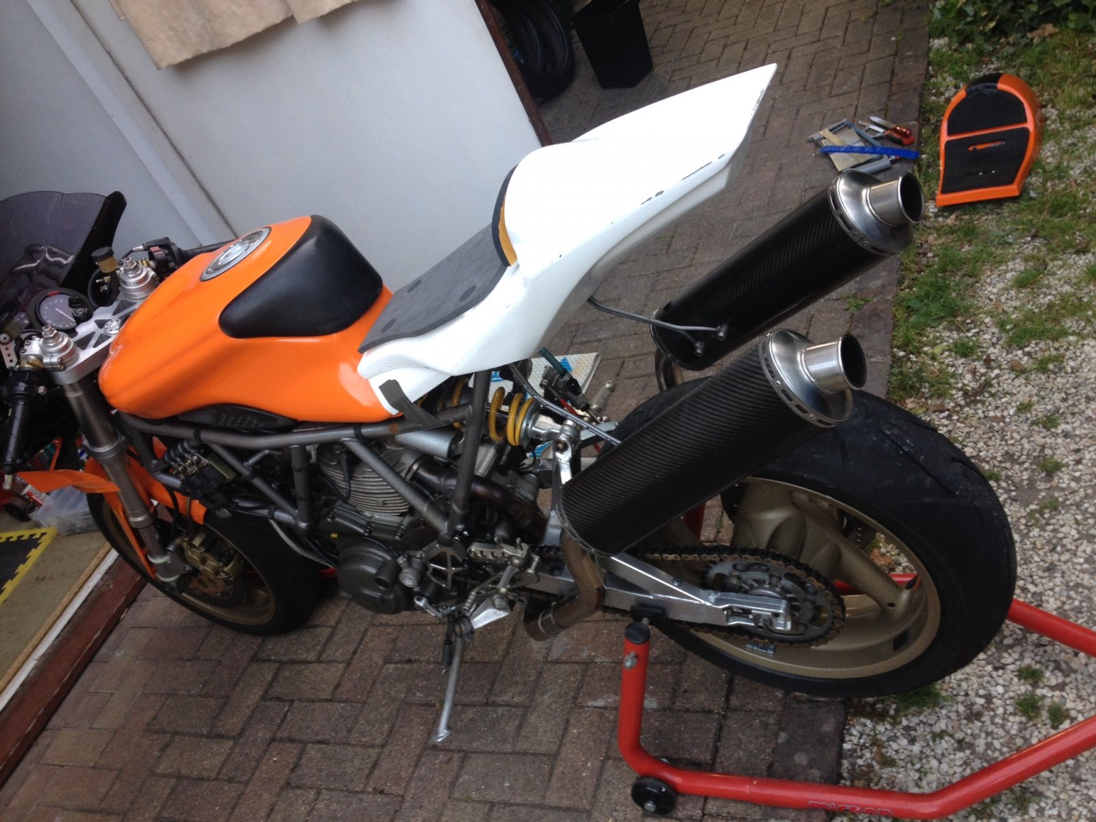

  8. junked the exhaust? you mean 2 into 1 or? I would love to get rid of the silencers, they are so heavy. But not the headers, just replaced them with a full system from MADASL(stainless and bigger bore)
    seat is racing seat for a Honda CBR1000 that was destined for my SV650 originally.
  9. hi i bought a mivv ghibli silencer for 2 into 1. will fabricate the headers to make it fit...my 18 year old nephew is doing this hes a bit of a genius with metal.
