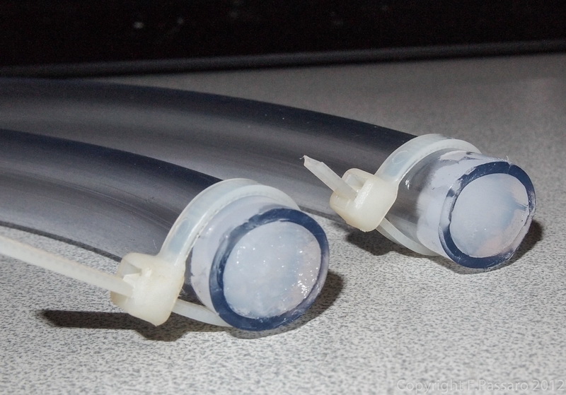

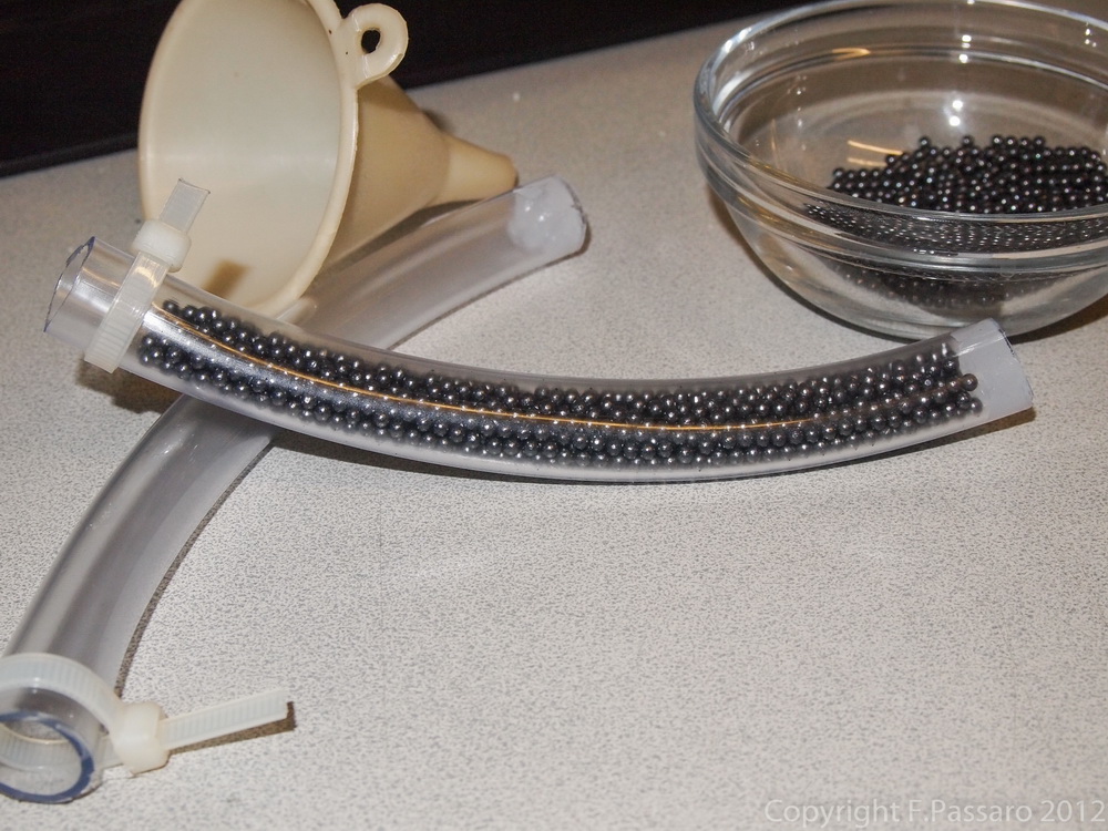

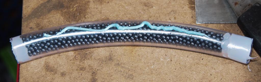

    Having a think about it for a few days and trawling the web I've come up with a solution that may or may not work and I'm detailing it below for future reference:
    First stop was BN&Q to get hold of some silicone tubing of the right external diameter to make a tight fit in the bar's internal bore - I then cut two 16cm Lengths. I used cable ties to keep a roundish shape to the tube whilst the silicone cured as it had obtained a flattish elliptical profile from the storage reel in the store.
    Next I plugged up the ends with some clear silicone - (more like opaque if you ask me)

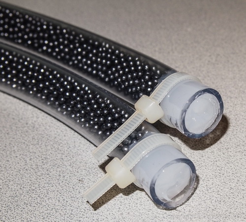

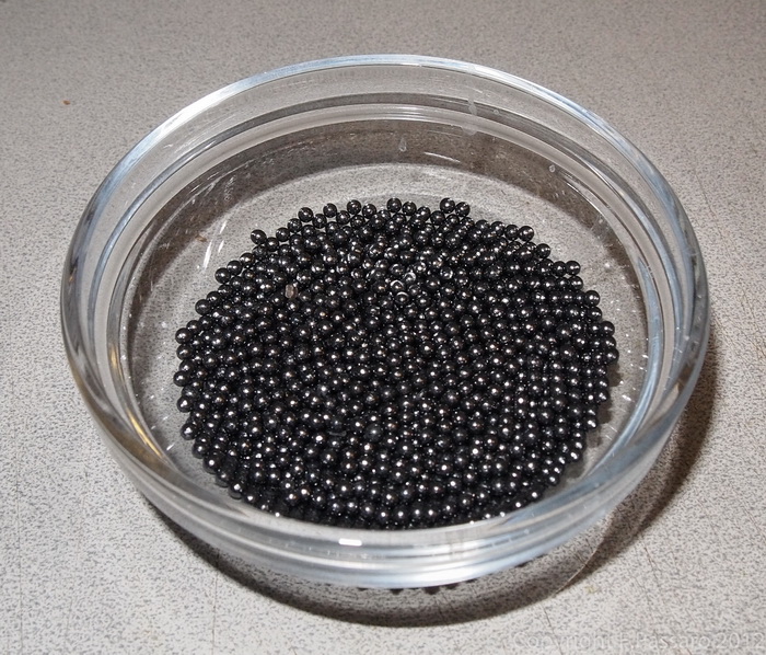

    In the mean time I acquired some lead shot - as I shoot clays - 6 shotgun cartridges became the donors for this! ;)
    With the silicone now set
    I filled the tube with the lead......

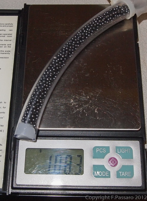

    this is the weight of one
    and then of the other

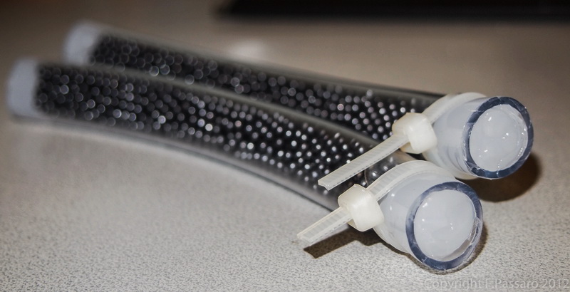

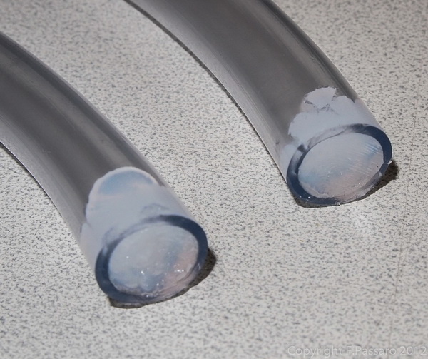

    I made adjustments to make each tube approximately 109 grams in weight - i wanted to keep them more or less equal in weight as was possible.
    then as before I sealed up the tubes with silicone again and will leave them to dry overnight.

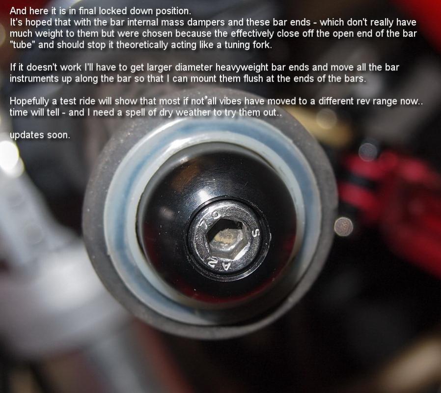

    The "theory" is that the silicone itself will have some vibration damping qualities and then the extra weight will shift the bar resonance to a different rev range - I'll fit them within the next 48 hours and go for a test ride and report back on either total or partial success or abject failure! stay tuned :)

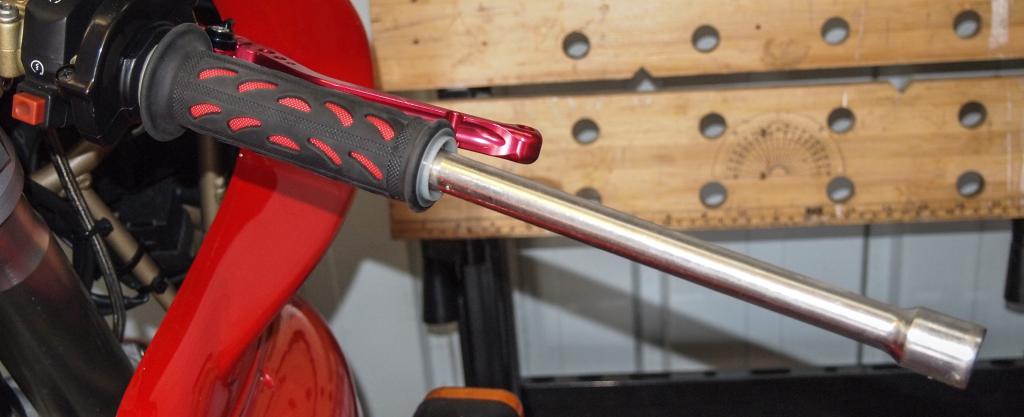

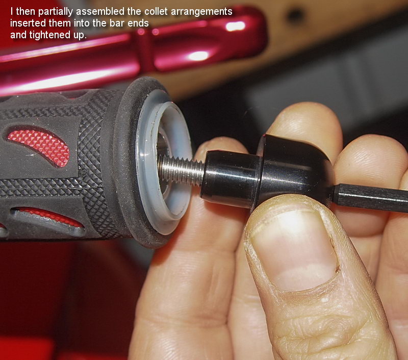

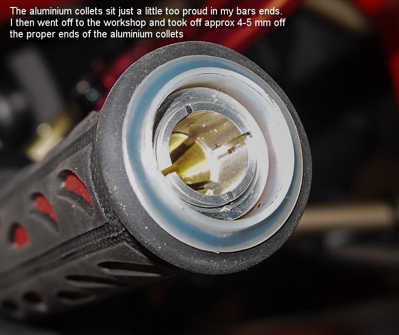

  5. OK - fitted them in the bars today...

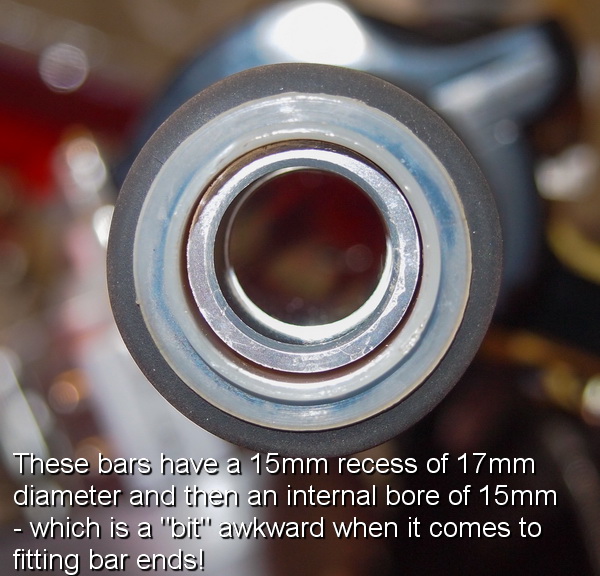

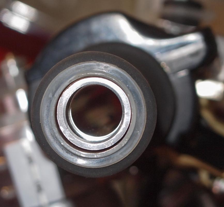

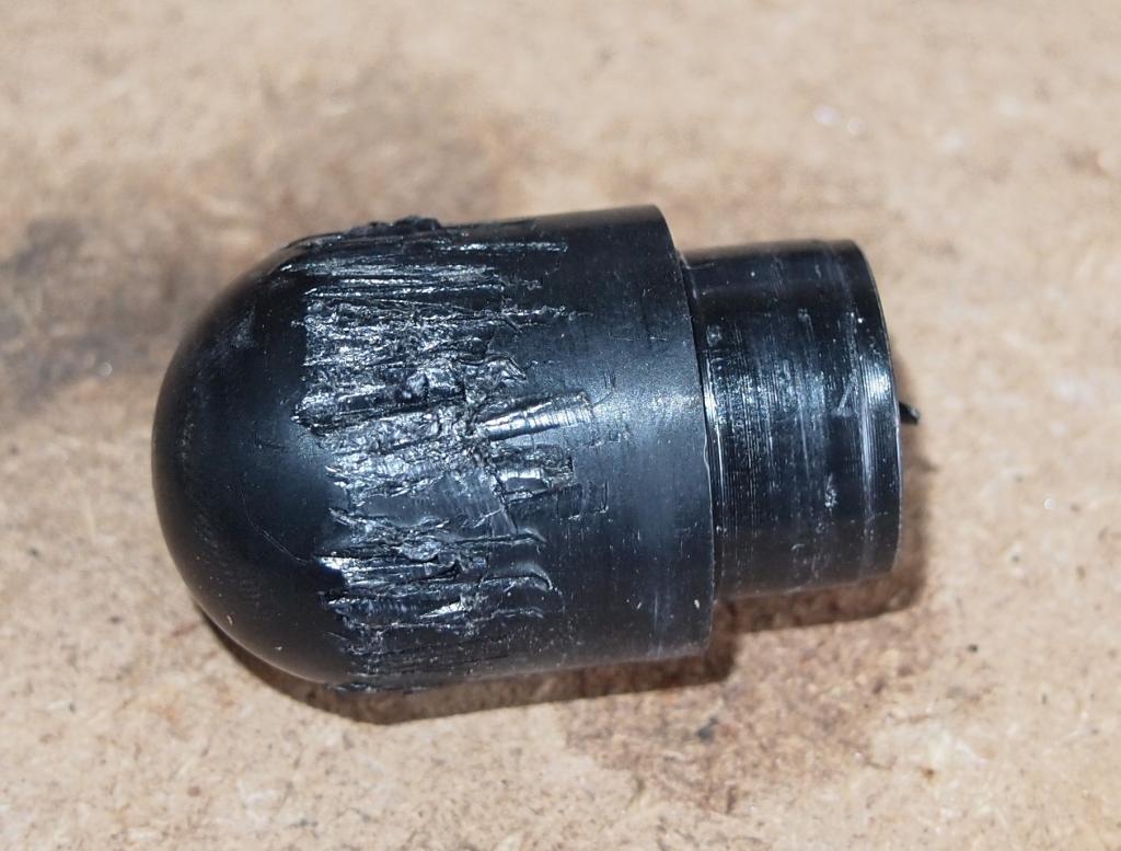

    The bar end plugs that come as standard are a pretty tight fit - no method I tried to get them out intact was working so it took a set of pipe grips and brute force to convince them to come out - luckily they're not needed anymore..
    The internal dimensions are 15 mm recess of 17mm diameter and then the rest of the bar's bore is a smidge under 15mm
    The "weights" are greased up for insertion! I used corrosion block grease FYI (kenneth williams style sniggers abound)
    and teased into position with a suitable bar of the right diameter - in this case a socket extension.

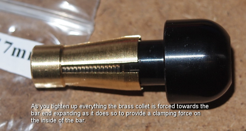

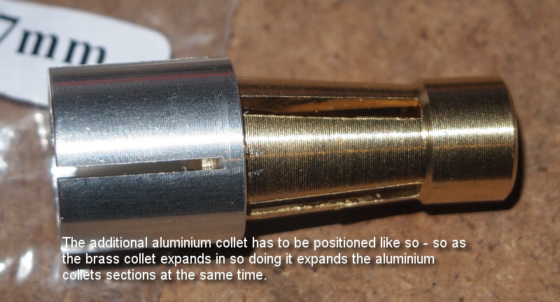

    and here they are in place ready for final adjustments soon. - I'm still waiting for the oberon bar ends to arrive - I've gone with the small 21.5 mm diameter anodised ones they manufature as the collet system they use will work fine with the weird dimensions of this bar. More soon....

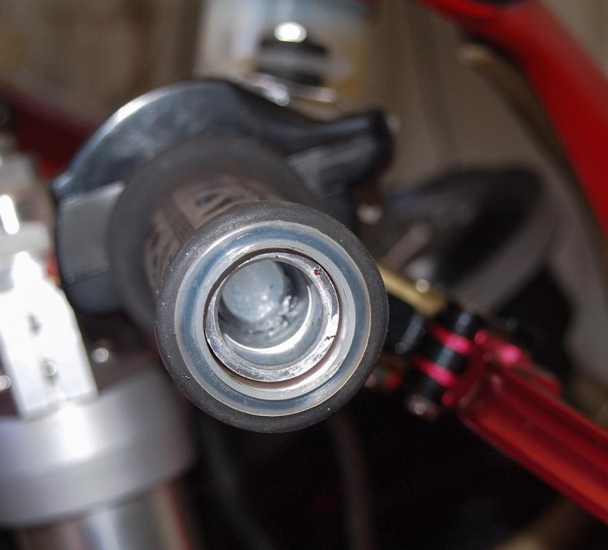

  6. latest developments....
