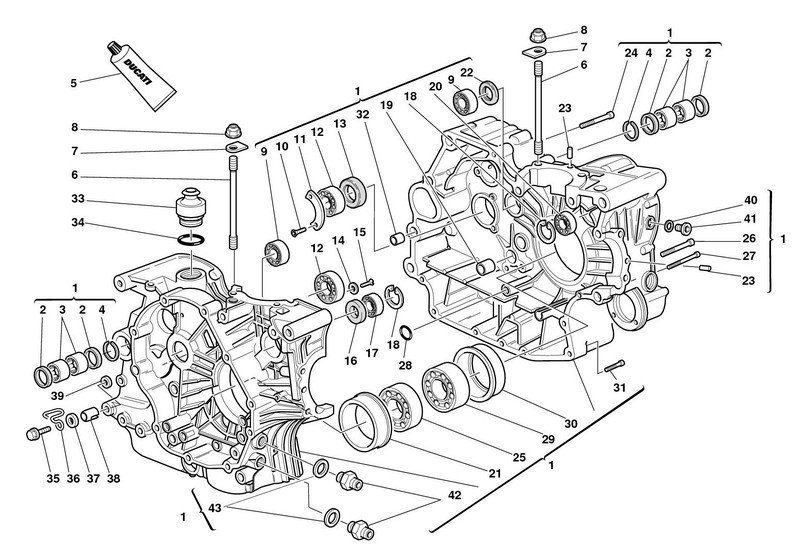

  4. the fuel tank breather guide is it number 36 on the below diagram by chance not sure cant find anything else at the moment 313031554410.jpg

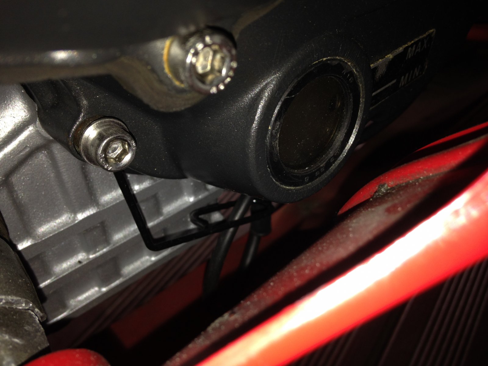

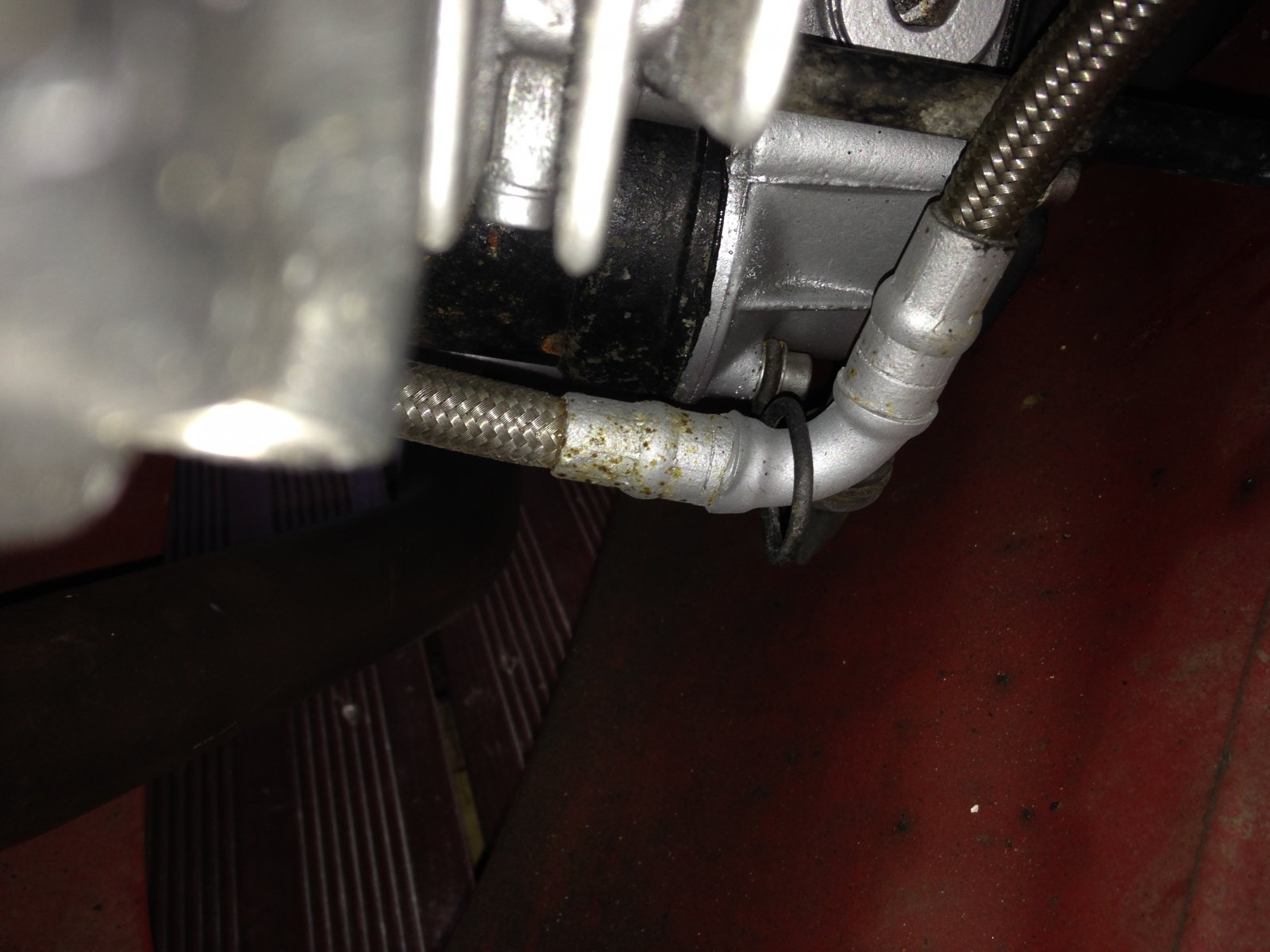

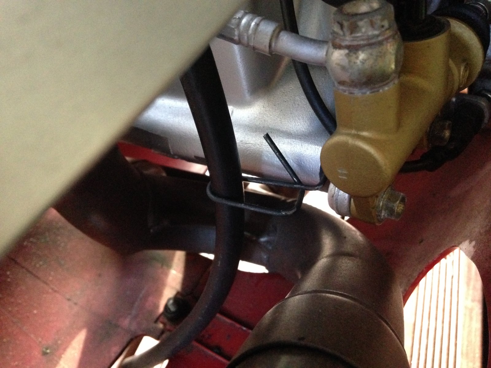

  10. Some photos here of the spring type cable way holders and a copy of the relevant page from parts schedule. Items 21 & 25.
