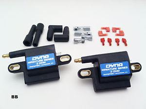

  1. Now the CA Cycleworks have stopped the Exactafit coils, what do people do?
    I think Dynatek coils can be made to fit, how?
    Jon
  2. I fitted some Dynatek DC3-2, Dynatek 8mm Suppression Plug Wire Set DW-800 and new OEM caps, no modification required, apart from changing out 2 terminal ends, which are supplied in the kit. Be sure to fit OEM plugs, as they are suppressed as well. Appears to be good quality.

  4. Cycleworks I think are 5 ohm and those Dyna ones 3 ohm.

  5. None?! I think its too small to have any real effect
  6. Aren't the 3 ohm ones supposed to run hotter? - need to be out in the airstream.
