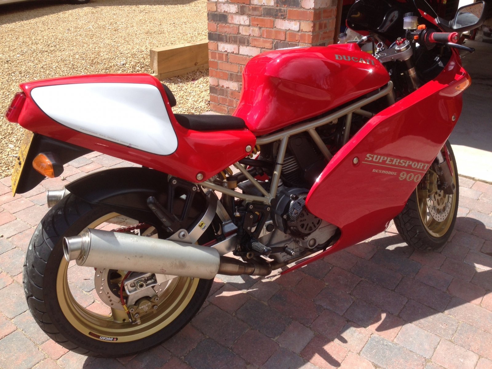

Hi Rob in Oz, thanks for sharing photo looks the same as mine but with reaction bar fitted ,however graphics on fairing are different ? Are they non standard or is mine not a 1996 model ? Can anyone confirm, here's a pic of mine.

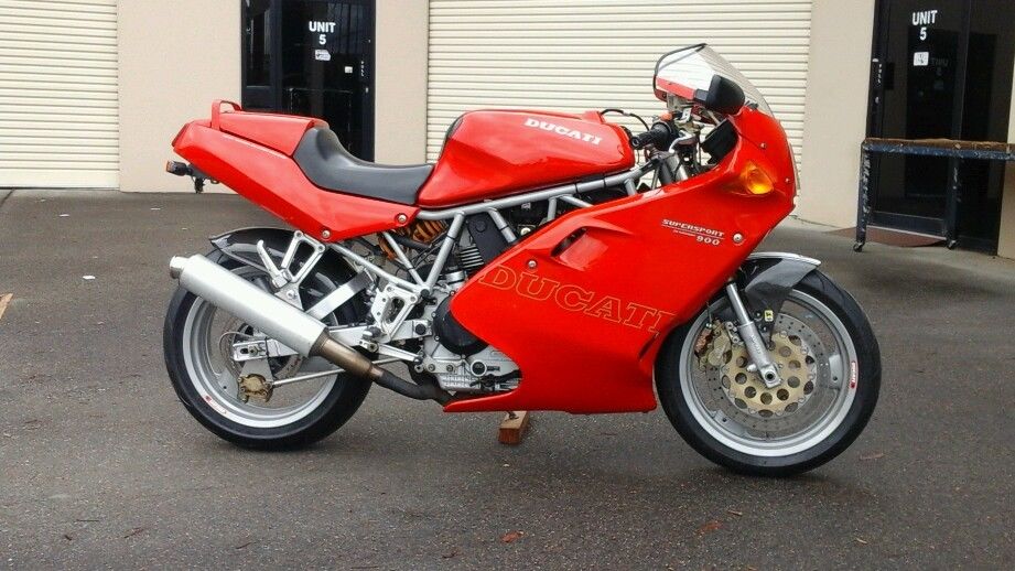

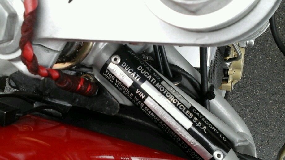

Hi Iguana Haven't had mine very long, but I believe the graphics are as per original. I not your fairing is different, not having the air scoops feeding the rear cylinder. To check on your year of manufacture, have a look at the VIN plate... Here's mine, although this is an Australian delivered bike, I'd assume your bike would have a similar plate in the same place:
Lucky me! We probably need all the cooling air we can get in an Aussie summer. Perhaps the reaction rod is also a later model feature?
Hi Rob, mine must be an early 96 model, I have found out there are 2 types of rear brake, mine has an anti-rotation peg in the caliper mounting bracket where yours uses the rod to stop rotation. Nice looking bike by the way !

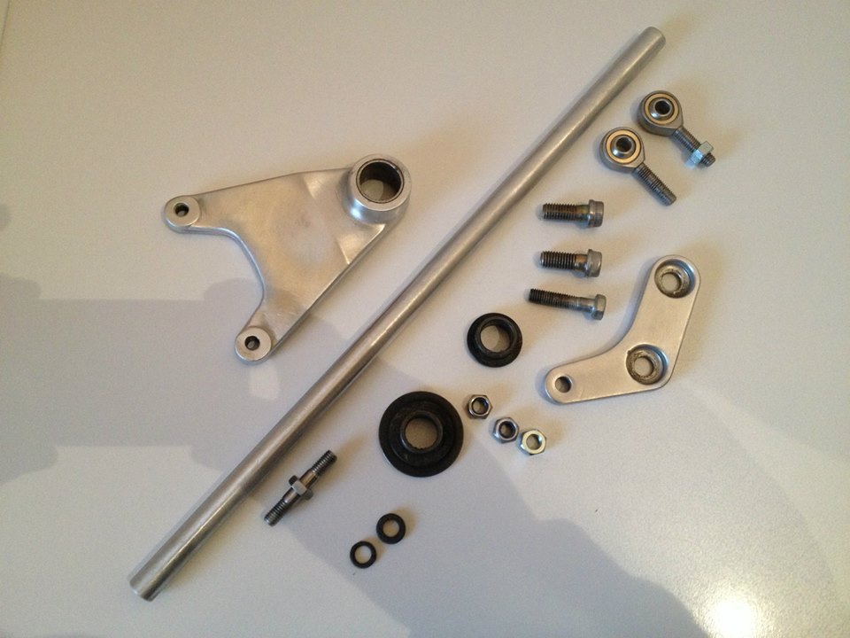

With a spare kit to measure as a pattern, I have no doubt a friendly engineer with a CNC laser cutter could knock out a complete new kit in aluminium for significantly less than the amount in the link above.
