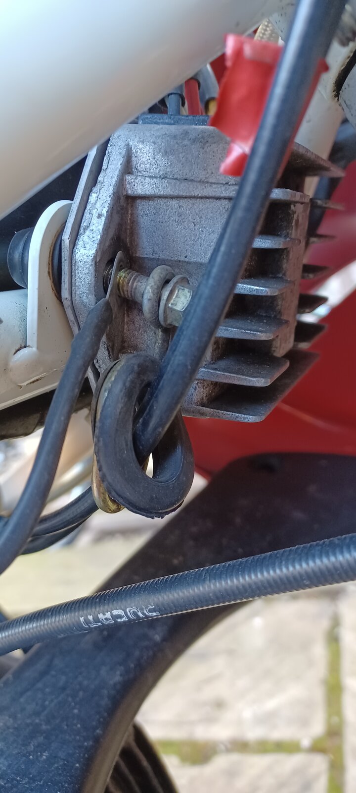

  5. Thanks, checked this morn and found this connection a bit loose and also with surface corrosion. Photo of it going back in after cleaning up the surface. Will try the output test again and see if that resolves. If not, then I'll replace with a spare trusty RR51.
  6. If your inclined to spend the time, I'd also check out the stator to regulator wiring, as the bad earth might have caused some issues and these can get crusty without any additional help.
  7. Thanks all. Cleaning up the above reg/rec earth seems to have solved the problem. Now holding 14v to 15v at 3k, and not dropping off. Will methodically check all other connections as suggested. The starter wiring is all good at least, replaced recently with 16mm marine grade leads!
