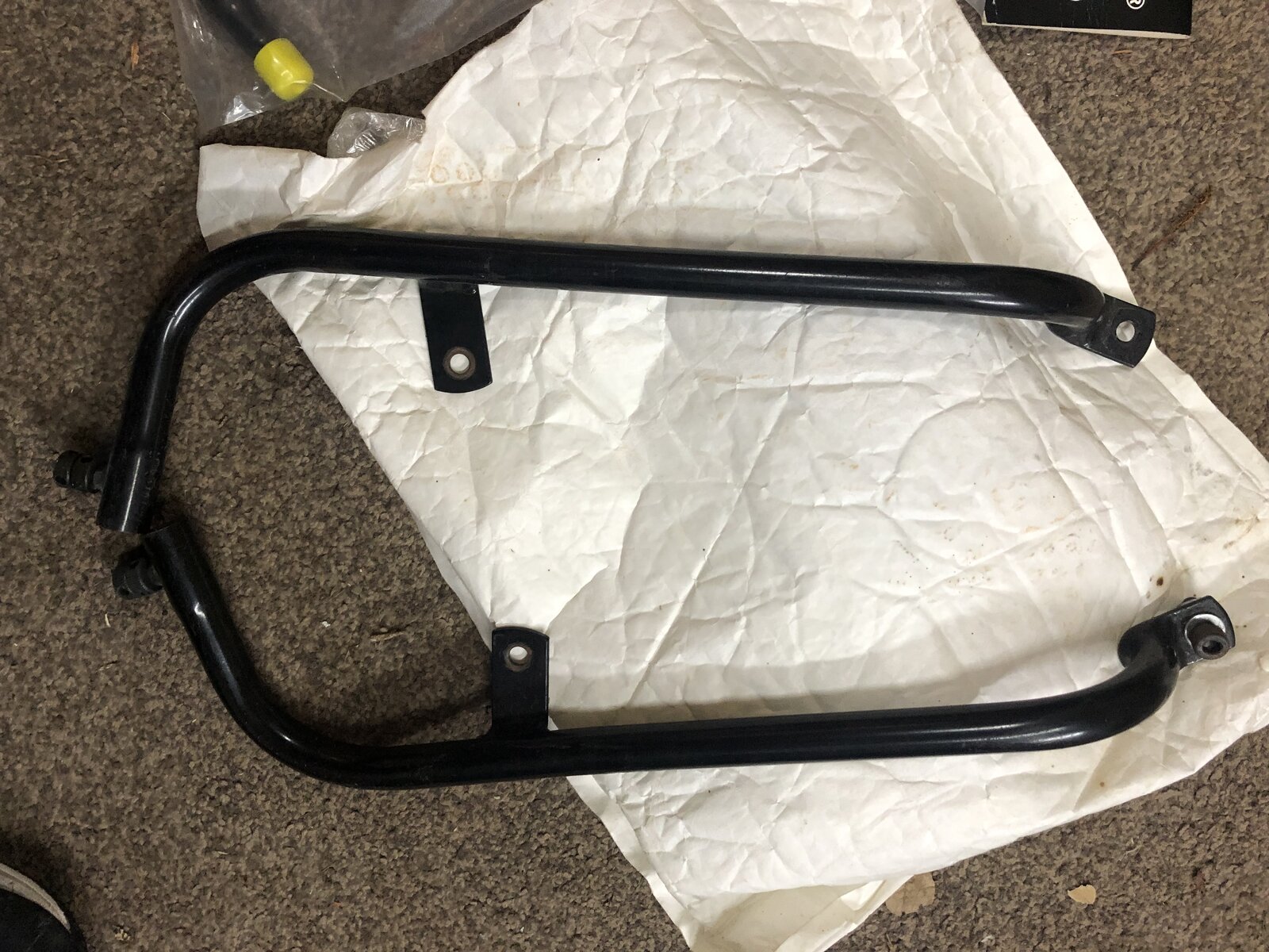

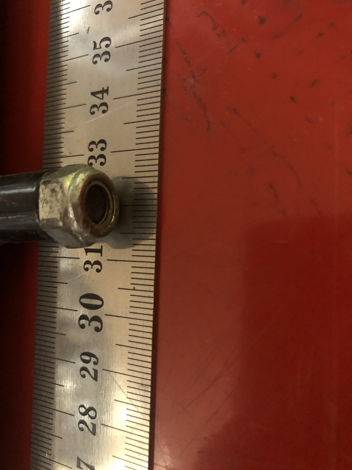

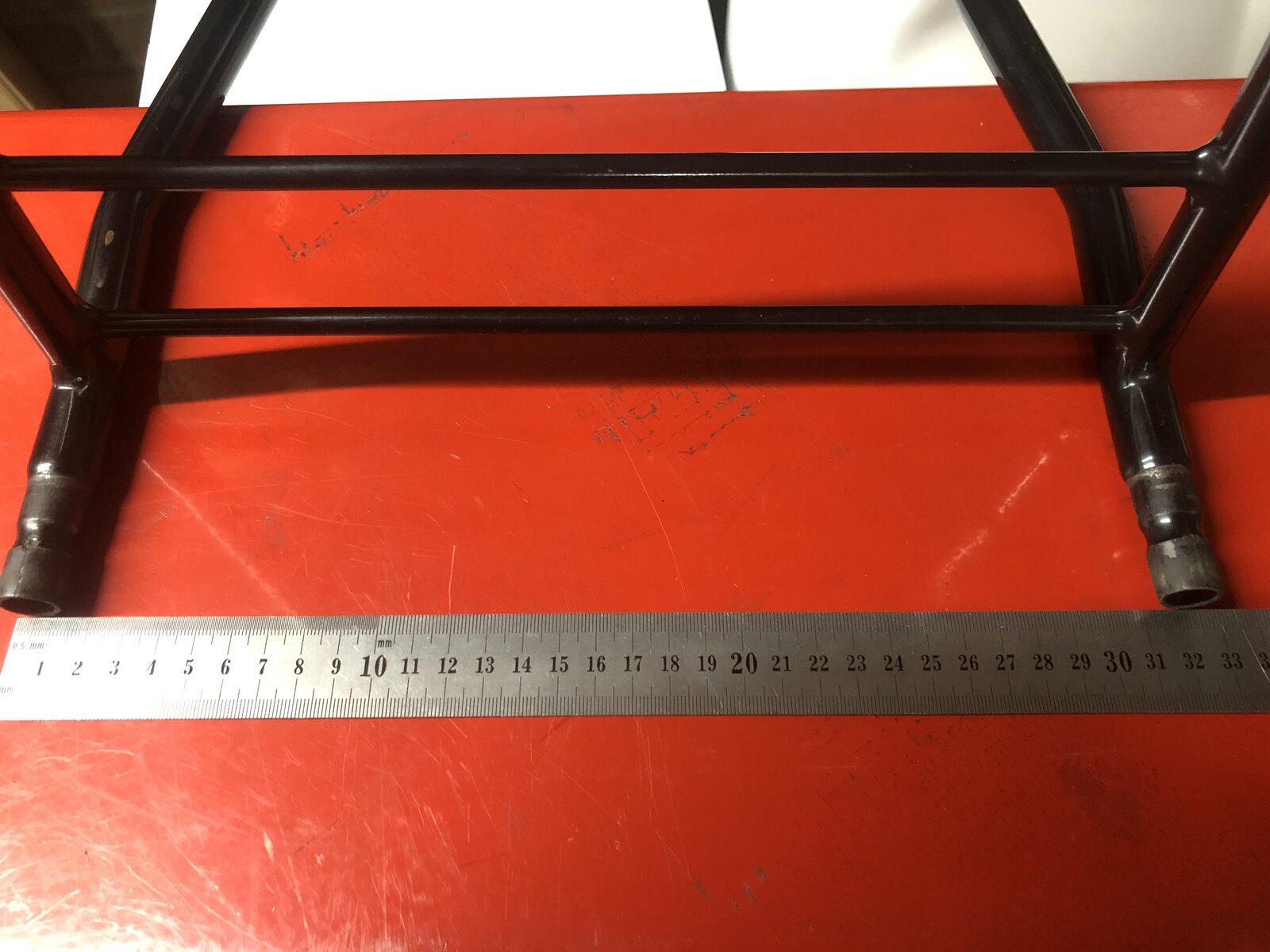

  1. If anyone has the above system, could you possibly give me the dimension of the pack rack, namely the inside and centre dimensions of the tubes that go into the "L" brackets. Also there seems to be a bracket that joins the 2 L brackets, a picture and dims would be useful. Basically I try to make one up from bits as full system is a bit expensive. Any help would be greatly appreciated.

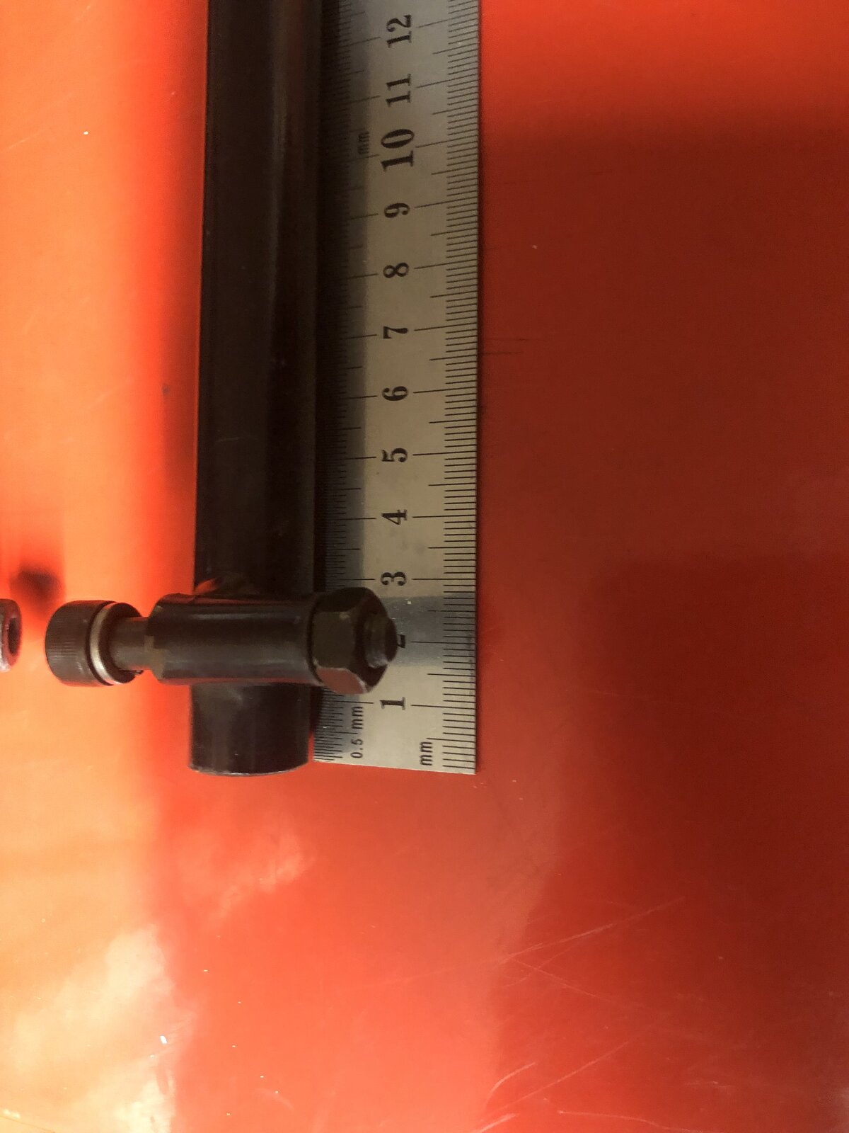

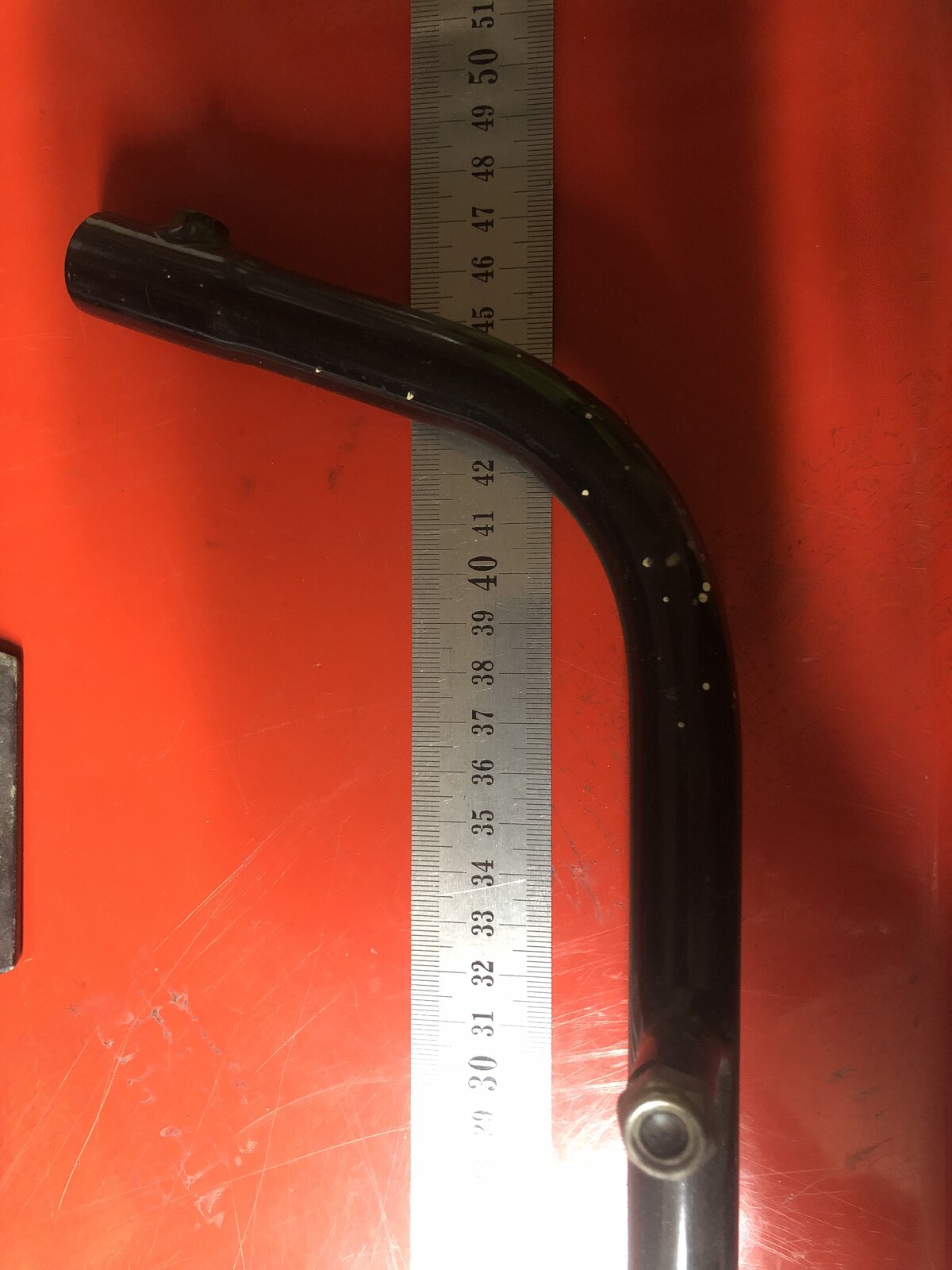

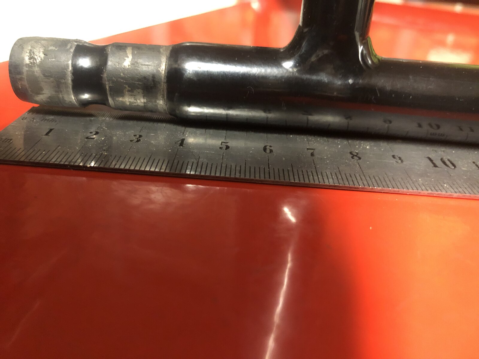

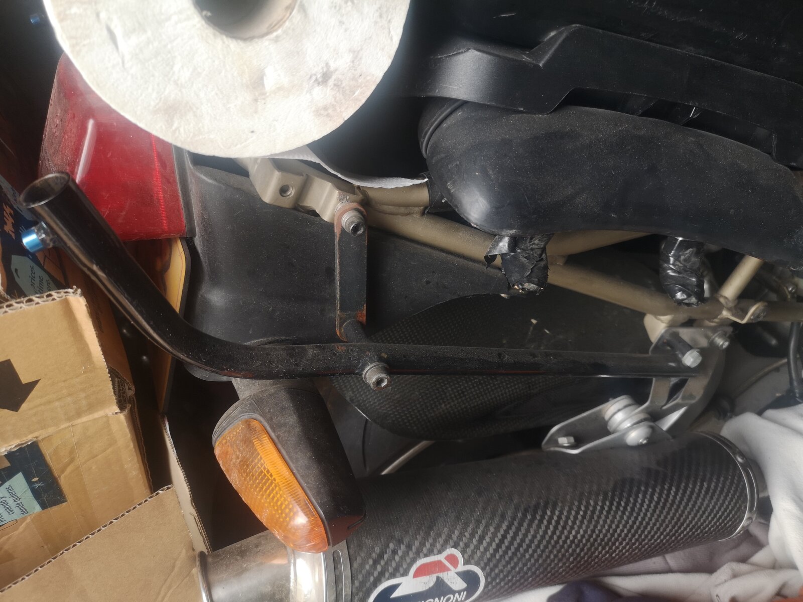

  4. Hi Gaz
    Took a few pics tonight.
    Its a toasty 12 degrees in the garage.
    Let me know if there are any other angles you need.

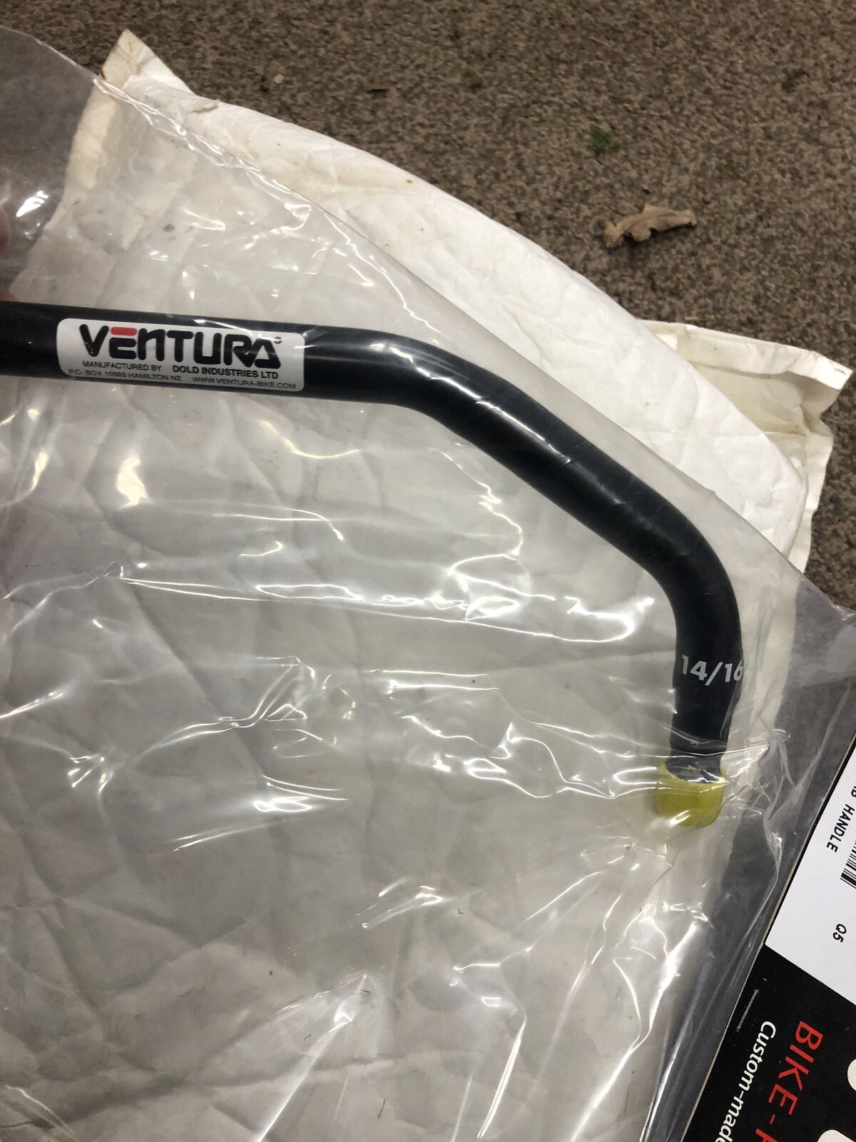

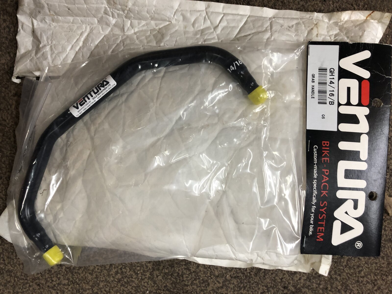

  5. 98 SPS,
    That's great. I bought a rack I think will fit, fingers crossed.
    Cheers Gaz

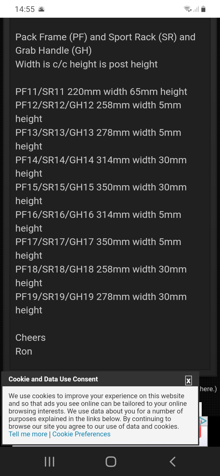

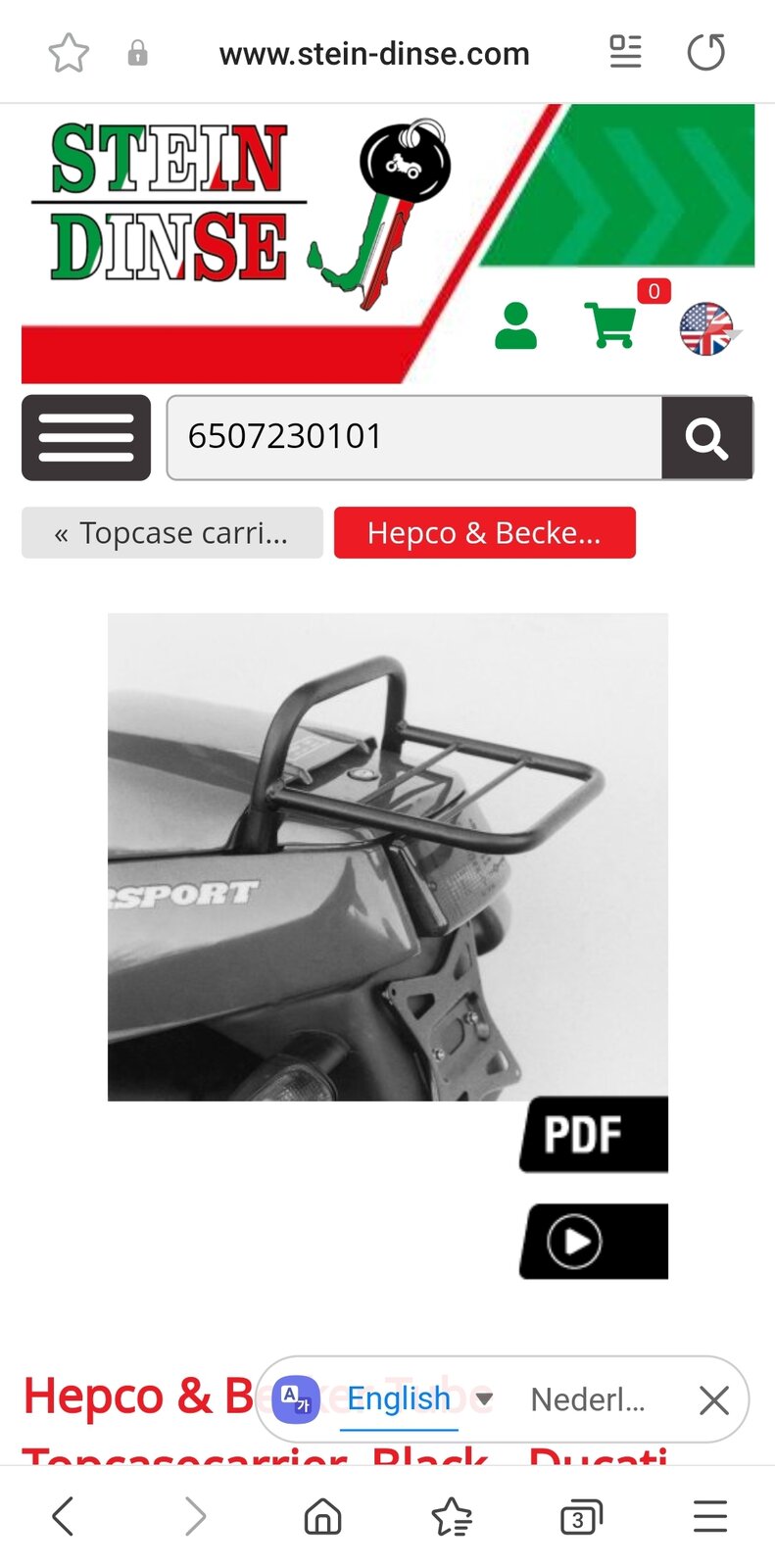

  7. I found this and believe centre distance should be 314mm.
    From the photo that looks about right if you could please confirm that, I can't quite work it out from angle of photo but there are no other dimensions that are close.
    Cheers Gaz
  8. I made it 323mm centres.
  9. Bugger. Ok thanks, will revist this next year.
    Cheers Gaz.
  10. An other option.
  11. I’d like one but not at E358.00 a shot.
  12. Hi Gaz
    I knew i had a few parts in the shed and was in there today, is it the cross joining section your after? side brackets you have ? or none of what I have,

  14. Roadtrip cheers,
    There was a single L bracket for sale on ebay which I bought (Ref D009) to use as a templet. Your L bracket don't look the same. I am also after pictures of any cross brackets or any other brackets that support the L brackets.
    Cheers Gaz

    Remembered, my L brackets are what i bought for my 748,
  17. Hi Gaz, this is what I have on my SL/SS.
    The vertical piece I made, and I do think I had to adjust the bend of the "L piece" so the rack cleared the mono seat when facing forward.
  18. Royal,
    That looks like what I am working towards, albeit with different L brackets thanks for photo. I need to do a vertical bracket that will let me put the standard ducati grab rail back on. I do have a spare in case I need to slightly modify it. Thanks again.
    Cheers Gaz
