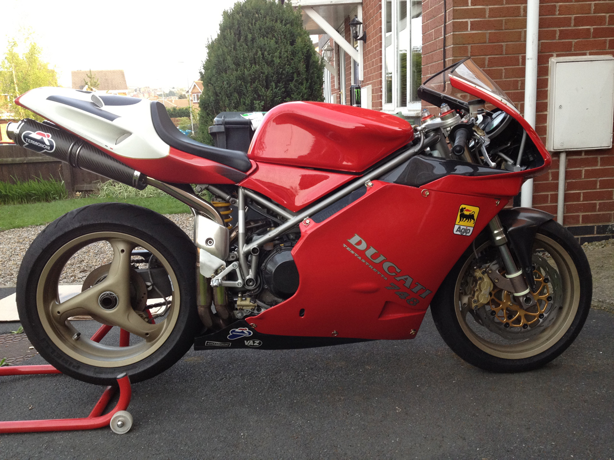

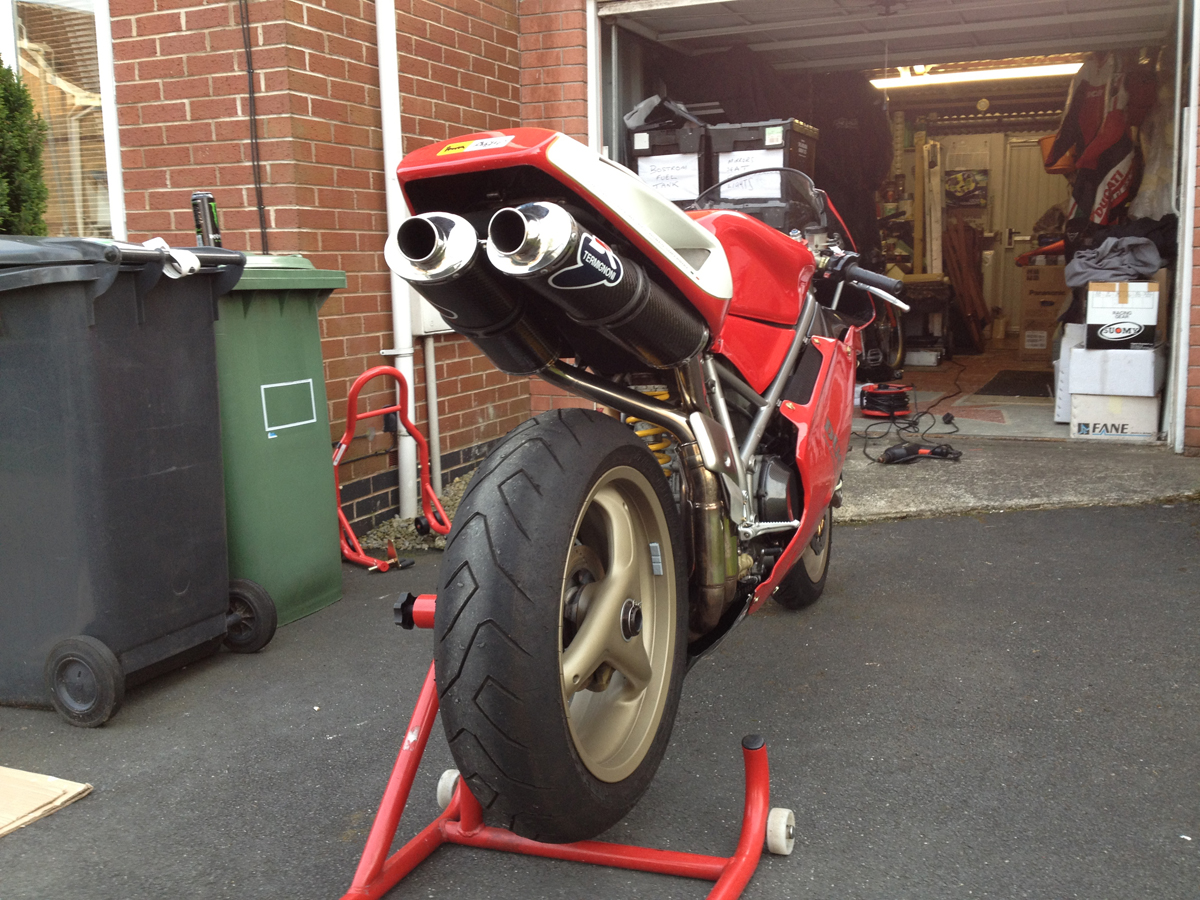

  13. These are them, let me know if interested :)

  16. Is that a track bike? Where are your rear lights?
