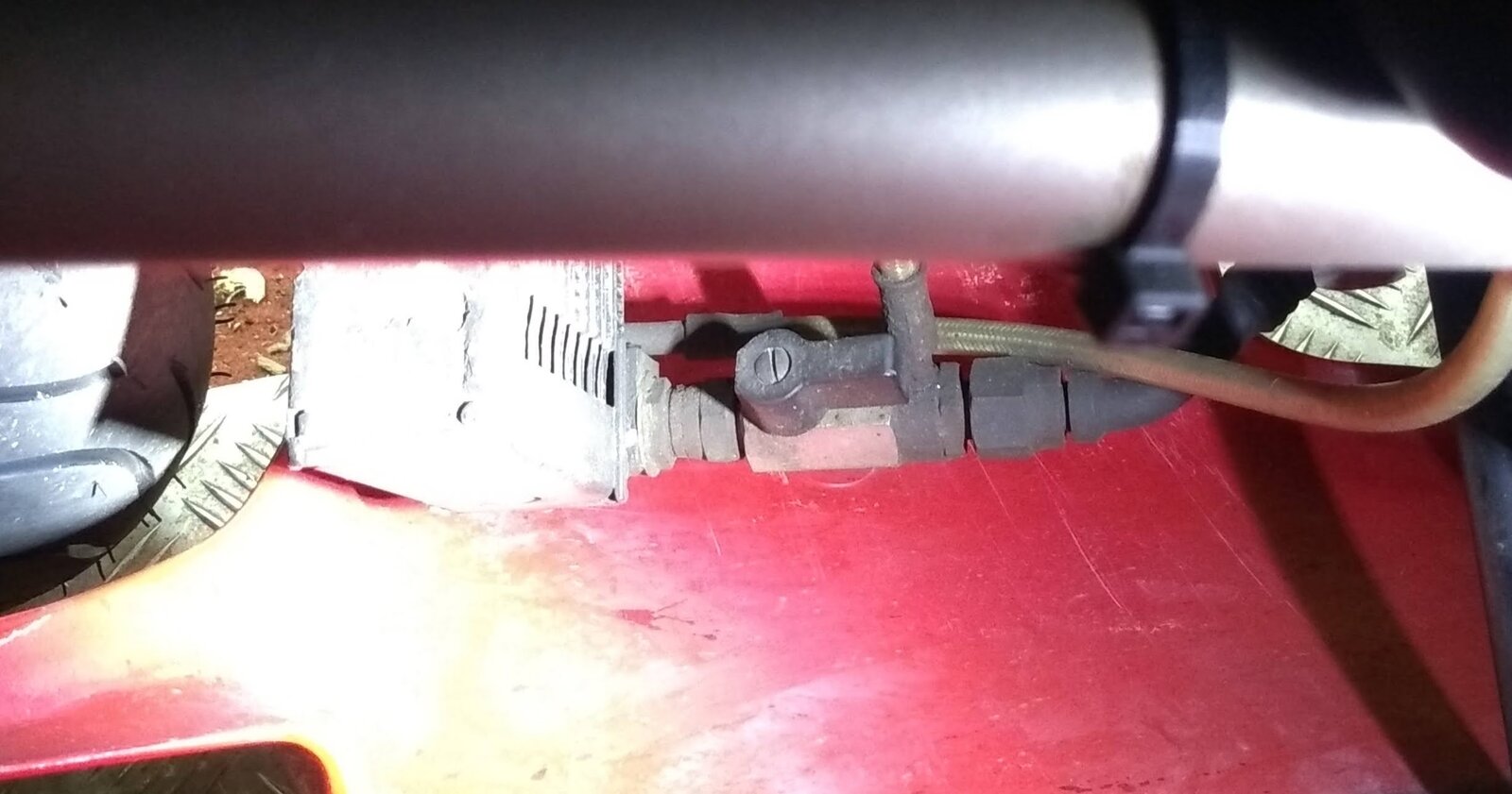

    There are carb bowl warmers on the bike - there is a valve in line that looks to my understanding to be straight through so the warmers aren't in use..
    The haynes manual refers to them but there is no description or guidance on on/off. And reading up some people seem to think the float chamber warmers work and others say they don't...

    I have the pipe from original carbs and could clarify later if no one else does which way operates the heaters.

  5. The carbs don't really warm up in those circumstances, as they're being fed cold, moist air and cold fuel too. Whether it happens or not is down to the dew point at the time. What happens when you stop the engine is it 'recovers' as some engine heat is conducted to the carbs to warm them up, dispelling the moisture (ice). I have no knowledge of additives mentioned above - I'd connect the oil lines if possible...

    but do not see that they would be very effective as they heat the float bowls i believe when it is the incoming air charge that is the issue as pointed out the moisture content at lower ambient air temps is higher therefore warming the inlet of air would be more effective .....but when engine gets to running temp warm air is not the best as cooler dense air is more combustible
