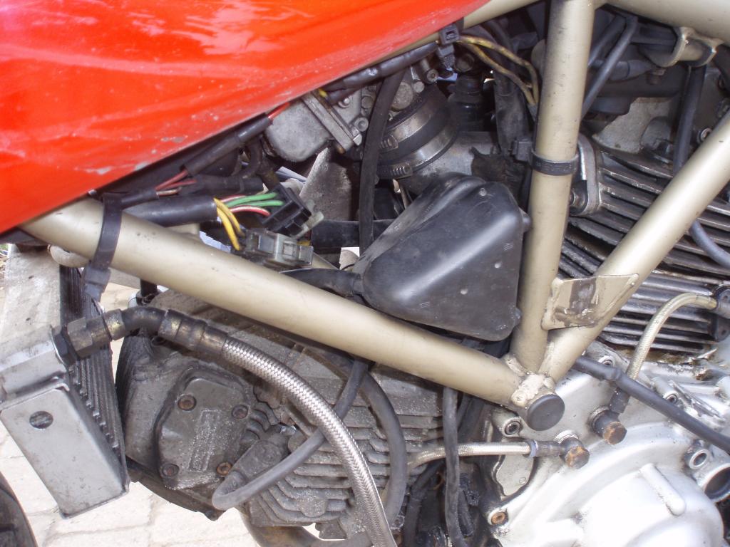

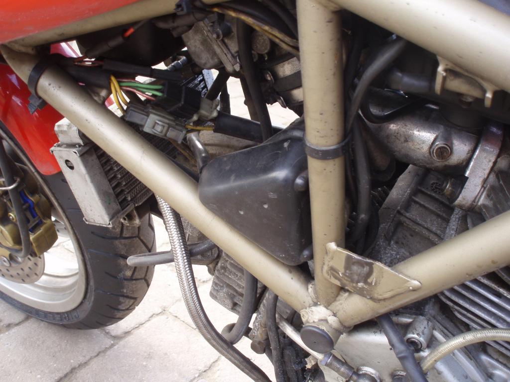

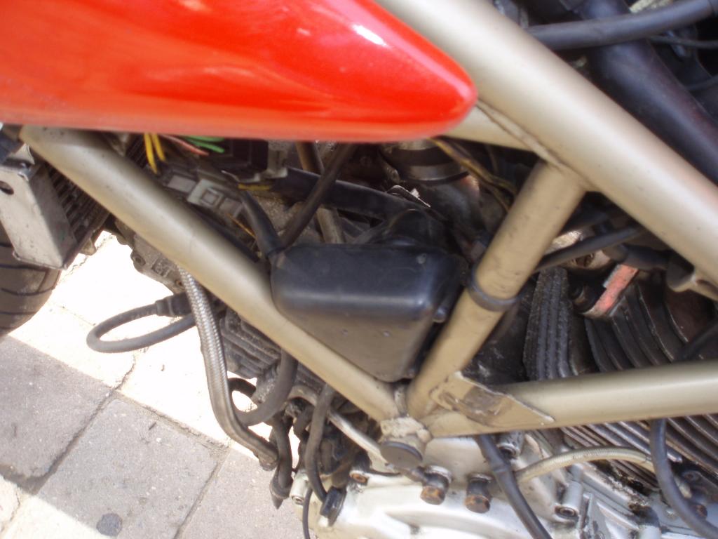

  1. hoping someone out there can help me here.....been slowly rebuilding a 97 900ss for the last 3 years (well I didn't want to rush it) and unfortunately the lack of pictures I took when I dismantled it now corresponds exactly to my failing memory.[​IMG]
    I'm soooo close to getting it finished but I just can't recall where the (I think) fuel vent system and pipework goes. I have a selection of pipes and two triangular shaped plastic bits.
    Hoping someone with a similar model wouldn't mind lifting up their tank and posting a picture of what lies beneath please? Its where the parts go on and around the frame I'm interested in, not so much the underside of the tank - ta [​IMG]
    Oh, one more question while I'm on a roll....where does the other end of the engine earth bonding lead go to on the frame please?
    Many thanks in advance
    Steve
  2. earth wire terminates to rear of right hand footpeg forward mount bolt.
    looking for a breather picture will update soonest
    not the best but may help
    #2 WAH900ss, Feb 23, 2013
  3. Doe this help - let me known if you need any more info. The outer pod is connected to the carb overflow, while the two tubes on the inner podule pipe into the airbox drains pod1.jpg pod2.jpg pods3.jpg
  4. gents, both are a great help - many thanks!!
    Steve
