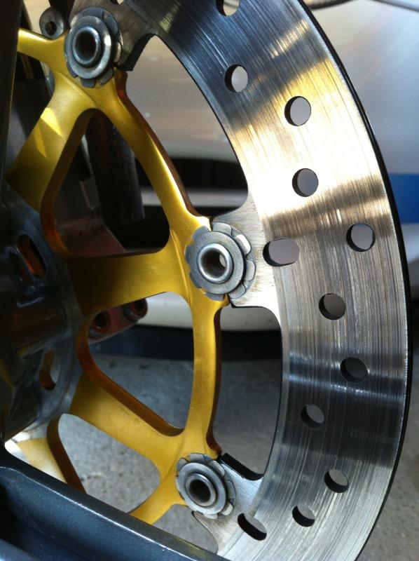

  12. amazing forums can actually produce the odd snippet of info now and then and not just the usual banal banter we all love....LOL....heres a pic of the rear of a 996R full floating disc showing the star shaped clip holding the bobbins in place go an give your discs a wiggle you should feel it move very slightly (floating) if it doesn't move at all its the fixed item BTW the fully floating and fixed item at first glance look the same but look at the rear of the disc and you won't see the star shaped clip......all BSB, WSBK & MotoGP bikes have fully floating discs the latter will be carbon items
