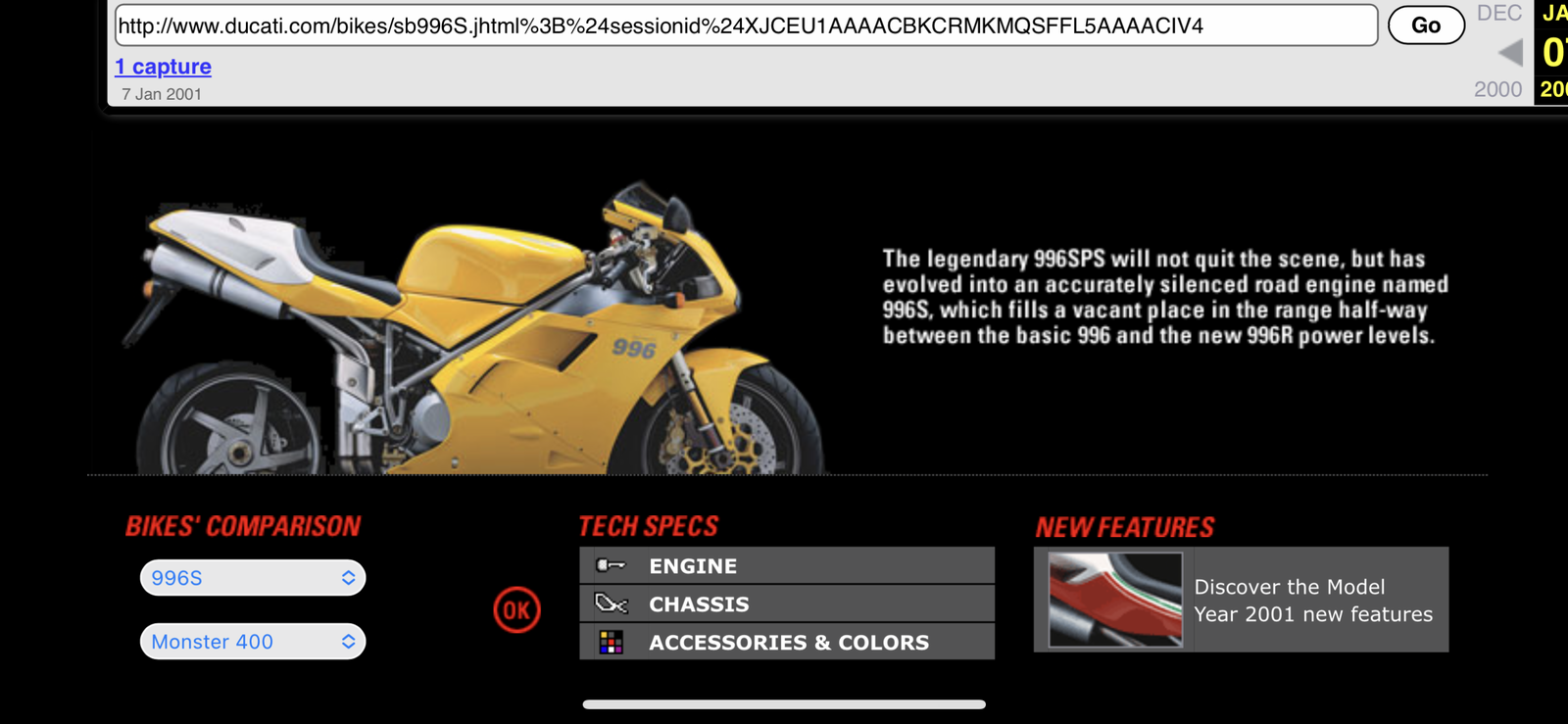

  4. Was nerding out on the subject after looking at the 2001 archive of the Ducati website today (see attached), which makes the 996S seem to be a rebadged 996SPS. Not quite the case, here’s the differences as far as I can tell:
    SPS has:
    Numbered plaque on yolk
    Some Titanium Engine internals (see below)
    Different ECU: P8 vs 16M
    Shorter gearing (Close ratio box)
    Monoposto rear subframe (enables larger P8 ECU)
    Carbon fibre Airbox
    But otherwise the bikes have the same:
    Power (owing to the T1 cams)
    Suspension (Ohlins/Ti-coated Showa combo)
    50mm Termi exhaust system
    5 spoke Magnesium wheels
    Two points of debate/inconsistency:
    Ti conrods also appear to be in *some* S models (at random)
    Not all SPS engine cases are the unpainted sand castings.
    Any other corrections please do add!
