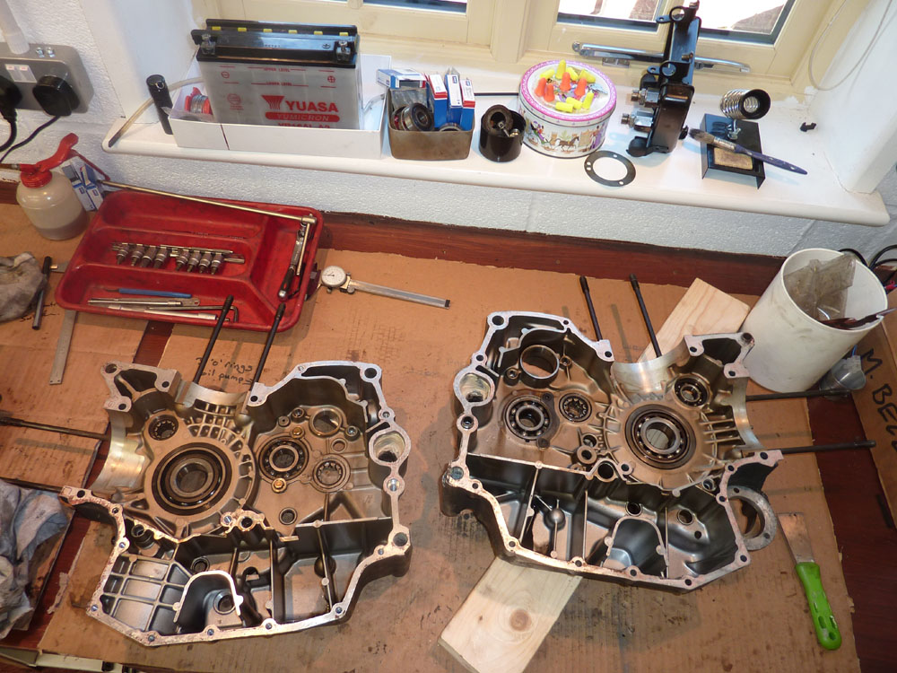

Currently in the middle of a full rebuild of the Monster engine, not actually removed the bearings yet but am at the point of being able to. Bit of a job splitting the engine, you'll need some special tools and inevitably some other parts whilst you're in there but as long as you've got time, patience and a clean (preferably warm) place to work then it's not too bad (so far). Here's where I am at the moment;

Get a cover from ebay or a breaker for much less than £500 (I have a used ST2 LH cover I'd sell cheap but I don't think it'll fit a 996?) then even with tools/parts etc the bill would be considerably less than £2k - it's the labour that's the killer, you're paying for a full engine rebuild time-wise which is probably based on a couple of days (16hrs +) labour, especially if you deliver the bike rather than the engine to them. I've yet to find out what the cost of bearings/seals etc is but I'm guessing around £500ish.

ST4 was 916cc so may still have the 916 single-phase alternator? ST4S was 996cc so should be good? As for bearing preload, I'm hoping it will be a straight swap but as I've not done it before I'm still finding out, I had considered taking it to a specialist but want to build it myself. But I'm not in a rush so don't need it fixing quickly which is a good thing because I've messing with this bike for 2 years now! (although only split the engine today) but I would like it on the road for next summer so am now planning to pull my finger out.

The bearing preload is critical to it all being worth while. It's impossible to assume that simply replacing the bearings will be correct. Measure everything and be 100% you have the right figures. If in doubt, measure again. Ultimately, it's how the crank feels when the cases are closed up. Get this right and it'll be better than new. Get it wrong and if loaded too much, it'll fail again and quite quickly. I built a motor this year that had been done 800 miles prior.......and that was in the trade. the rest of the engine is pretty straight forward. If you have any doubts, get it to a decent workshop. Not sure where you are, but I'm happy to help out. Done several now for ppl doing their own rebuilds and for the sake of a couple of hours labour, you could save having to do it again...
Good info from Nelly, further to which (and my visit today) I'll be getting him to do this job. Best leave some jobs to the experts and this is too important to risk me cocking it up I think. I really only want to do it the once.
