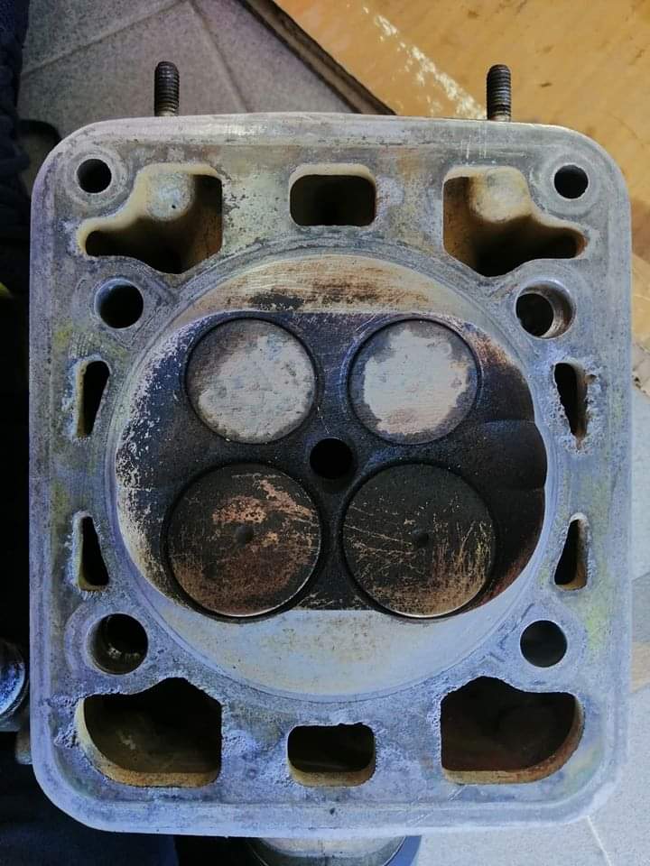

  12. 1541133748865.jpg So yes the gasket was fried, along with a small mark on the head. Getting it welded, machined and a new gasket fitted. Will be back on the road in 2 weeks. Getting new belts done at the same time.

  13. id sort those valves and valve seats out to while the heads are off.
  14. Id also have the other head off ... sods law saying will be back on the road and the other one will go. Also the faulty head will have a different compression ratio if its being skimmed ... and yes get all the valves done and lapped back into the seats and don't forget new valve stem seals ... one last thing make sure the correct amount of Antifreeze goes back in :upyeah:

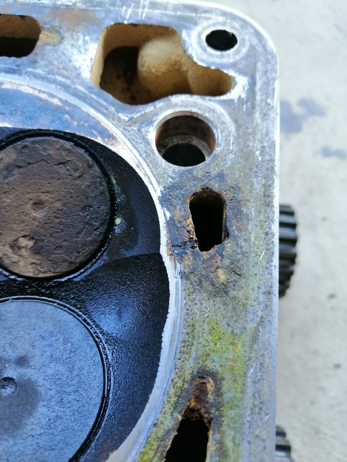

  19. received_259901334721049.jpeg So here's the corroded head. In all fairness, it's not as bad as I thought it was going to be. Its far from perfect but should have a few years left in this head yet. New gaskets and sealant should do the trick. What are your thoughts guys? Replacing the heads is pretty expensive for me really.
