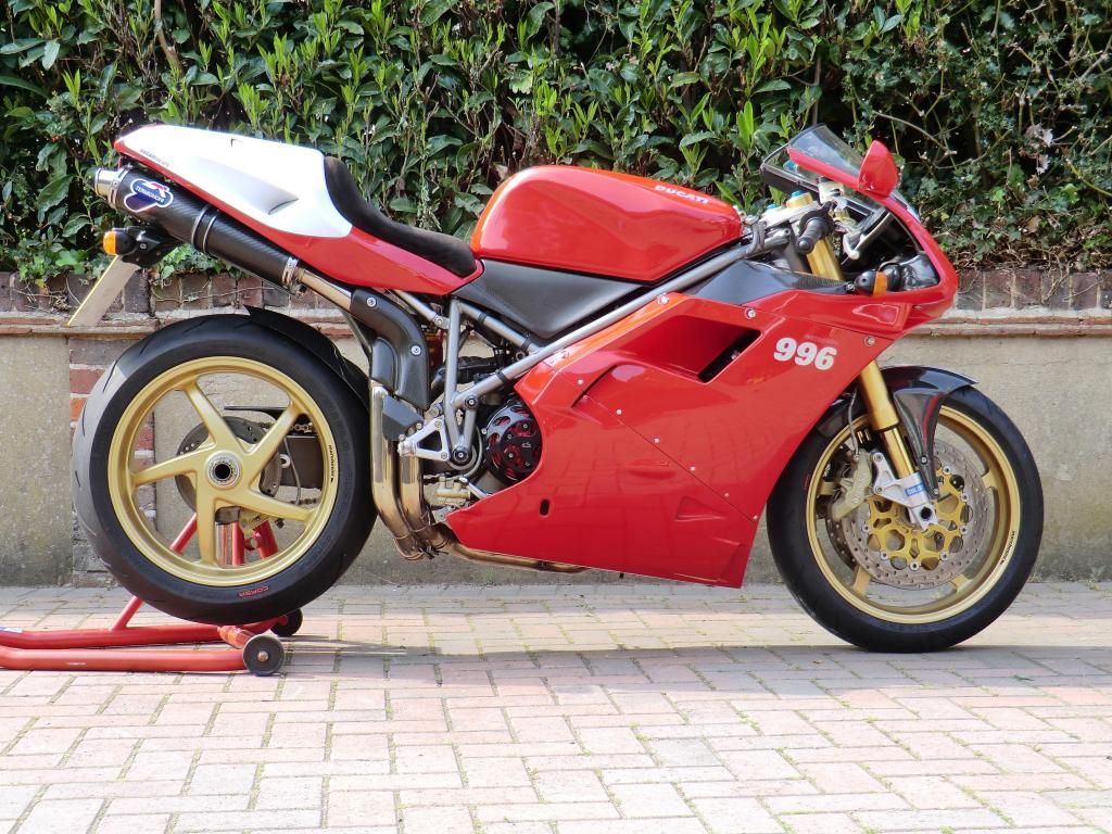

  7. Thanks guys for the responses I will keep those checks in mind when I go to have another look at it. I am sure it's legit as its from a dealer, i can't see them knowingly selling a dodgy bike. It is apparently a late model 2000 one of the last in the line to get the Ohlins forks, it's had a few mods already and I wont be adding much to it. I was just wondering if there is a "must do" mod that everyone does, generally most bikes has one or two of these.
    I am not too worried about the millage now, I have just heard horror stories about even the engine on this era Duc being a consumable part and paning for gold during oil changes. less then 2k miles a year is hardly a hard life on the road, and its a 1 owner machine to which is probably a big bonus.

  20. It has the later 999 P4 calipers which are a good upgrade. Also the earlier floating disc which should add to the rattling of the clutch :)
