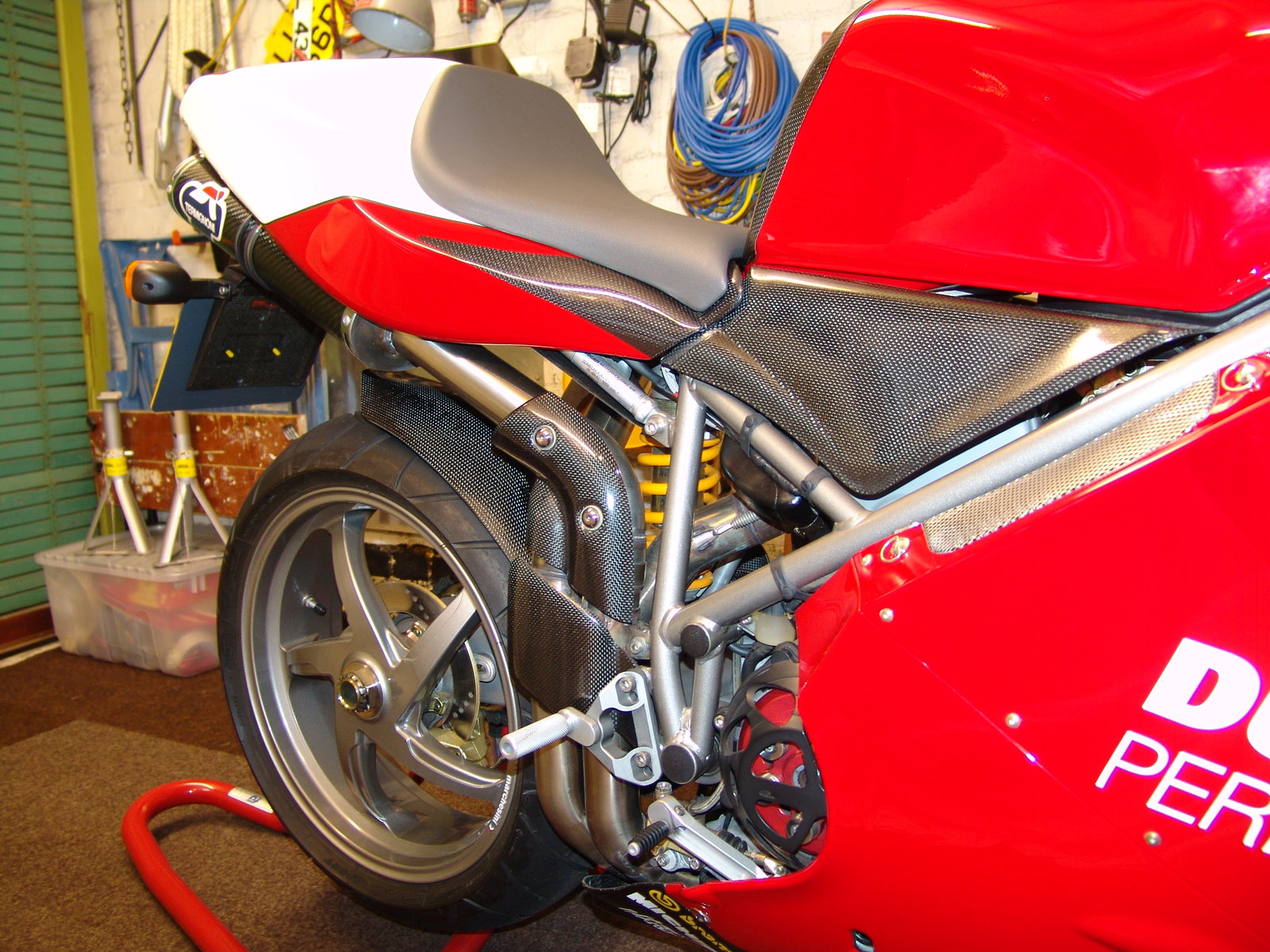

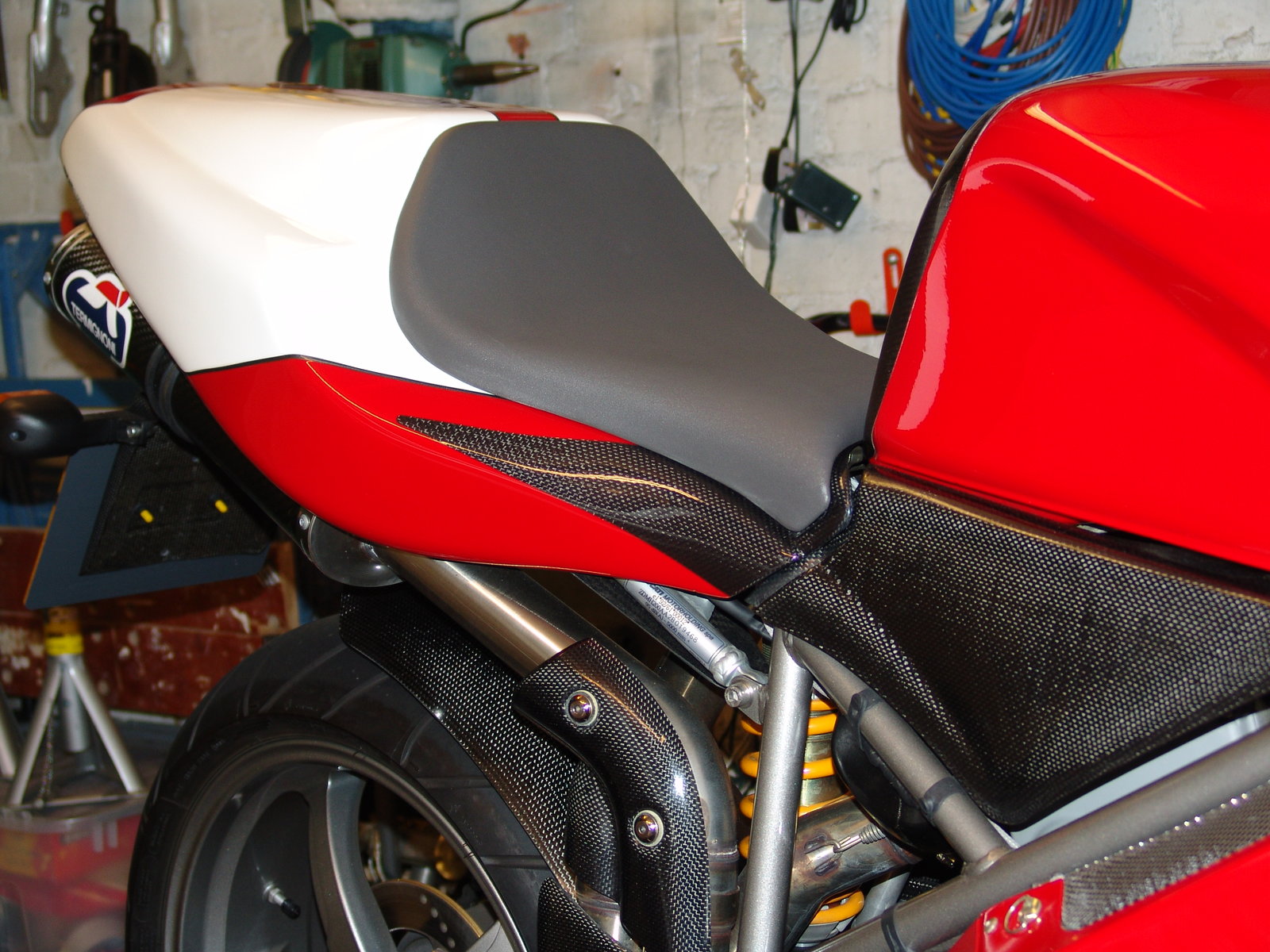

  5. I have a 996R airbox fitted on my 998s and also a 998R C/F seat unit, they complement each other perfectly.

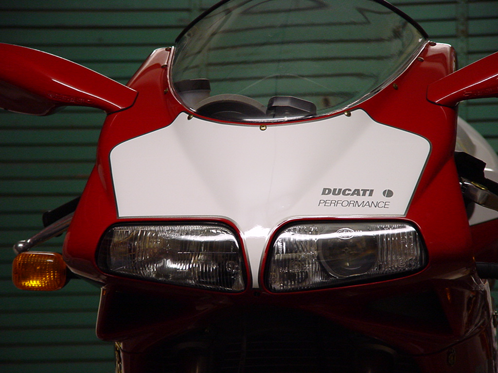

  7. Definitely a plastic nose cone for some odd Italian reason!

  12. I’ll never sell it mate. Bought all the carbon body panels together. All logos hand painted on, no stickers apart from the tank which will be sorted soon.

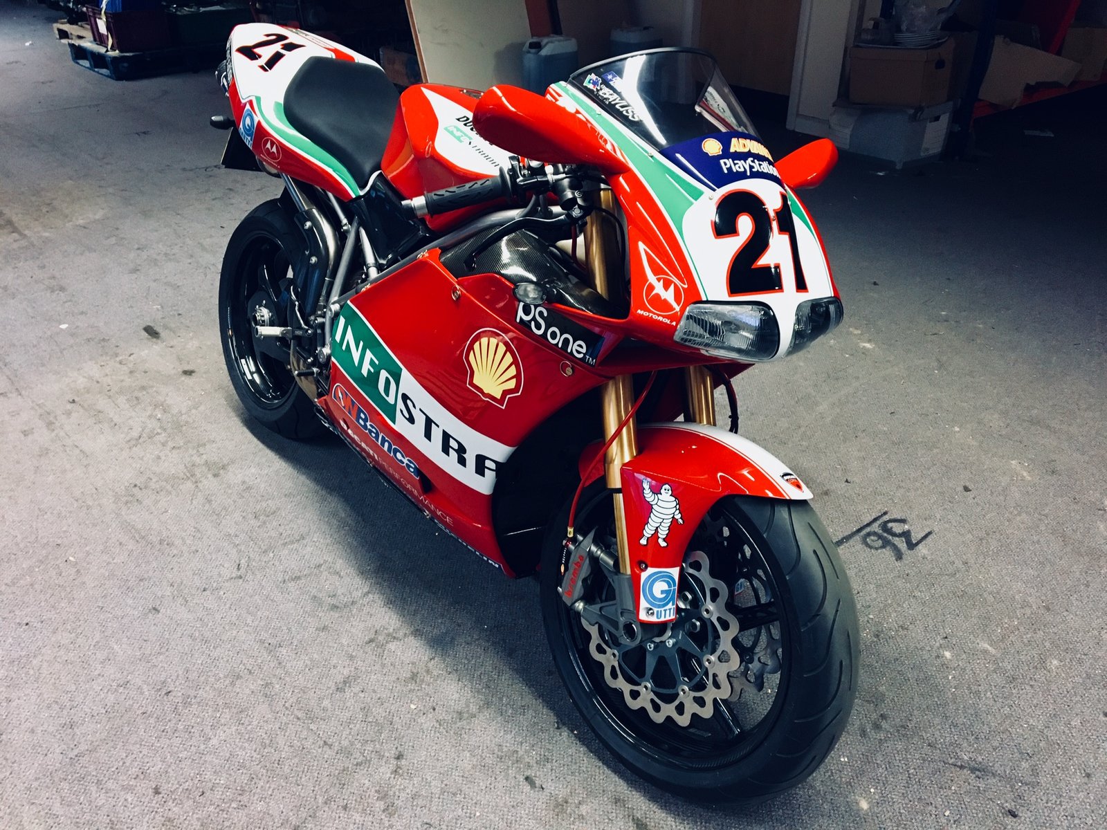

  13. I'll send you some photos when it's back from the paintshop!
  14. That’s a beautiful bike! Looks amazing, hoping mine turns out close to that well when I get finished.
