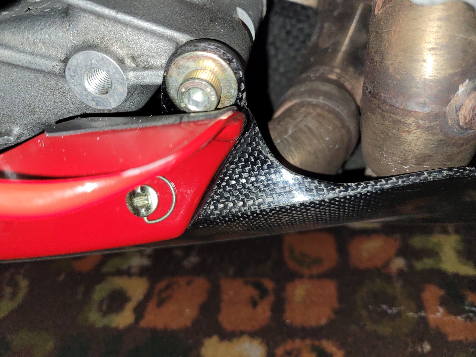

  8. This is how the belly pan is fixed on my 998S . I'm about to leave for work so haven’t got time to remove side fairing to unscrew bolt to check size, but I can later if you like. 14F4617E-3D09-4AF4-B7BF-F1099B061811.jpeg
  9. Thanks for posting the photo - the CF Belly Pan fixing tab looks the same as mine but I had no screw fitted. However, I now understand what has happened (I think). Just inside the crankcase hole facing there is what appears to be a short length of very thin wall copper tube - I assume this was some sort of codge by a previous owner because behind this tube floating loosely around inside the casting was the previously mentioned threaded insert - I just pushed this out through the opposite side of the crankcase with a small magnet. The insert is threaded M6 and I guess was originally a press fit in the crankcase hole. I assume it had got displaced at some time in the past and was just left inside the casting. I can't easily re-fit this insert so, for now as least, I plan on installing a long length of M6 allthread bar and clamp up with a nut at both ends (so another codge then!). Thanks again for everyone's help.

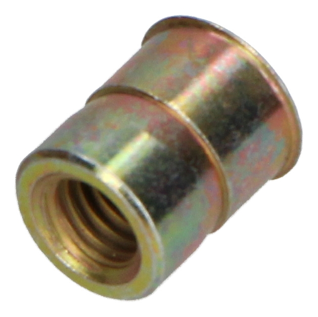

  10. I bought the threaded insert, however, it is a very tight fit that I don't think it will go in properly if I just try to hammer it in. Do any of you have ideas on how Ducati press fit this threaded insert into the crankcase hole?
    Because if they use press, the upper wall of the threaded insert might collapse since it is only made of thin zinc plated steel material. Even the lower part where it has the M6 thread is already larger than the hole in the crankshaft, let alone the upper part which is even wider but also has thinner wall.
    Here is how it looks like (I took the picture from Stein Dinse website):
  11. My guess is it is inserted using a bolt threaded into the insert. Then lightly drifted in. If it starts to mar/jam then I’d remove and do some light relieving of the insert surface . Putting the insert in the freezer before hand may help.

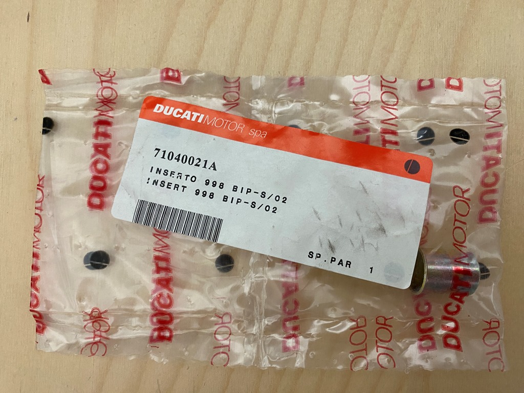

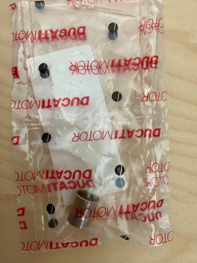

  14. These are the pictures of the insert that I bought:
    They are Part#71040021A and looks like the original picture I copy from Stein-Dinse website.
    My engine is actually a Deep Sump engine from 2005 999S but I am pretty sure all 998 and 999 deep sump engine had the same size holes. I think Ducati must have pressed them with a machine press. It need to be tight otherwise, the insert will spin when tightening the M6 bolt. I might try the screw the bolt into the insert and tapping them with rubber mallet and see if I am able to force it in.
