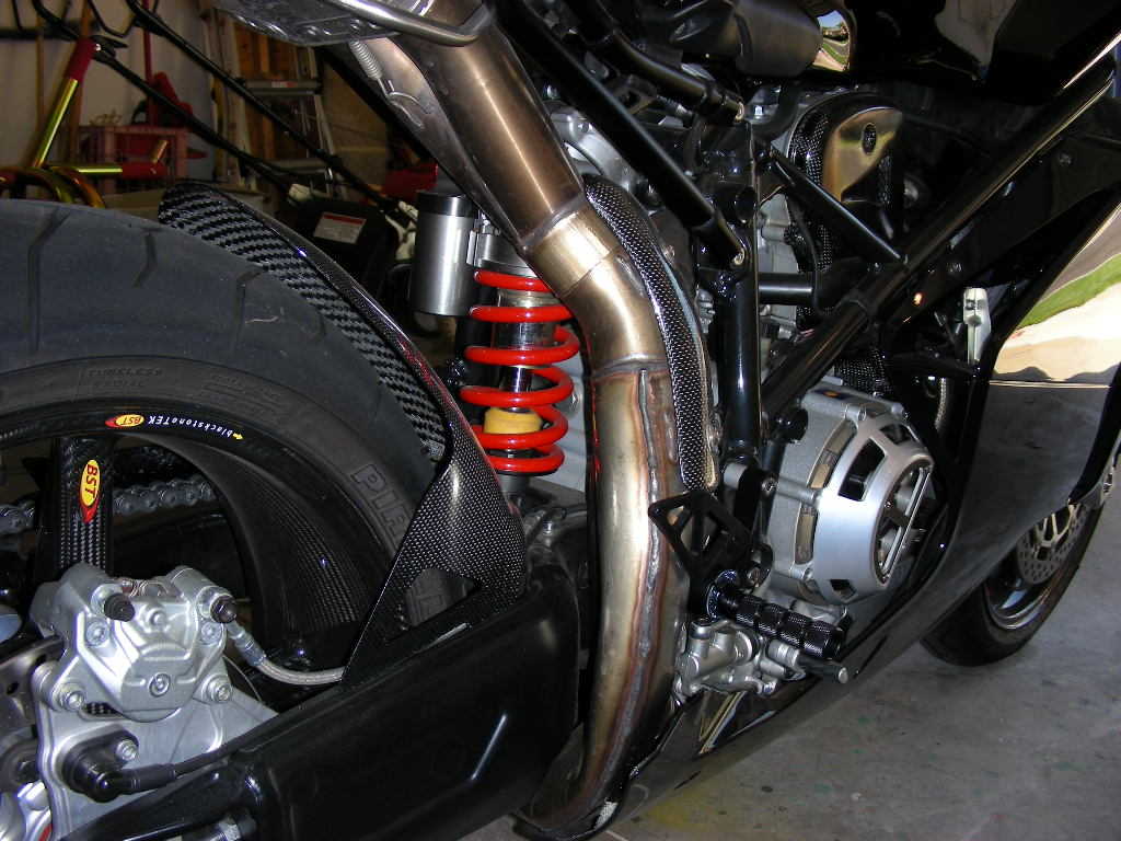

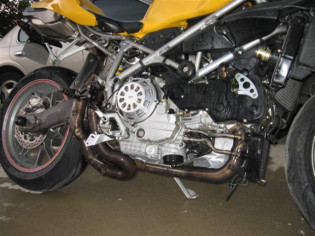

    These aren't my photos but they do demonstrate the differences between the 54mm full system for grey and black swing arms. The newer type has a squashed section that routes between the foot peg and the swinging arm.
    It's definitely different but I'm not sure how much work will be needed to make it fit, if it will fit at all. A rubber mallet maybe the best option.

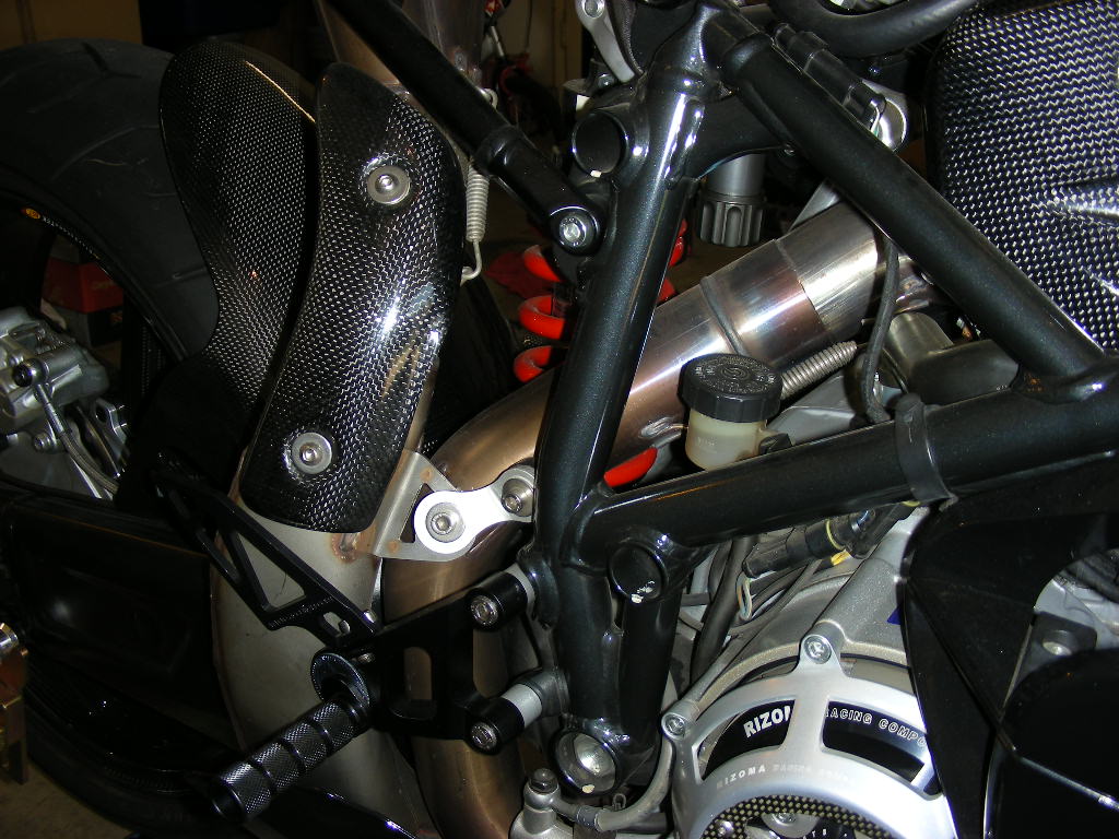

    These arent the greatest photos , just whats available to me at the mo Tom but you might be able to see (if you can enlarge them) that this is a 58mm system (57.5 to be exact) .
    The pipe next to swinger (the banana shape on a termi) is the full bore i.e. 58mm ,you may not have any worries. I wouldn't guarantee it but thought it may help.
    Oh they are large enough ,result.
    Pete.
