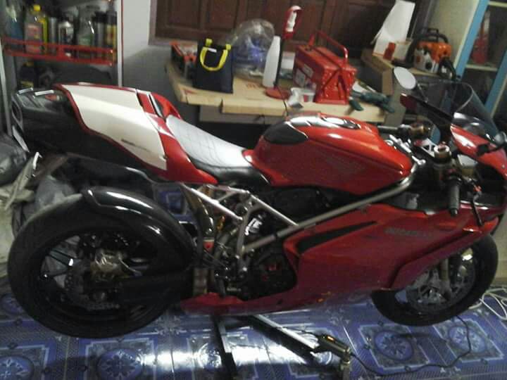

    This was ducati world lesson two for me as I am used to working on my own bikes but came to a stumbling block when I removed the fairing thinking that I could support the front end via my hydraulic lift as usual. Looks like an abba stand is the answer or do other people just use blocks to support the uneven underside of the engine?
    Thanks again

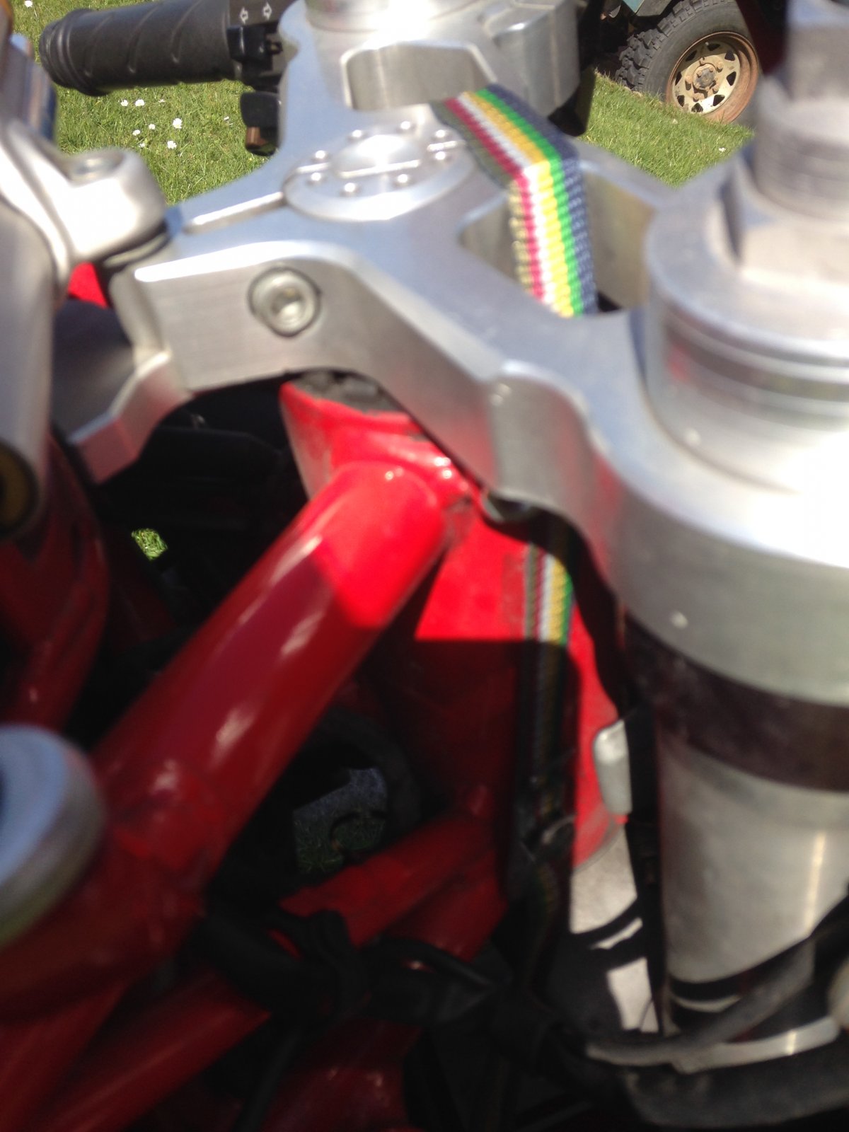

  10. I use standard under yoke stand on my 999. Remove spigot, place stand where it would normally go and strap yokes to horizontal bar with ratchet strap. The retaining pin prevents strap fron coming off end of horzontal bar.
    #10 900streetfighter, Jun 2, 2016
  11. That's what I call a quick reply.
    Looks like a good idea.
    I have a spare Harris front end stand- these are next useless anyway For most jobs so I will have a look at extending/adapting this to a paddock stand to suit
    Ta
  12. I have a Bursig stand which is perfect for most suspension work, servicings and general maintenance.
  13. Anyone using front under yoke stand like I do with a ratchet strap, use along with a rear stand as well.
  14. I use an Abba stand (because I had it ) and have brought the attachment that allows the rear wheel/swing arm to be pulled down which gets the front wheel off the ground safely .
