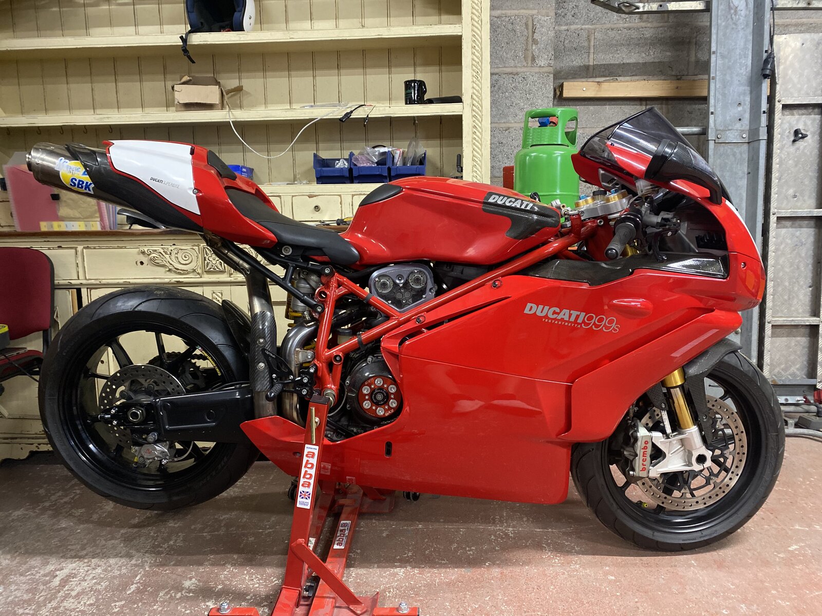

    finnaly got to go out on my 999s for the first time last week. BUT!! Accelerating through 4-6rpm it’s bogs down, then I get a back fire from the exhaust and it goes like it’s just been give a nitro shot!!
    I think it needs a dyno and remap what do you guys thinks?
    I have tune ecu and tried a couple of maps and it still the same.
    I haven’t reset TPS
    and I have Leo vince ti full system
    I am leicester based and willing to travel to get it to the right place to be sorted

  3. Probably the bike trying to tell you to get rid of the tacky Rizoma timing cover. (just kidding. Or am I?)
    Try resetting the TPS and checking the crank position sensor air gap. On my bike the CPS connector got some water once and the bike would not rev past 5k.
    The LV looks great. Best looking exhaust made for these bikes as long as you don't put a license plate holder or tail light on it.
