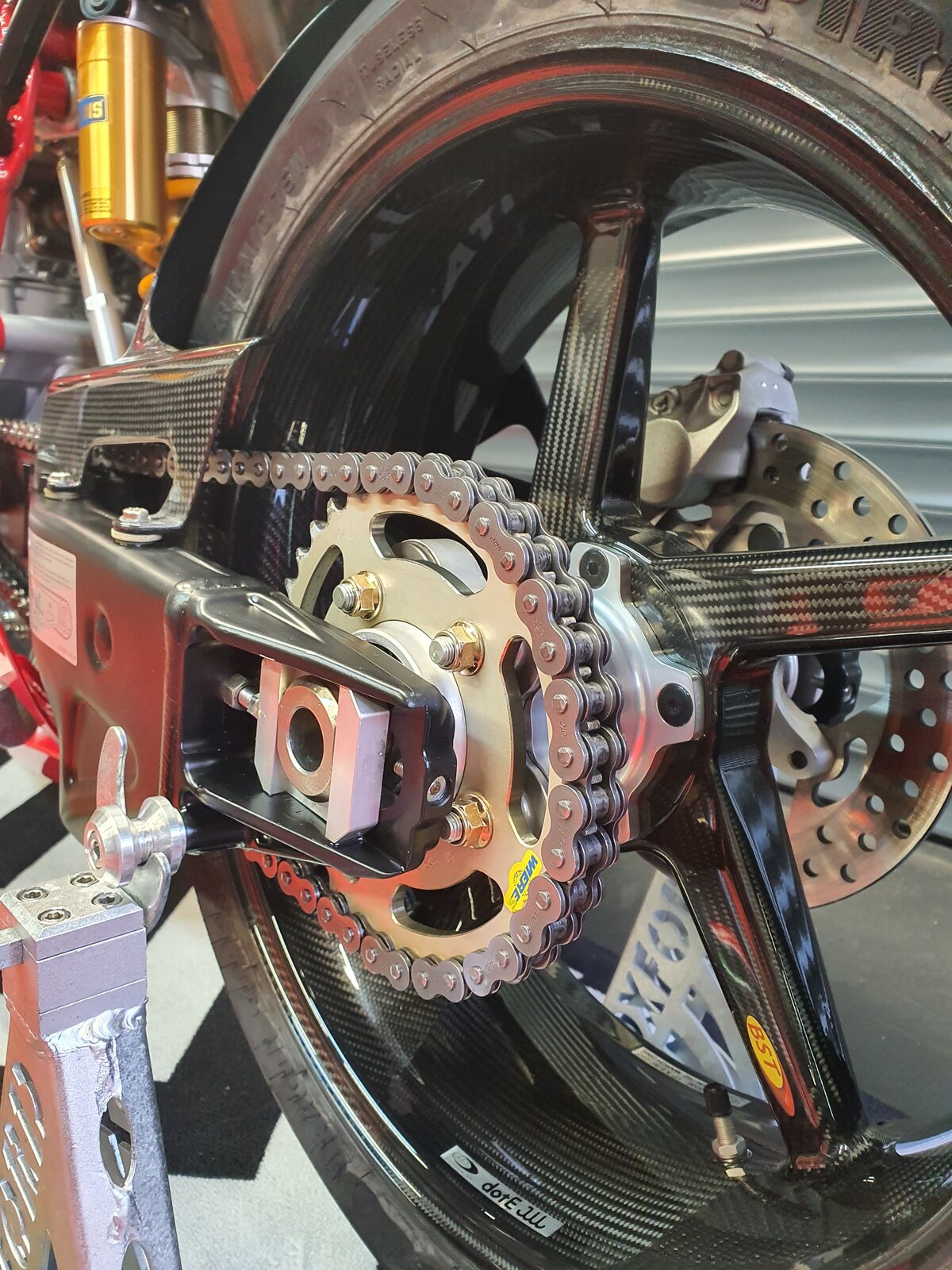

  1. I'm looking for recommendations for chain and sprocket setup please :bucktooth:
    I'm after AFAM black rear sprocket and front sprocket with gold DID ZVMX chain.
    Questions are:
    1. How many teeth front and rear?
    2. 520 or 525 pitch
    3. chain links
    4. UK stockists
    Many thanks :)
    Current set up for reference:
  2. Thanks @Sev and they're local, bonus!!
  3. B&C Express don't deal with AFAM but they passed me to Bike Torque Racing who do.
    Unfortunately because i have the BST's i can't get a rear sprocket that will fit! Bugger!!!
  4. Surely the sprocket interfaces with the sprocket carrier and even if the carrier was supplied with the BST’s, it’s got to be a standard Ducati fit ? Andy
  5. That's what I thought but they said not?
  6. I've checked the sprocket carrier the stud centres are 60mm. 5 studs in total.
    Googling how to work out the pcd gives me the following - 5/0.5878 = 102.08mm?
    I used a tape measure so the 60mm measurement may not be 100% accurate, not @Sev accurate anyway.

  7. gearingcommander helps you with the sprocket choices. 15T/39T sprocket and chain with 100 links and go with 520.
