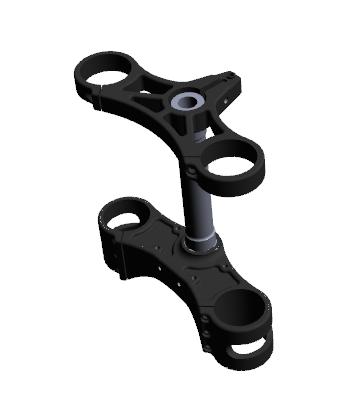

    I've picked up some 30mm offset yokes (from a group-buy on Ducati.ms earlier in the year) and as I understand it these will give me back some stability when running the steeper head angle, so I was planning to make both these adjustments next spring. I'm tempted now to fit the yokes before I go to Anglesey in September...
    Is it worth making both changes now, or should I hold off and see how I go with the current setup?

  14. when you change the steering head angle to 23.5 you give up 6mm of trail 97 to 91mm..........trail is front end feel...you need offset yokes -ie from std 36 down to 30 (gets you the 6mm back) or even more 27 or 25 but then you are close to the radiator.....
    100mm of trail is the target really............or even more, toseland ran in wsb with around 107mm......but its all a compromise just not as low as 91mm!!!

  17. Hi Andy - that sounds like it would make a low-side is more likely...? I'm not pushing it that hard at the moment, but maybe I should fit those triples. I read somewhere that the 30mm triples would be a pain on the road (turning circle?) so I've not fitted them yet as I do ride road as well as track.
    cheers,
    Dom
  18. turning circle is effected, ive got them on mine and it can be fun just getting in and out of a pit garage......
