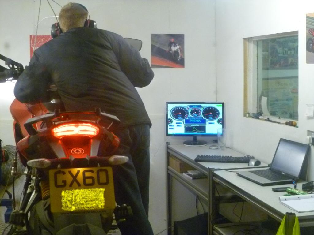

    Started really early with a wet and hard ride to Bristol to be there for 08h30. Chris was busy with a 848 from Luigi racing, looking for an intermittend fault (apparently the 848 would cut out willy nilly). Quick cup of coffee and the Multi was on the ramp, tied down safely and the connection process started
    Unlike some Dyno tuning companies that place a prod in the exhaust, Chris attaches air fuel sensors directly to each manifold.
    this allows the individual cylinders to be tweeked.

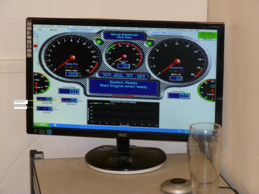

    The Dyno dashboard shows plenty information, including RPM, the Air Fuel ration (AFR) for each sensor/cylinder as well as the TPS (throttle position).

    The concept as far as i understand it, is to get the AFR for each cylinder in a range between 13 and 13.5, in each gear, creating a 3 dimensional map or plot consisting of 12 different maps. Add to this the spark timing maps and you have a total of 14 maps that need tweeking.

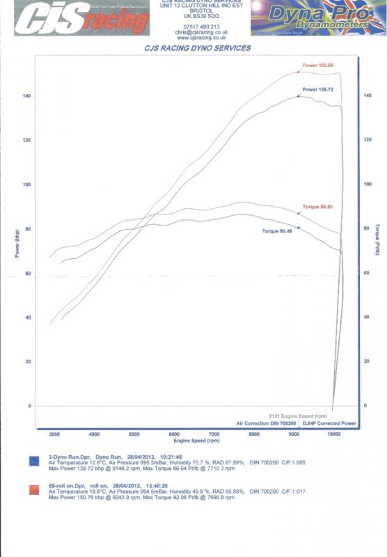

    Now the wizardry starts, and Chris tweeks the binary codes for each map, trying to lean out or enrich the mixture of each map at different rev ranges. A tedious and time consuming affair. A lot of time time was spent in the 1600 to 2500 RPM ranges, expecially in 4th gear where I found the surging to be the worst. Finally after 4 hours the AFR of both cylinders were within the required parameters, and the spark ignition of both cylinders were set, meaning that both cylinders are in perfect symmetry. Final results...no surging, increased horsepower and increased torque....oh yes and exhaust servo disconnected as well as the O2 sensors (meaning the bike runs only on the set parameters, no more fuzzy logic)
    All in all a very interesting day, thanks Chris (feel free to make corrections if i made professional fact to layman fiction)
    Synopsis...bike is smoother than a babies bum, and scary power

  2. Thanks for interesting post.. i knew these multi's were powerful, Did I read that right..150 at the rear wheel, eye sight not as good as it was. If so thats excellent.

    and finally the power torque curve again for those that couldnt read it. Bigger file this time, but yes 150Hp at around 9000rpm.
    DYNO results scan0001.jpg View attachment Dyno results scan0001.pdf
