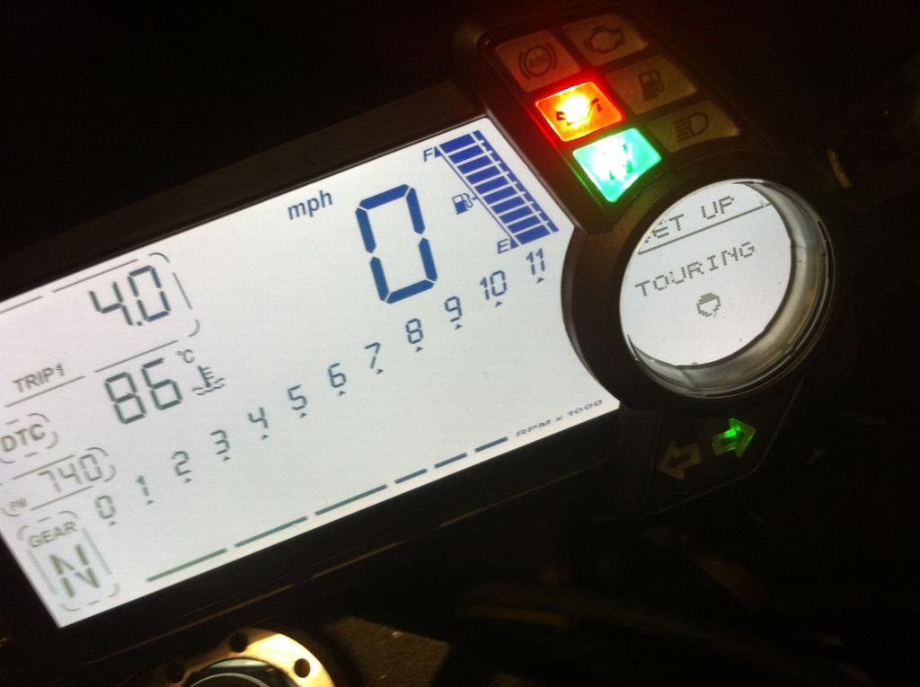

    One other thing that's just started is a faint green light showing in the indicator area when the neutral light is on, and the neutral sometimes flickers. Any suggestions?

  3. This is the issue with the clocks, it's starting doing it when I ride along as well, but not all the time. Grrrr I hate intermittent faults.
  4. Hi, oh dear seems you may be suffering with what should be covered by 'call backs'.
    FYI I've had 5 call backs 2 of which were for software update on the steering lock as some customers wre complaining about steering locks staying on! and Dash change due to the lights 'bleeding' through into other indicators on the dash. Hope this helps. vj
  5. As reported else where on here dash light bleed is a common problem. My neutral light likes going on extended holidays and now my right indicator dash light is trying to impersonate the neutral light. New dash sitting in dealers ready for 22500 mile service when it will get swapped foc. Bike now 2 yrs and 5 months old. Dealer serviced from new.
