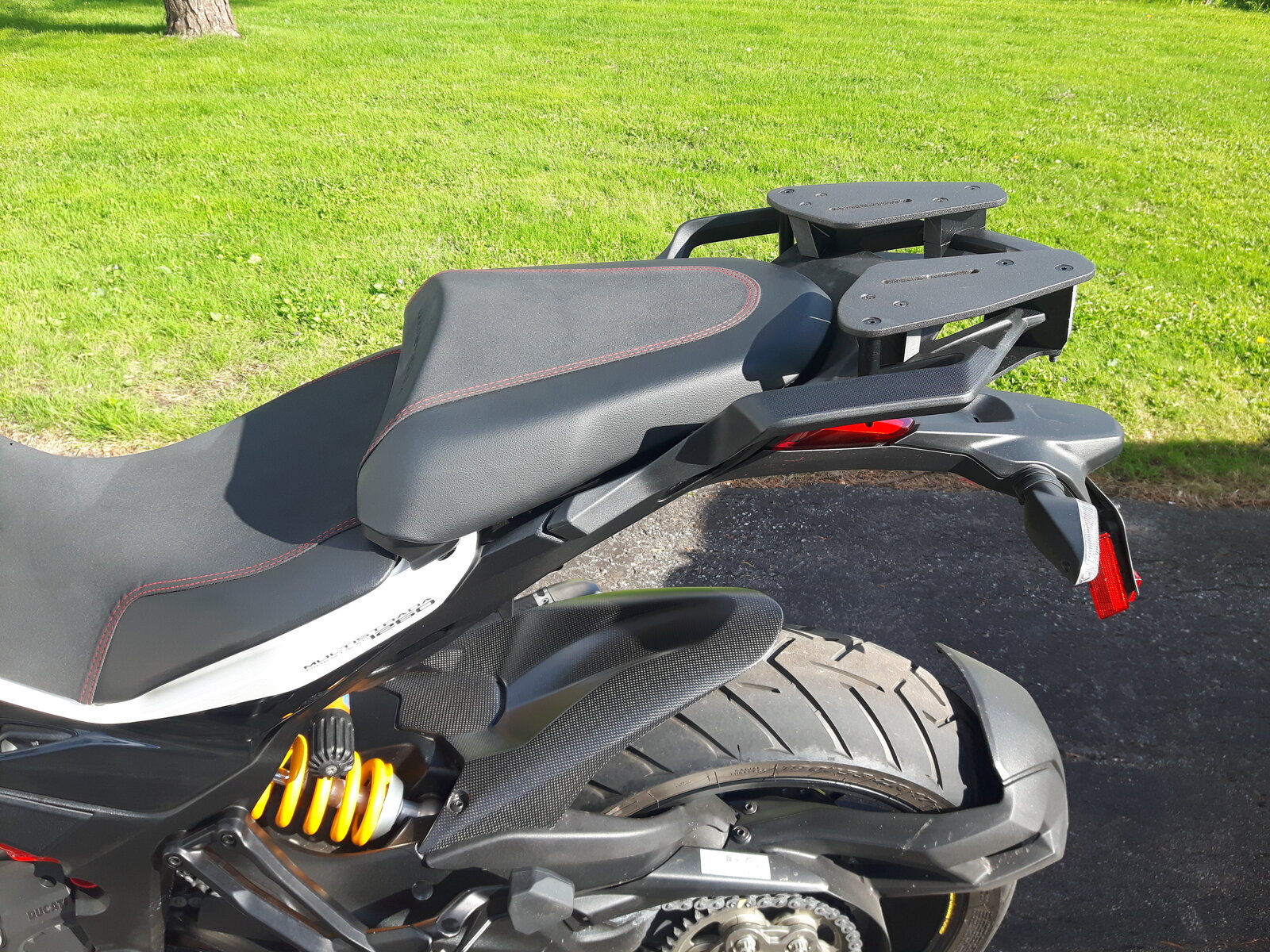

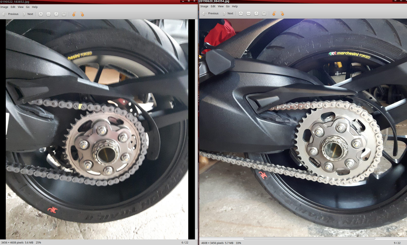

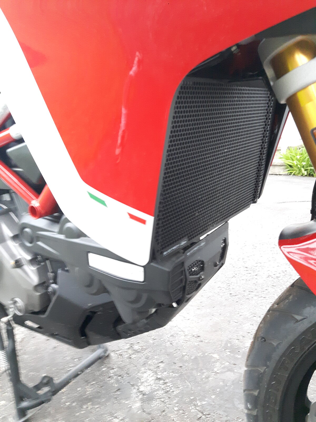

  16. I'm enjoying my 1260PP. Can't see a reason for the V4 other than a Pani but that's another story.
    Not a fan of top boxes. Panniers are a better option which I rarely use but that's just my opinion. I have a back-rack for a small bag which is more useful for day to day. However, I respect everyone's choices.
    I've had a Anti-Gravity LI battery since day one. No issues.
    Rad-guard for insurance.
    I bought the Navihalter GPS bracket ( can be used for a phone) with no issues but I believe the UK's Iconic set-up is equivalent.
    Best Mod for me was a +2R gearing change. Had it done at the 600 miles first service.
    Heated grips, center stand and a few cosmetic mods completes my package.
    The rear mud guard was removed shortly thereafter with a noticeable improvement in rear suspension.
    Enjoy your new ride.
