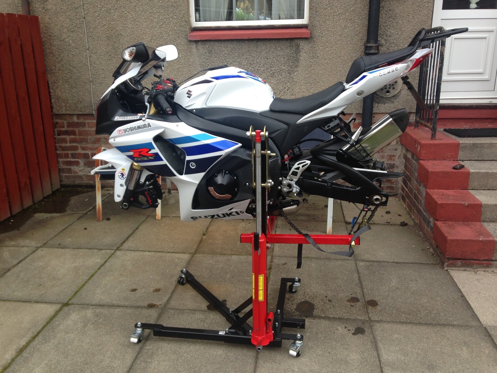

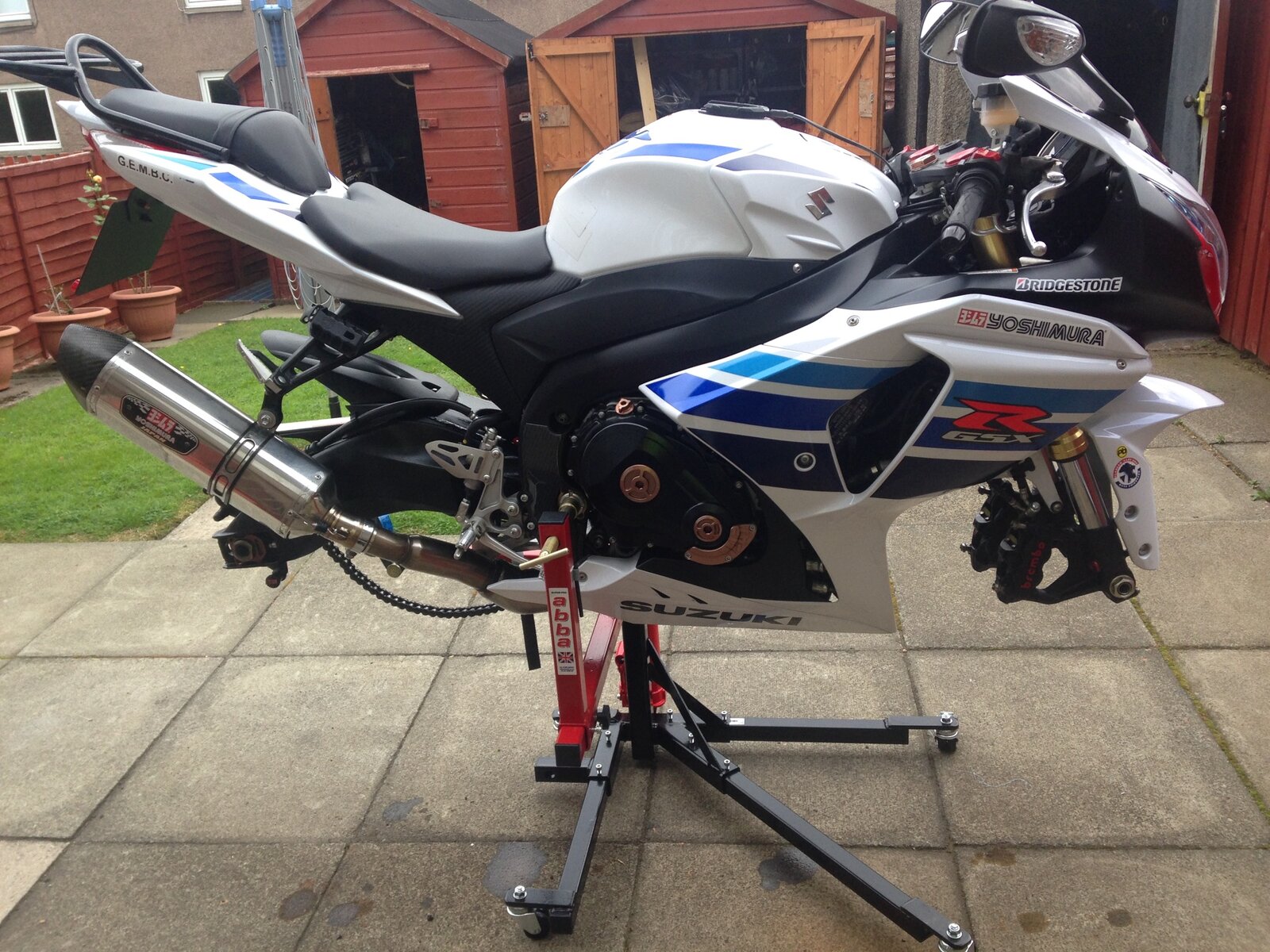

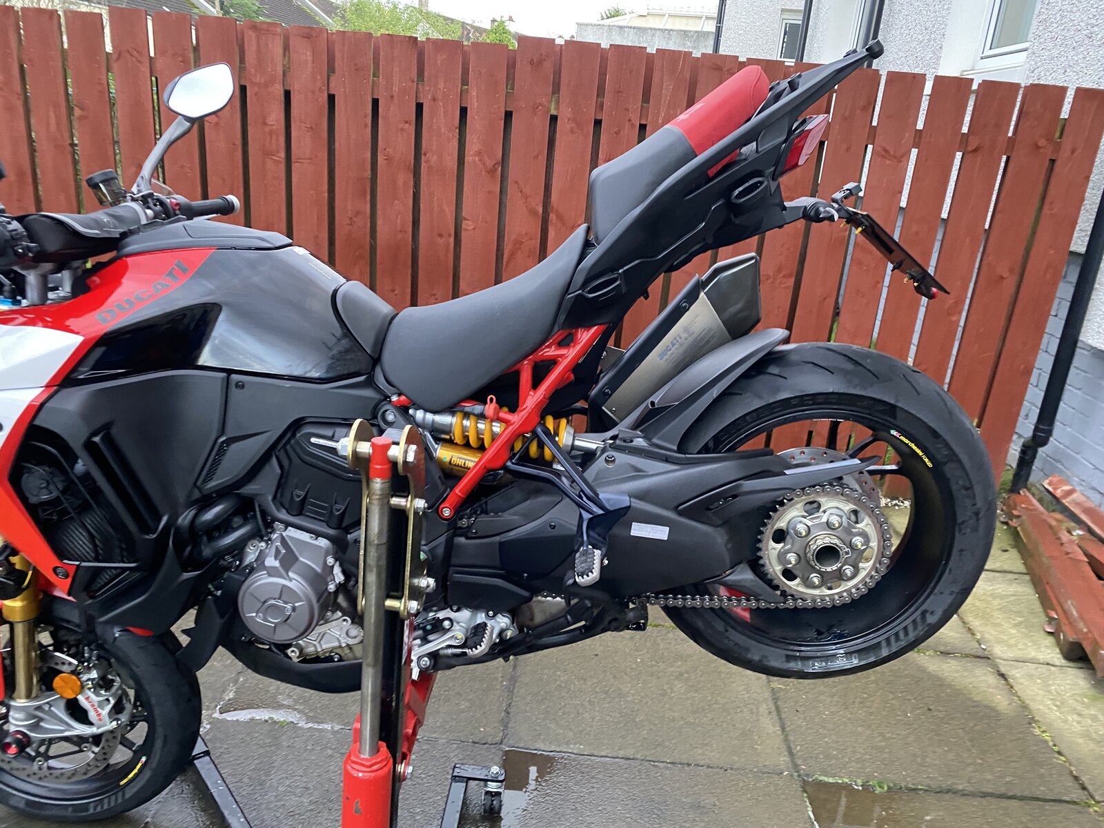

  12. Works well and you get used to the 'wheelie' and 'stoppie' nervousness soon enough.

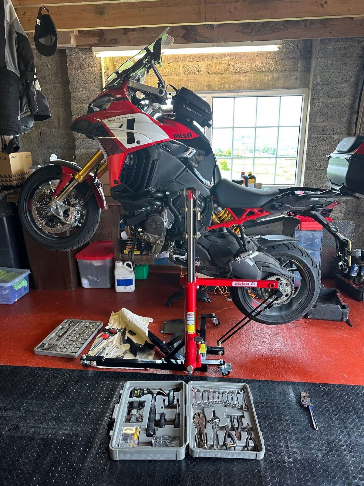

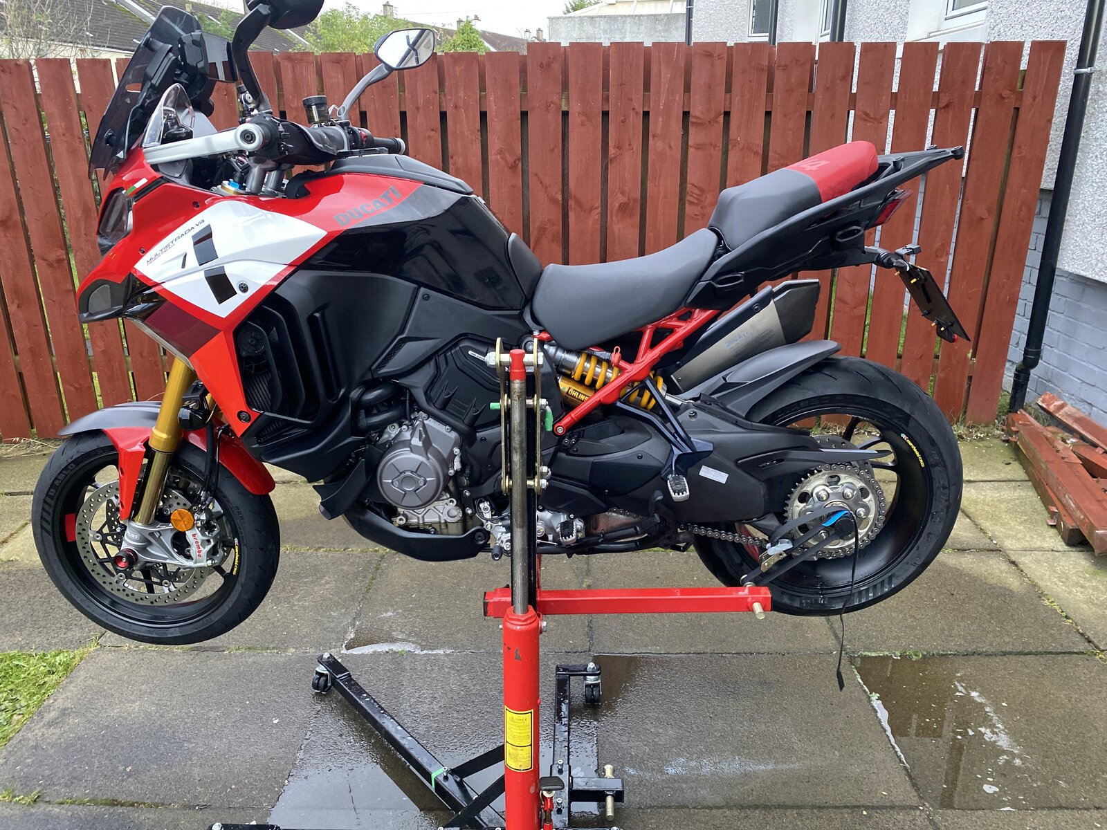

  13. IT WORKS FINE HAD IT ON MY V4S FIRST

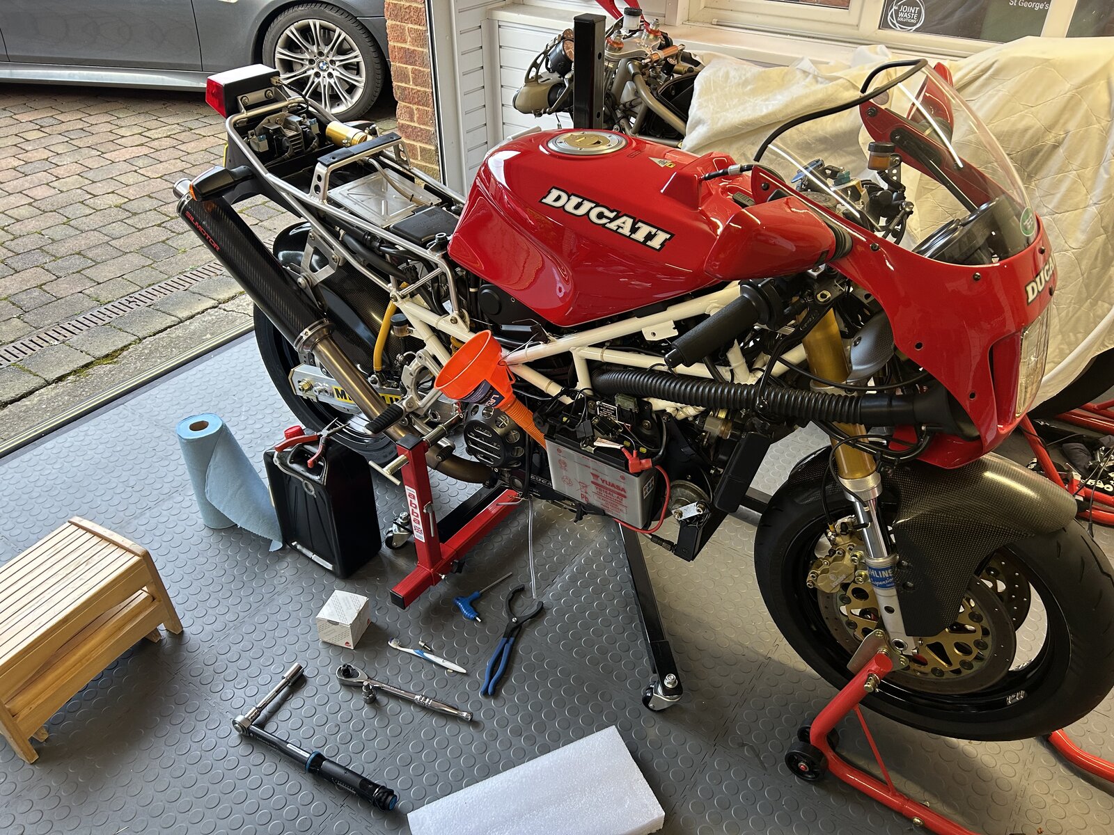

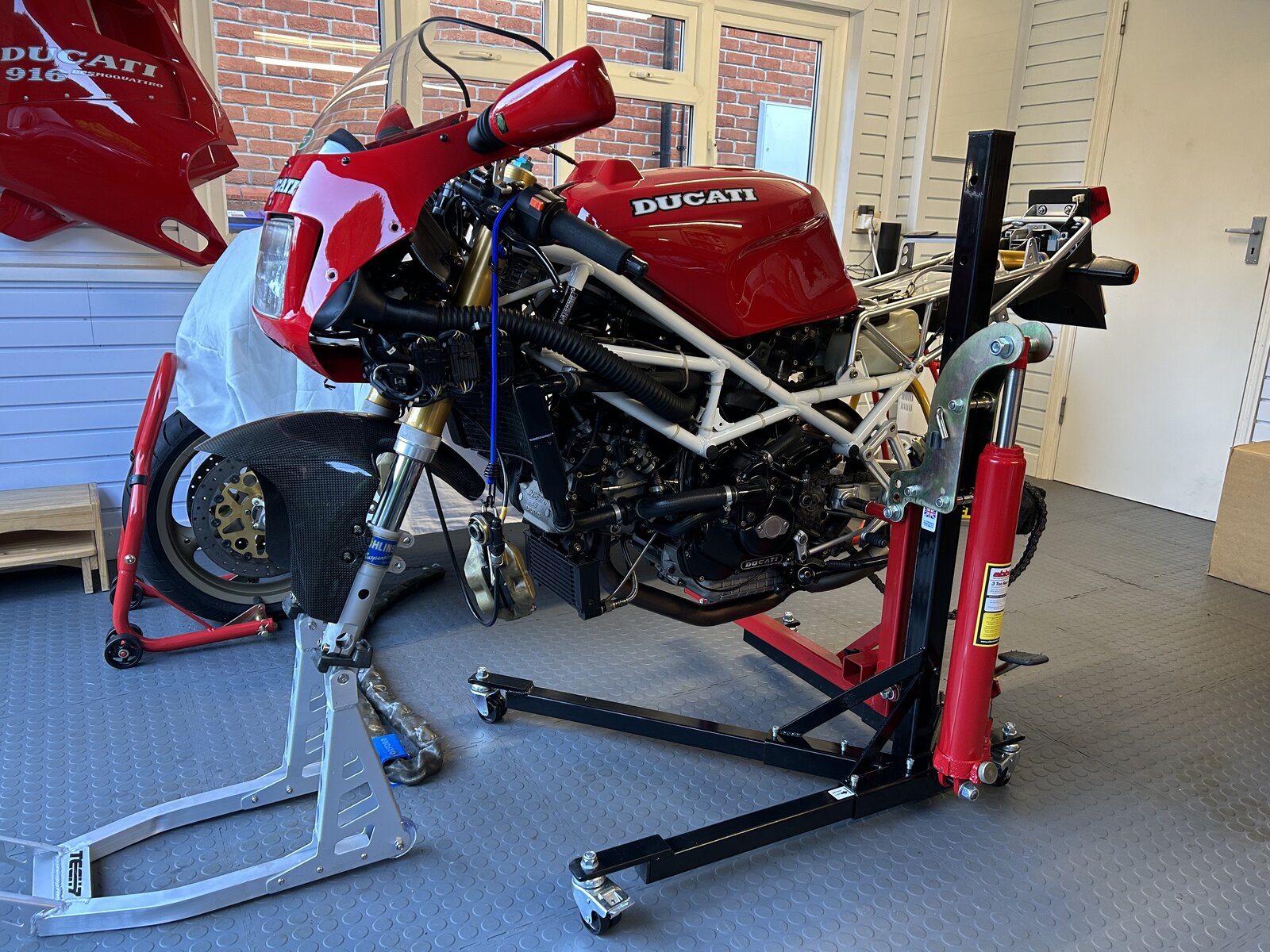

  15. Use mine to support the bike (e.g. remove both wheels etc.) for all jobs as access is easier. It can be used in conjunction with a front stand. The are some jobs where the stand restricts access such as the clutch. I have floor tiles which are dimpled and never really had an issue moving the bike about. IMG_4477.JPG IMG_4003.jpg
