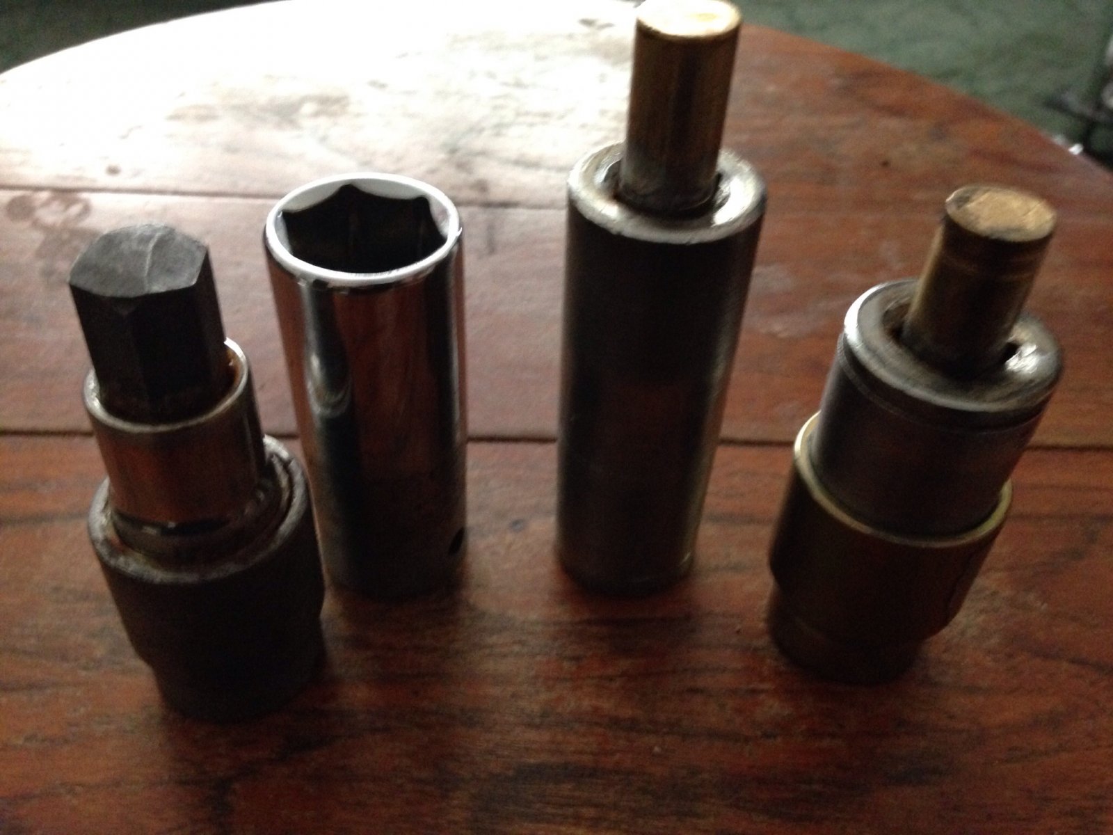

  2. I made my own from old 1/2 drive sockets. Put a bolt through them and fit into pillar drill to file to outside diameter, spark plug sockets are good. Lead solder a spigot in on gas hob.
    Made a set for 999 and SS.
    I got 150mm of 13mm brass bar from eBay for £3 for the SS spigots.
