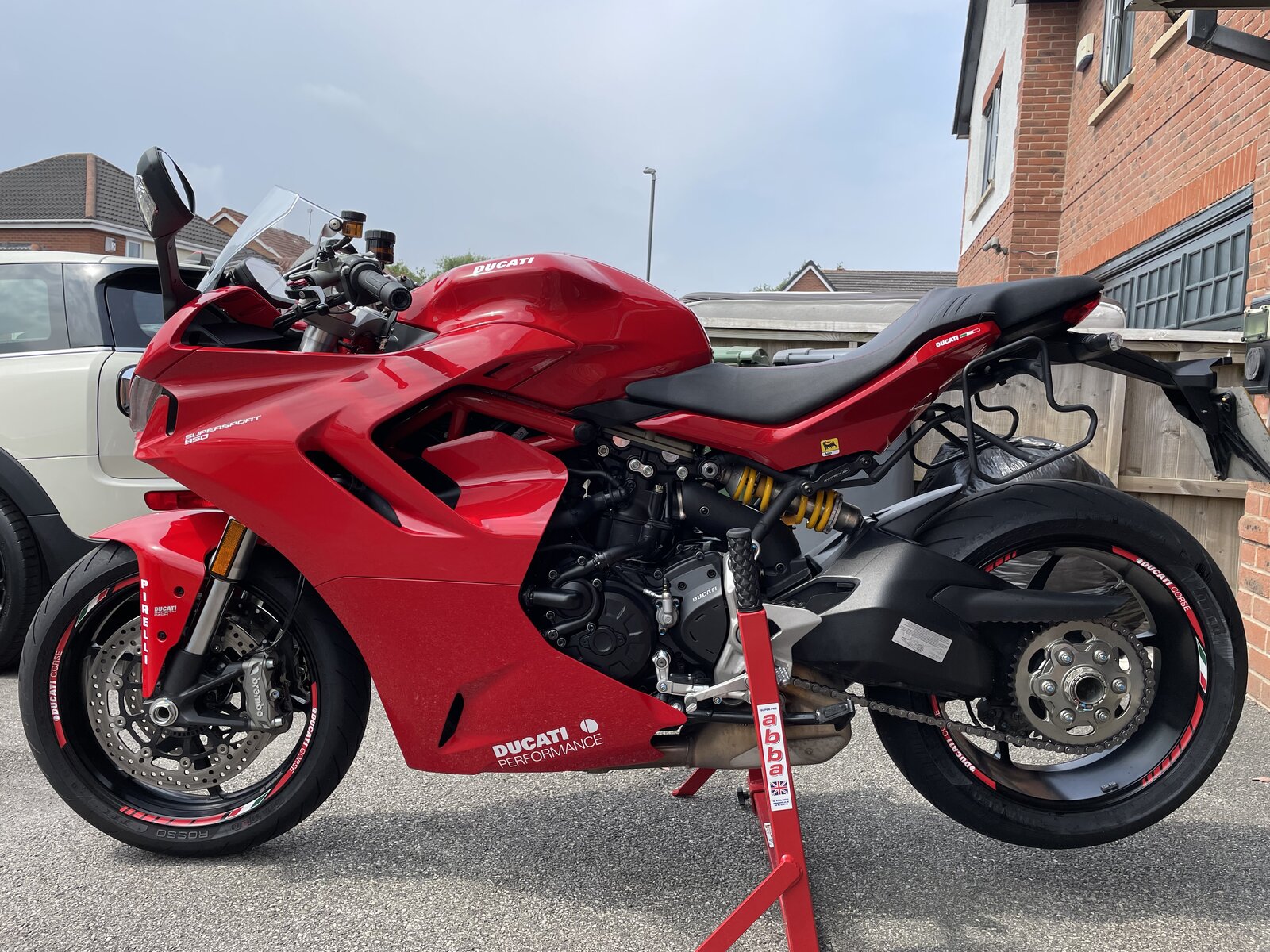

    Reason I ask is that I have one, bought for the 900 SS, and I am very pleased with it.
    I know there is an adaptor kit for the new 950, so how does it attach to the bike?
    Thanks
    S23

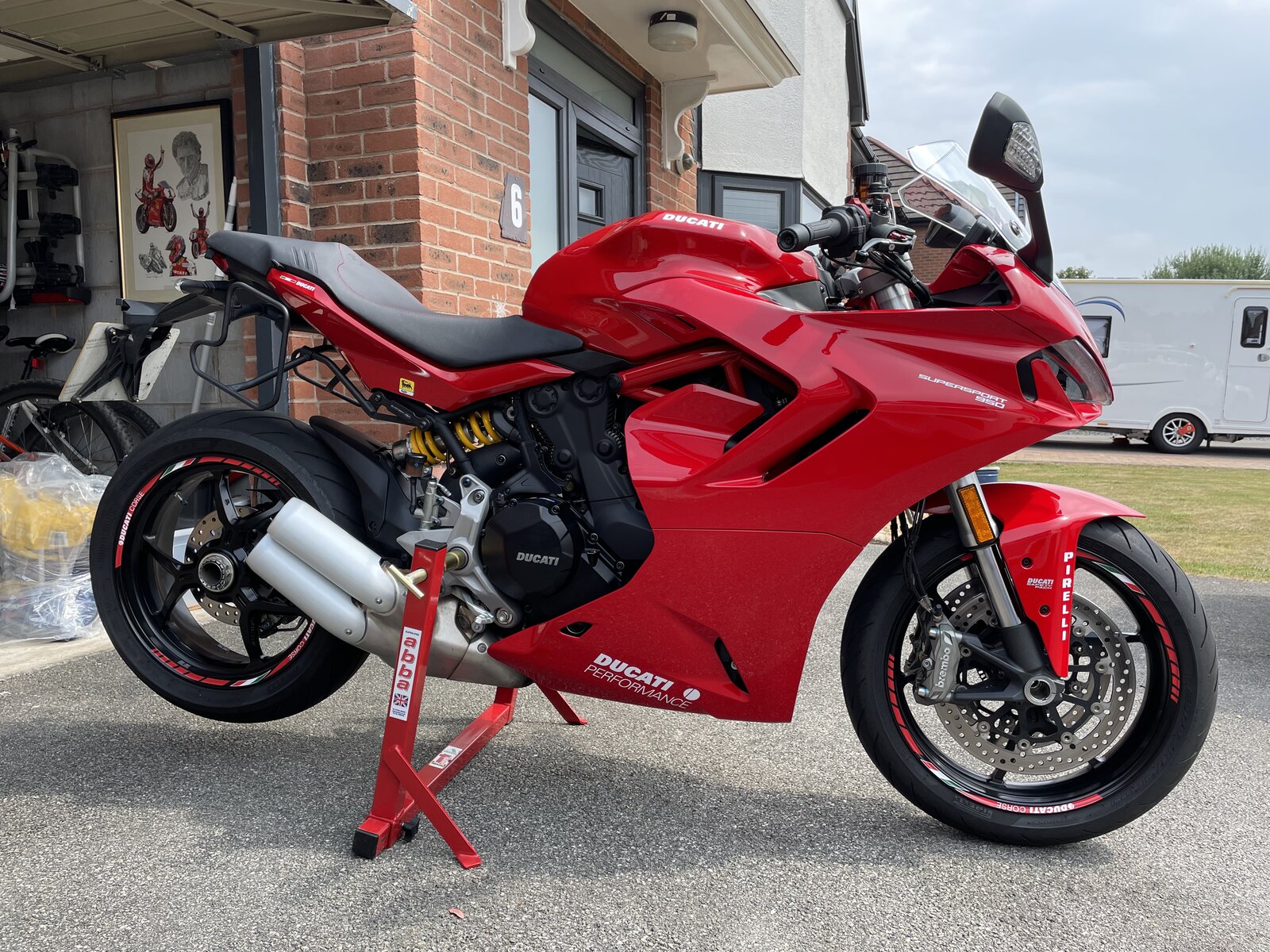

  2. The same as all other bikes, into the swinging arm attachments. I have the kit for the 939 Supersport including the rear axle spindle here. Would offer it for free but the postage and duty would probably be more expensive than you ordering from Abba.
    The stand fits the same way to my BMW.

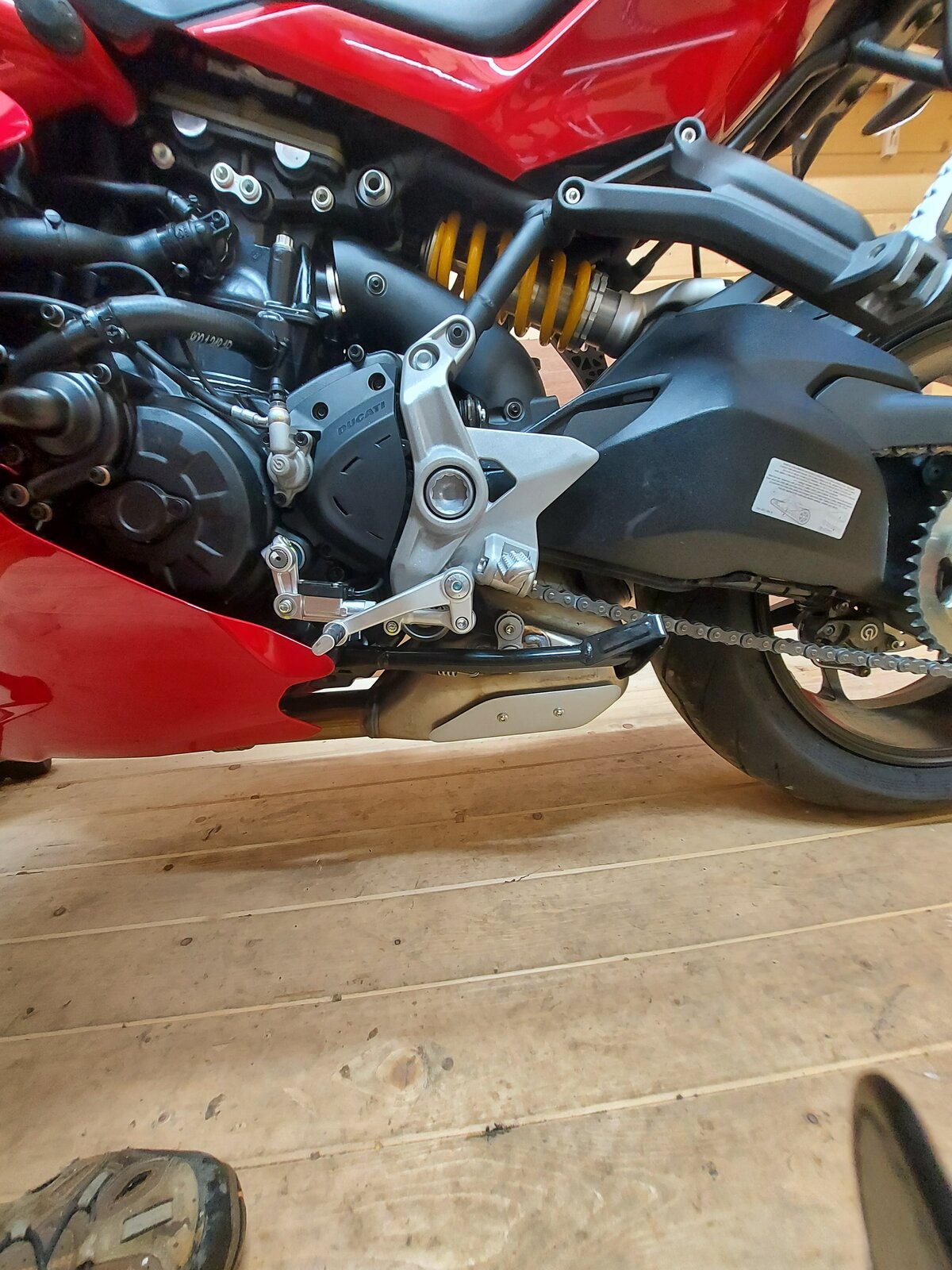

  4. Does the adaptor fit in the big socket head fitting at each end of the swingarm pivot?
  5. As above - probably a socket that fits over your swingarm-pivot caps/whatever. I'd call ABBA and have a chat...
    Edit: Just saw your pic. It'll be a prong that 'enters' the swingarm pivots you're showing...

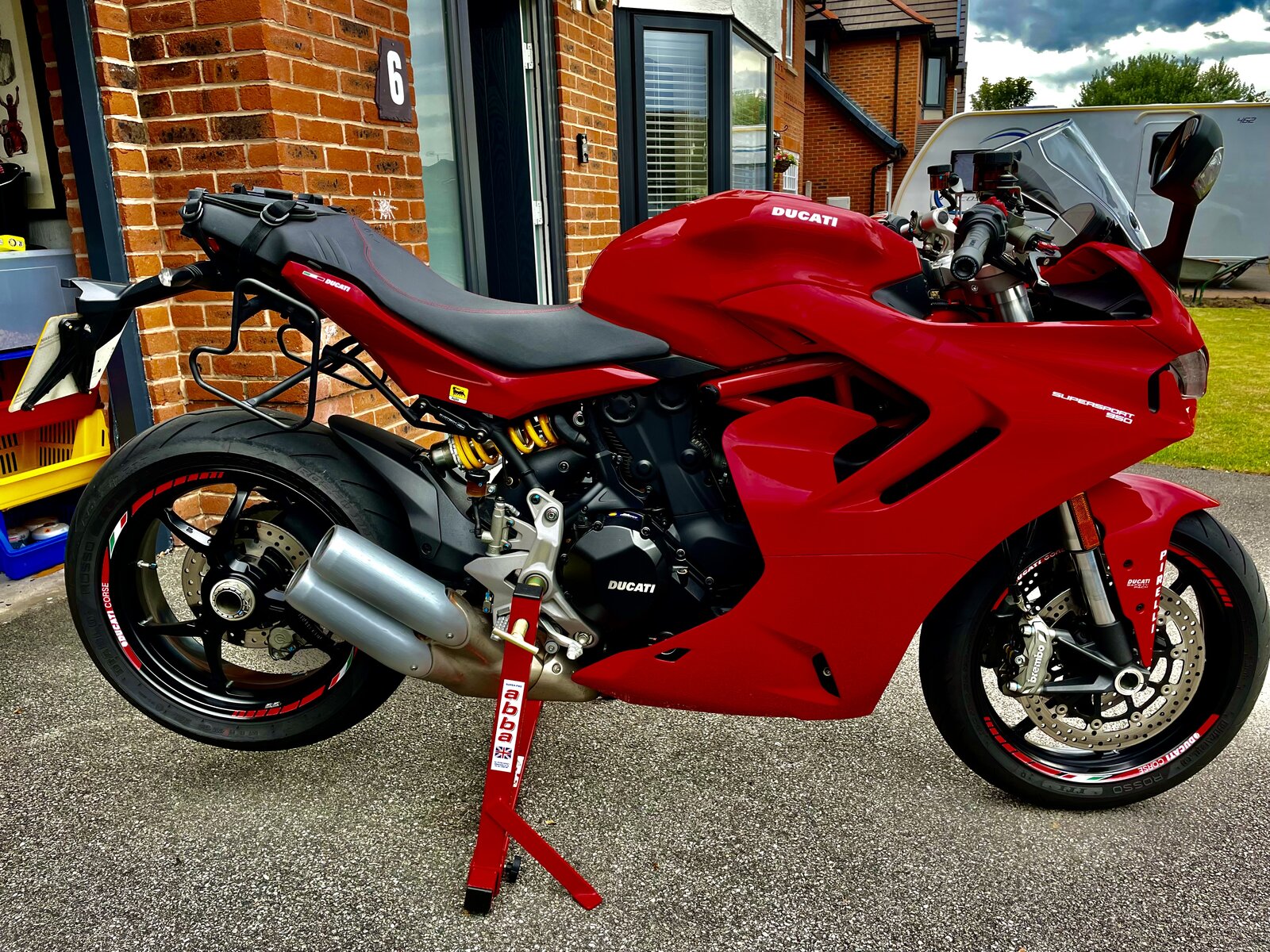

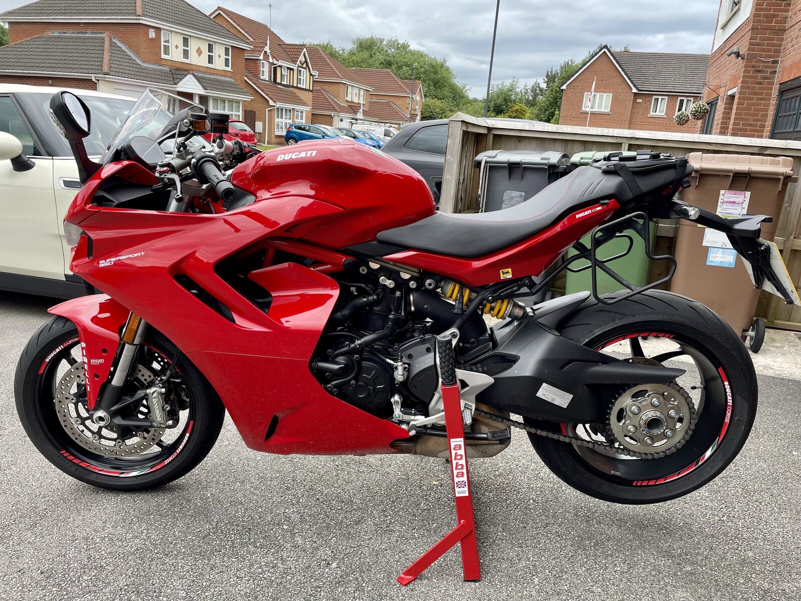

  6. I have and use the Abba Superbike stand. It’s great.
  7. Just a lesson I learnt the hard way. The adapters can get stuck in the frame. If you don’t notice and remove the stand. During your next ride the vibes will kindly free it up and presto….you’ll need a new adapter kit!
    So always check the adapters have come out.
  8. I have the Abba Skylift and part of the procedure for removing the bike is to detach the stand and put the adaptors into the box on my workbench. Never had them stuck in the bike.
