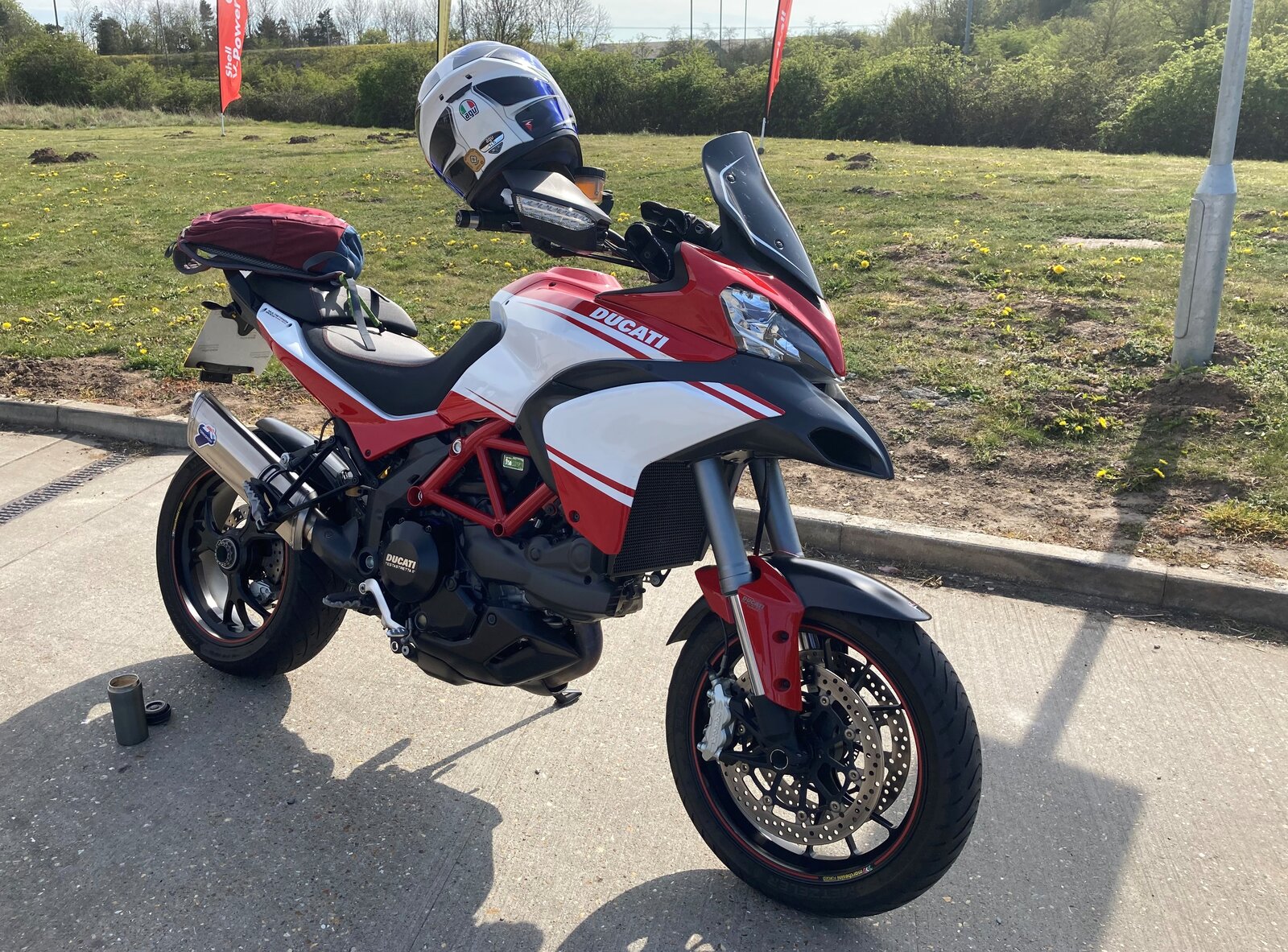

Thanks guys, didn't need it in the end as bought a different one - at last! Cool 200 mile ride home and I mean cool in both senses of the word!
