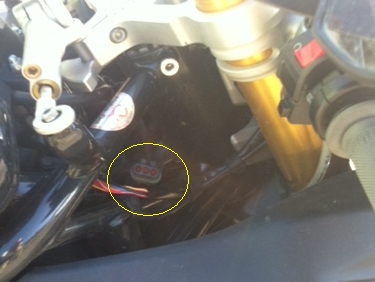

Hi there, Thinking of adding a power socket to my 999. Idealy don't want to be splicing into wires so was wondering if there were any redundant sockets on the wiring loom? Cheers Matt

Loz, Found one, just sat there right in front of me on the RHS of the frame! <a href="http://thumbsnap.com/fBuHhmLZ" title="Image Hosted by ThumbSnap"><img src="http://thumbsnap.com/s/fBuHhmLZ.jpg" alt="Free Photo Sharing by ThumbSnap" /></a> Tested with a 12V bulb with ignition on and off and can confirm that it is connected via ignition so wont drain the battery if you leave them turned on. Ill give it a go and feed back.
I don't want to do that in case I leave them switched on and turn the bike off. Since there's a spare 12v connector I'll use that.
Out of interest, would a tomtom power from that feed and would it need an inline fuse between the tomtom and the outlet? If not, would a better feed be the parking light so it turns on / off with the ignition?
