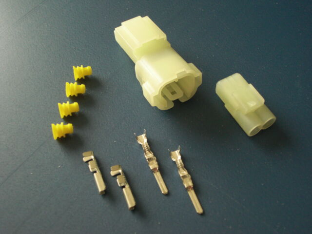

The Plug is there on the left side. it is blanked with a ducati logo plastic thing. just check behind the rubber cover on the left side of the frame. it is a 2 pin sumitomo male connector. if you can managed to find female of it, you are good to go. This connector also powered straight from the fuse box with 7amp rated fuse in place. I am using same for my usb connector. For the exact location of the connector just check this video starting from 2:18.
