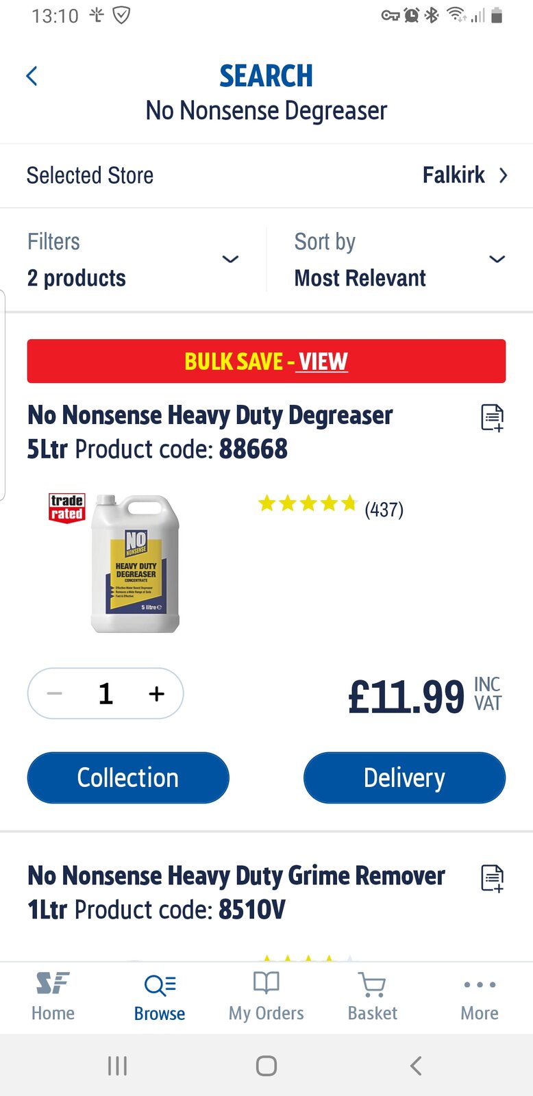

  12. I use a Screwfix general degreaser in a spray bottle for ACF-50, Muc Off HCB1 and whatever else is needed. It's cheap (for 5 litres) and effective.
