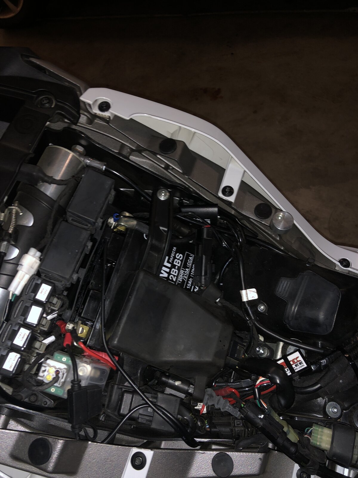

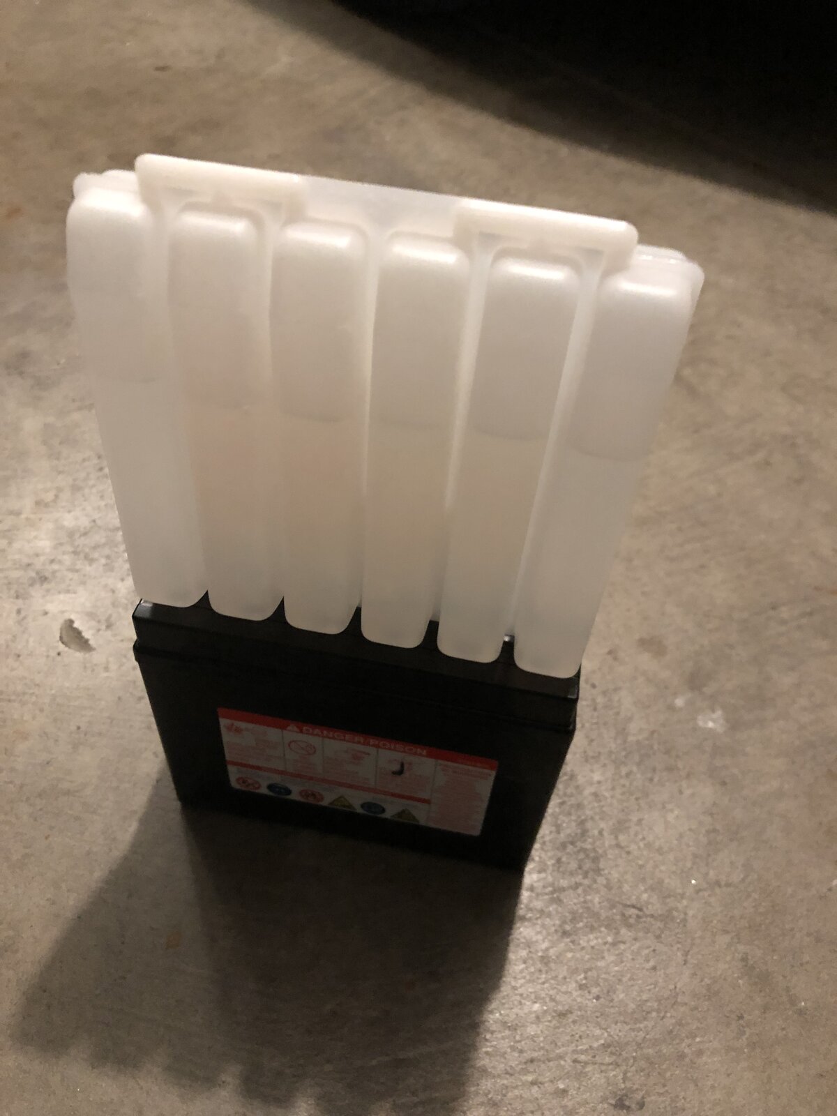

    ordered a replacement OEM Yuasa YT12B-BS battery for the 1260s yesterday afternoon from summitracing.com ... the battery arrived this afternoon (1 day delivery, from their Nevada warehouse, one state over from me) ... all for $95.90, overnight delivery, and tax included.
    w00t!
    hopefully, this one will last longer than the stock one ... 2 years is not good, but a few of my friends who are EEs suggested it might have been a murder-suicide from the 12-year-old battery tender i had the Multi hooked up to.
    i got advised from an old friend who is the top Ducati mechanic in North America (he used to train the Ducati dealership techs) that i should only put the bike on the tender once a month for a day at most. i will heed his advice.
