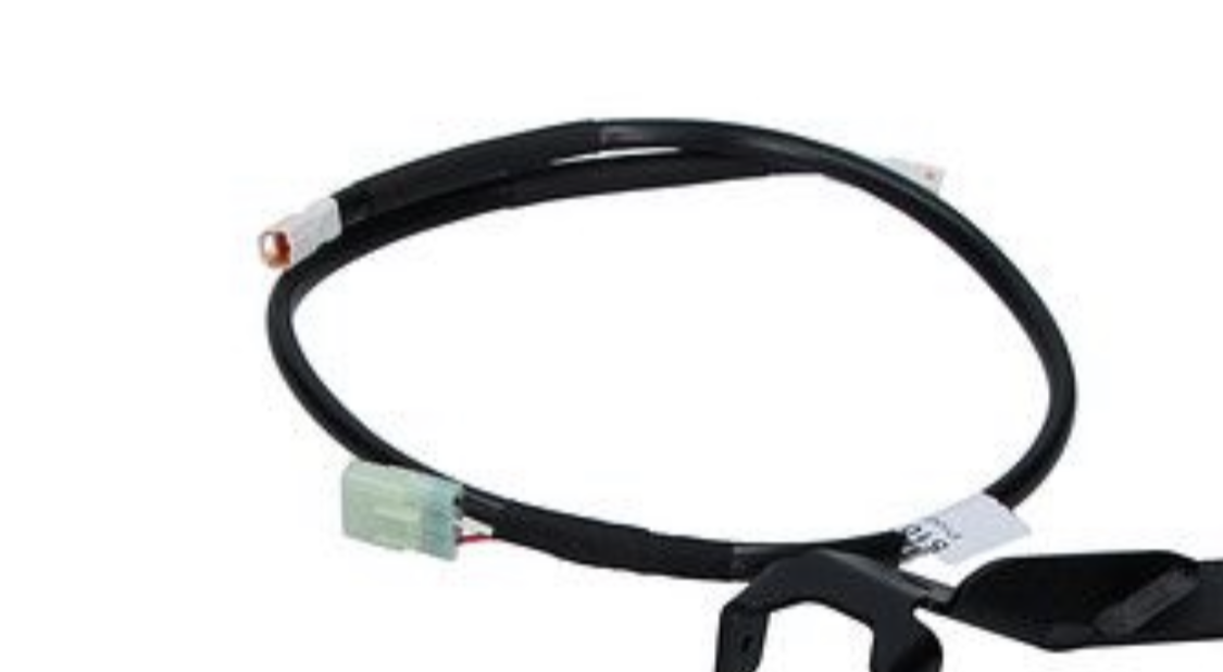

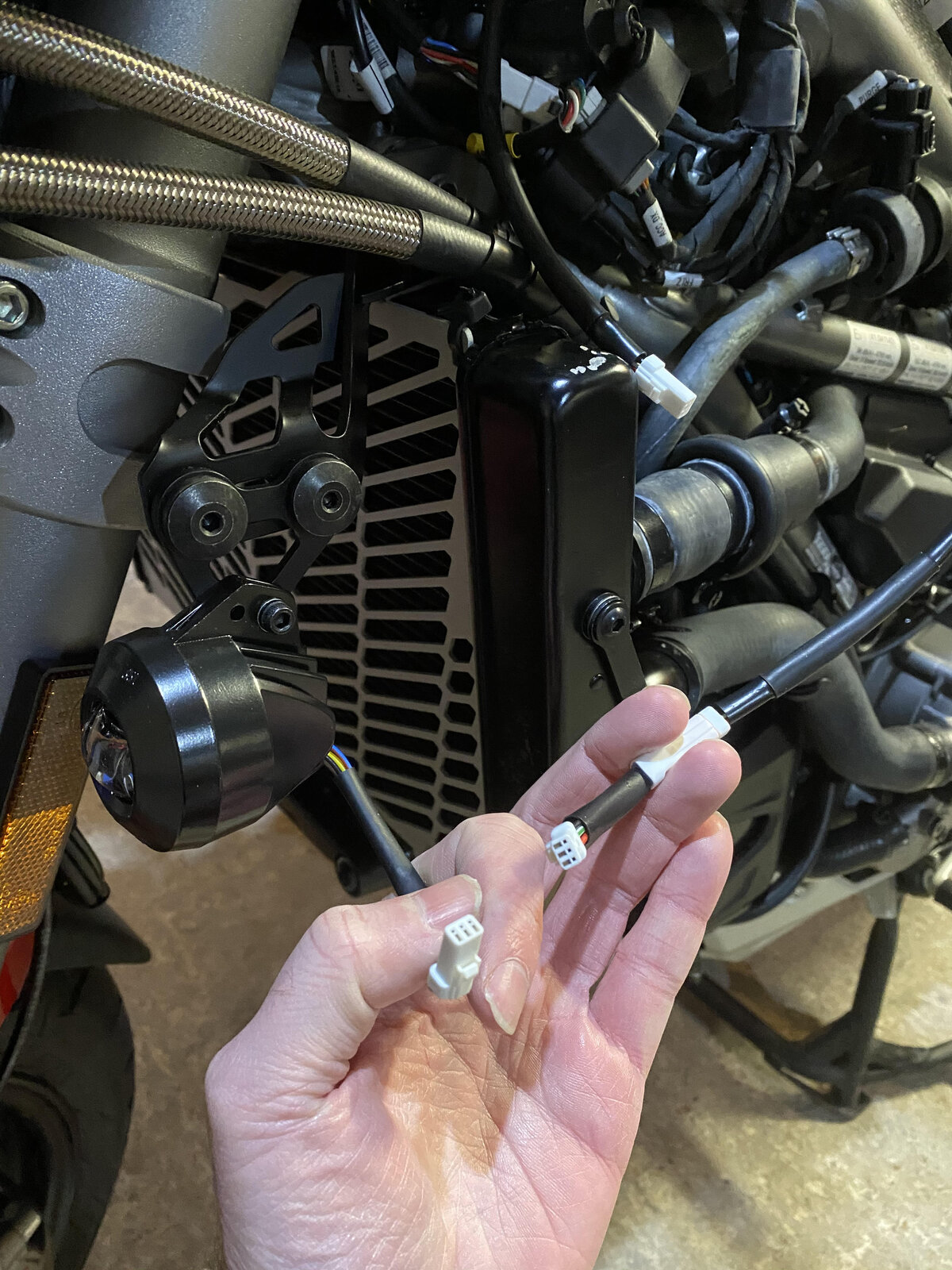

Hey I just received my additional lights kit bought off eBay (picture of the kit here https://www.kfm-motorraeder.de/cms/en/genuine-spare-parts/ducati-spare-parts?itemid=96680833A). I've fitted the holders each side of the radiator, found were to plug the wire, now I need to connect the wire to the light themselves. Oh surprise: these are two male connector ! I do not see any male to male bridge in the kit. Question is simple: am I being daft? If this a known issue with the kit and I need to create the connection myself? Thanks for the input
Did you get the full installation kit? Looks like you are short of wiring. https://www.stein-dinse.biz/product_info.php?products_id=471681#prettyPhoto Found these instructions for the part number 96680431A https://drive.google.com/file/d/0BwMhCNtmur8ES3hZOWZlZEV4OTA/view Has there been a specification change depending on year? For the part number you quote these are the compatible bikes MULTISTRADA 1200 ENDURO 2016, 2017, 2018, 2019 MULTISTRADA 1260 ENDURO 2019, 2020, 2021
Thanks for the link, found the problem. the wire I should have gotten is female: Of course I received male... I’ll try to negotiate a rebate with the seller, clearly something wrong there. thanks a bunch for the link !
The connectors are female both side. Here is a cheap source for the connectors. https://www.ebay.co.uk/itm/263873679303
