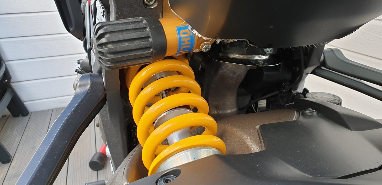

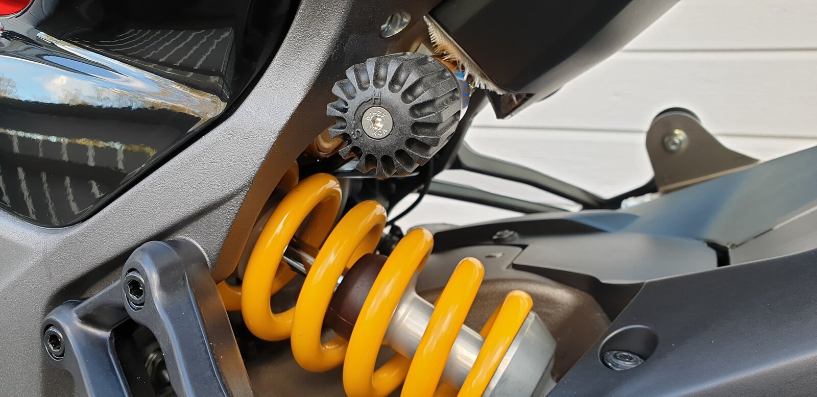

Need input on how to set the suspension correctly on my MTS 1200 Pikes Peak -17. I am a 113 kg man, without clothes My driving equipment weighs 12 kg, so the total weight is 125 kg From S (soft) to H (hard) I can turn 17 full rounds, clockwise What would be a recommended setting, without packing or passengers?
A little lighter (not much), but had mine set up professionally, and mines fully wound to hard. Suspension tech reckoned it could do with more, but required removal of the shock. That's for sag only, then youv'e got the rebound and compression. Play around, or get someone that understands the dark art of suspension to help. And make sure you put your clothes on before yo go out to test..............
You want to aim for around 35 - 50mm of rider sag (with and without you on bike). Good starting point
Pre load, compression and rebound can each give you a nasty ride when set incorrectly on their own and a really horrible ride if they're all out. You've pictured the pre load adjuster, the compression and rebound can be accessed under the seat. getting a pro to do it will also balance the front with the rear and should get you in the ball park a lot quicker than trial and error if your unsure of what's what. TB

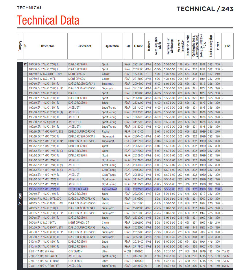

According to the 1260's owners manual, the maximum allowed weight (carrying full load): 992 lb (450 kg). The wet weight of the bike (with empty luggage) is approximately 550 lb. The maximum weight permitted for the side panniers, top case and the tank bag must never exceed 66 lb (30 kg), divided as follows: 22 lb (10 kg) max. per side pannier (1); 11 lb (5 kg) max. for the top case (2); 11 lb (5 kg) max. for the tank bag (3). Let's add this up. Bike: 550 lb Rider: 275 lb Luggage content: 66 lb = 891 lb Your passenger should not weight more than 101 lb in full gear. However, Pirelli's maximum load capacity should never exceed 851 lb (387 kg). Consequently, you're already exceeding the maximum load capacity without a passenger. Don't kill the messenger but you may want to consider these charts.
