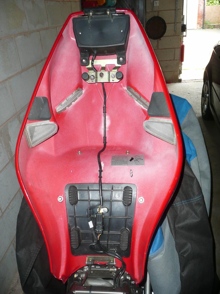

  3. Prior to fitting a mono subframe I had a mono seat on biposto frame and you need a different mounting bracket with more offset for the latch pin due to the different height of the rear of the tail unit.
    Not sure now as it was a good few years ago but you maybe able to make up the difference with spacers?
    This pic shows a mono seat fitted to biposto subframe, offset bracket clearly visible;
    As for the bracket, something like this;
