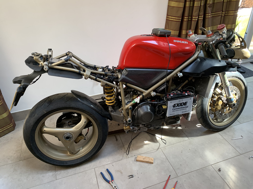

  1. As above, hoping that someone can point me in the direction of where I can find advice on how to go about removing the rear seat section - I have new bodywork that I want to fit, no problem with the fairings and nose section but it's not obvious how to get the rear section off.
    I did a quick search on here and on Youtube to no avail - hope someone can assist.
    Cheers

  3. Unlock the seat and lift it up. If you look on the left side in the frame area just below the seat tank join you will see the lock. Turn the key and lift the seat from the back
    You should then see the hinge. It is held on by 2 plastic pins. There should be a little plastic/rubber thing on the ends. Take that off and push the pins out. Remember to disconnect the wiring connector clamped to the bottom of the seat
  4. As higgy748 says just pull the little rubber piece off between the two plastic pivot pins and push the pins out to release the whole seat unit, you won't believe how easy it is once you've done it. Just one thing unplug the rear light wiring clipped to the base of the seat first.

  5. I think it's a mono conversion from a Bi - but I don't have the seat release lock - I guess this must be an afterpart unit - I'll go take a closer look and post some pics which may help to identify the issue.
  6. Sorry, should have said thanks for the responses guys, much appreciated.
  7. Bloody hell, it's obvious now I can get at the bike, just as you guys said (the bike has been stuck against the garage wall and was not able to check the left side of the bike easily) lock sorted the release so I can now begin to rebuild the back of it.

  11. So, I've managed to strip back most of the bodywork and now removed the exhaust for cleaning -
    @higgy748, @Denzil the Ducati - Couple of questions for you guys - can anyone point me in the direction of getting hold of the fasteners that hold the upper and lower side fairing sections together, or tell me what they are so I can search the bay for them - the side fairings that I removed were aftermarket one piece items so didn't have any mid section fasteners.
