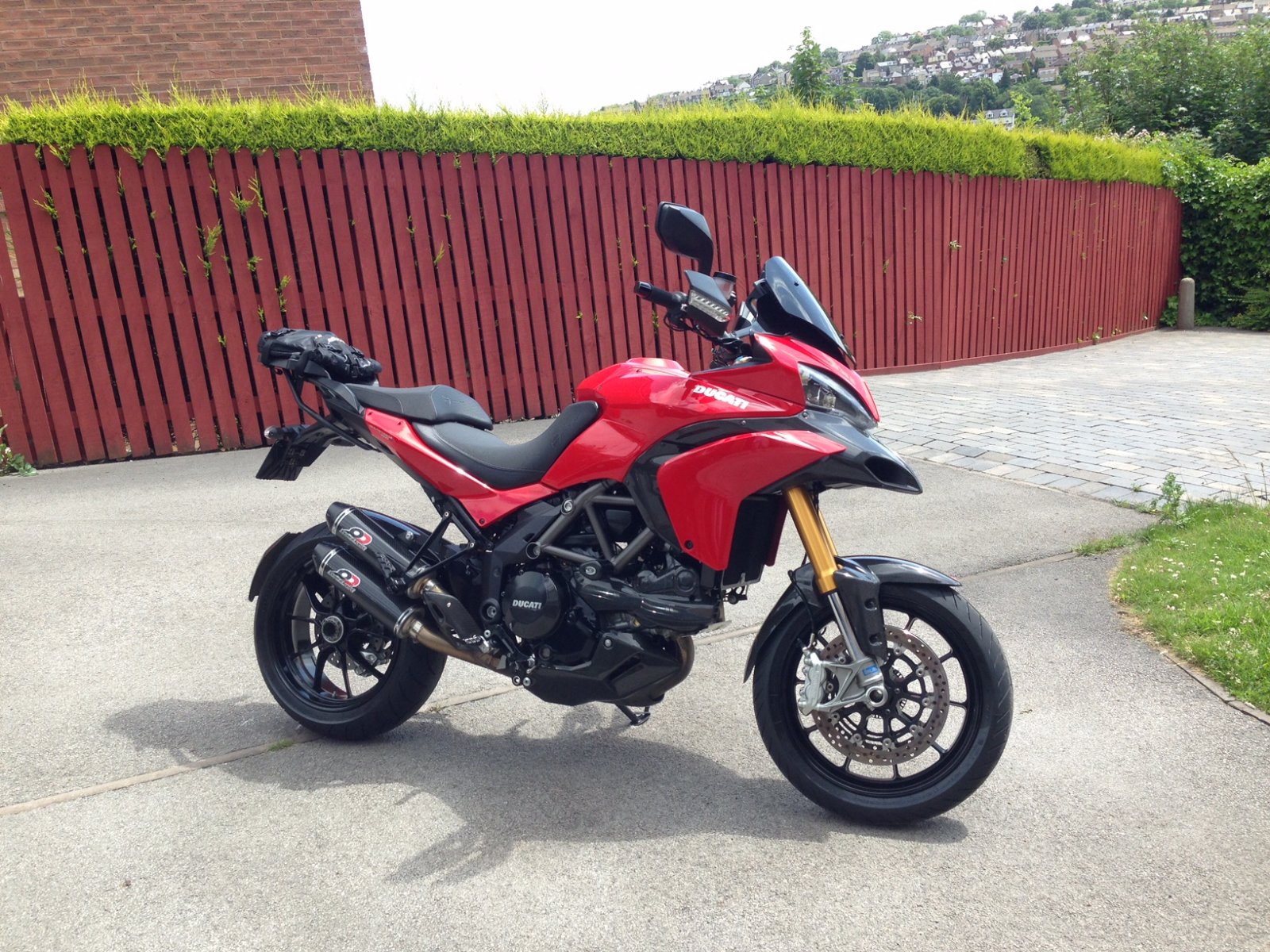

    Ive got the QD's twin silencers with baffles in, decat and a CJS remap 159 bhp at that back wheel, bike sounds like a Ducati should, goes like stink and looks the nuts IMHO
