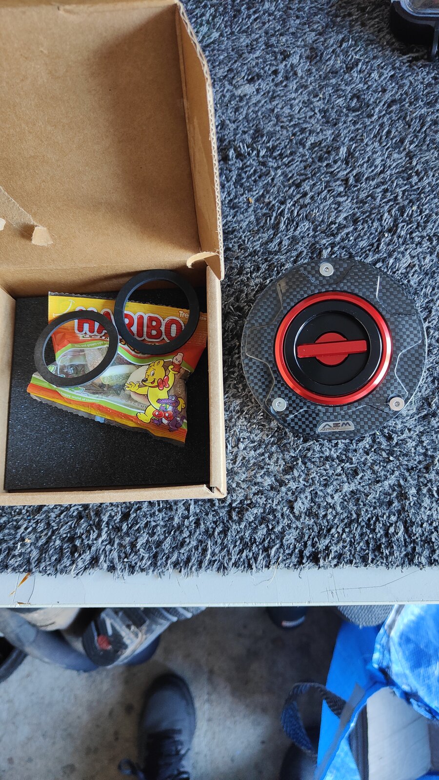

  8. @perry clarke can you post a picture of the cap the other way up ? I used a Spider qr cap on our first gen Diavel and that was a simple unbolt. The AEM cap looks very different. Andy
  9. Hello mate, yeah thanks....Conquest sent me a video basically showing how to attach the new to the base of the old, but not how to get the old off.
    Here's the vid so this bit seems ok...

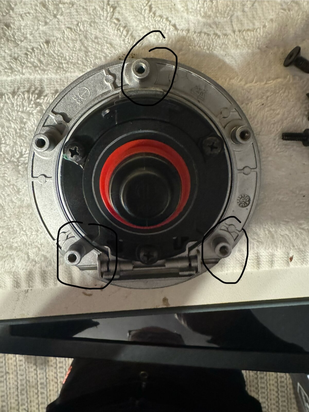

  10. Pretty sure I’ve still got the original tank cap, I’ll see if I can find it. Andy
  11. Here’s a photo of the underside or the std fuel cap. Looks like the 3 fixing holes you have on your new cap will screw into the 3 aligning holes.

  16. It's not quite that straightforward IIRC. The 2 drain/breather pipes are located on the sides of the petrol cap assembly and they exit under the petrol tank cover. Still looking for the whole cap assembly I sure I've still got. Andy
