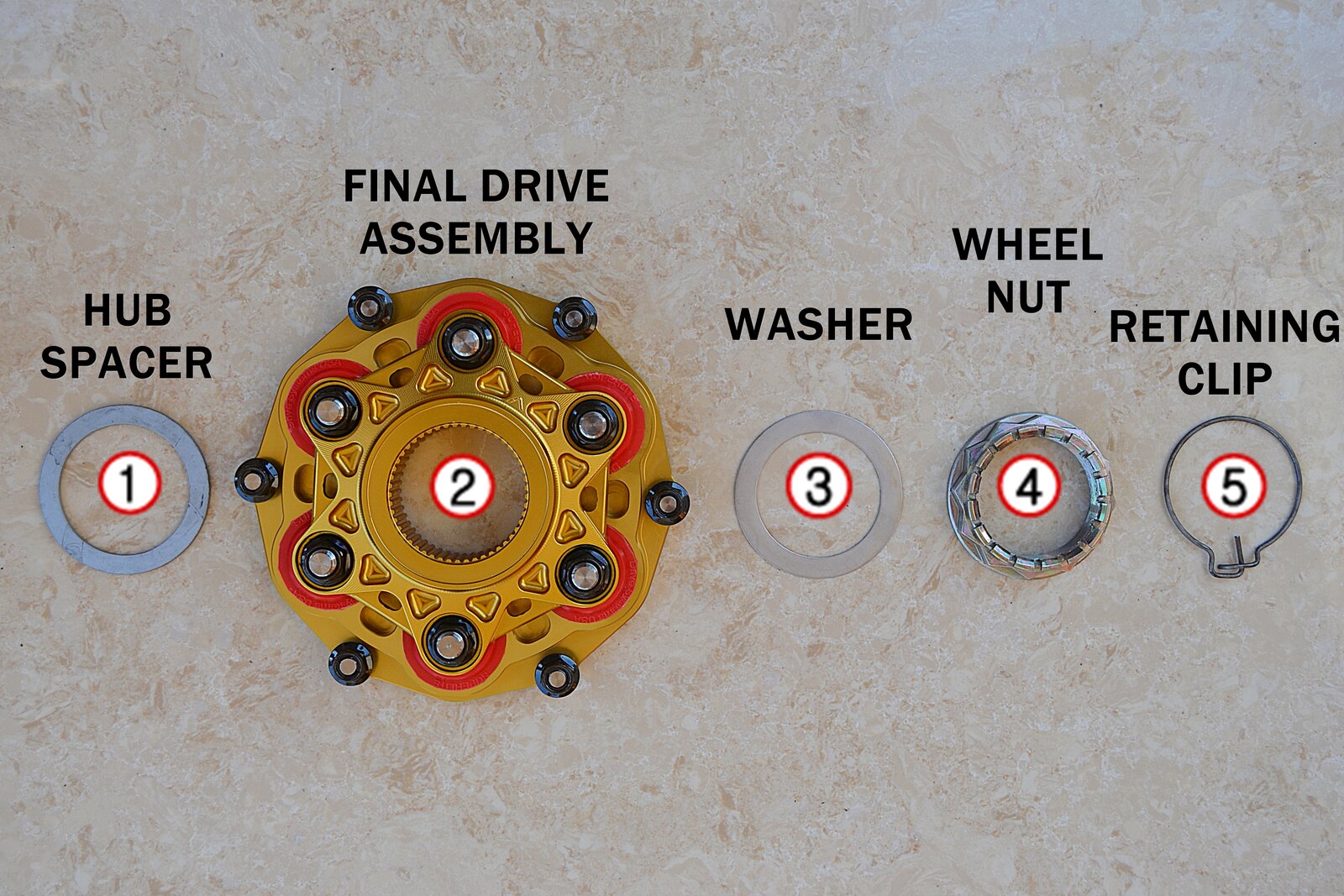

  5. The correct order of assembly... hub spacer (easily distinguished from the wheel nut washer as it's the thicker of the two), the complete final drive assembly (consisting of the sprocket/sprocket carrier, carrier flange, & cush drive pins), the washer, wheel nut, and retaining clip, with the wheel nut being torqued to 230 Nm.

  6. Khmer, many thanks for taken the time to do this-I figured it out though. I was putting the thick washer and thin washer together. I simply tried the thick washer between the hub and carrier and could see the sprocket was perfectly in line.
