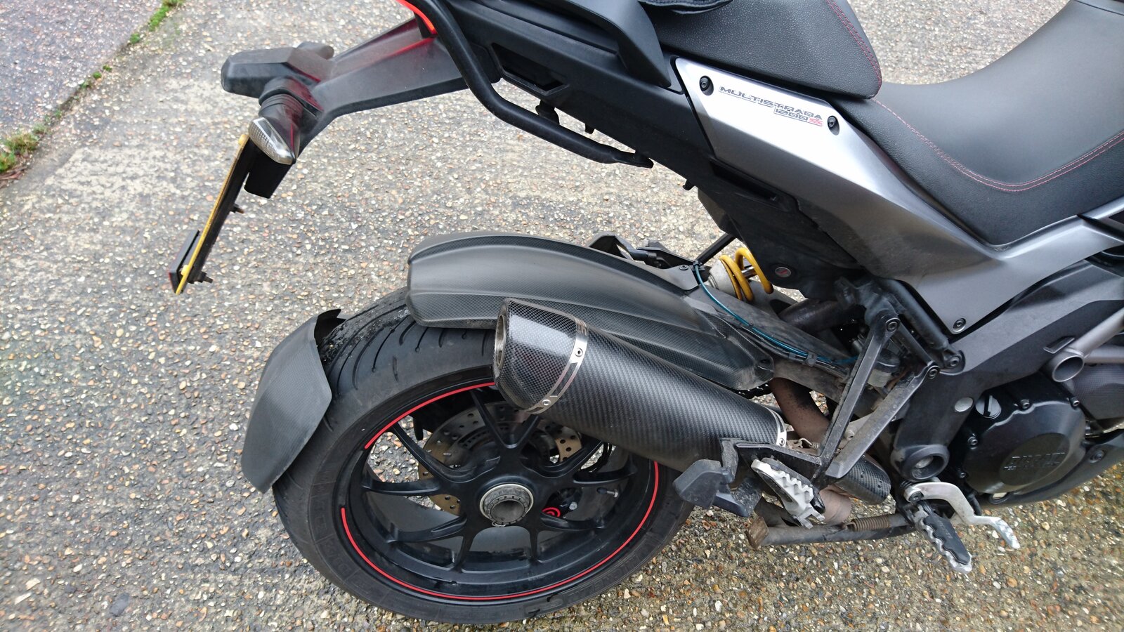

  4. I've got an SC project de-cat 3/4 system with baffle gathering dust on a shelf in the garage. Wasn't really planning to sell but not opposed to it. Needs a little welding on the mount which I never go around to doing. I found it quieter than the Arrow which I had on a 2011 model. If you were interested I can get a picture of the damage and you can see if someone can fix it. DSC_0023.JPG
