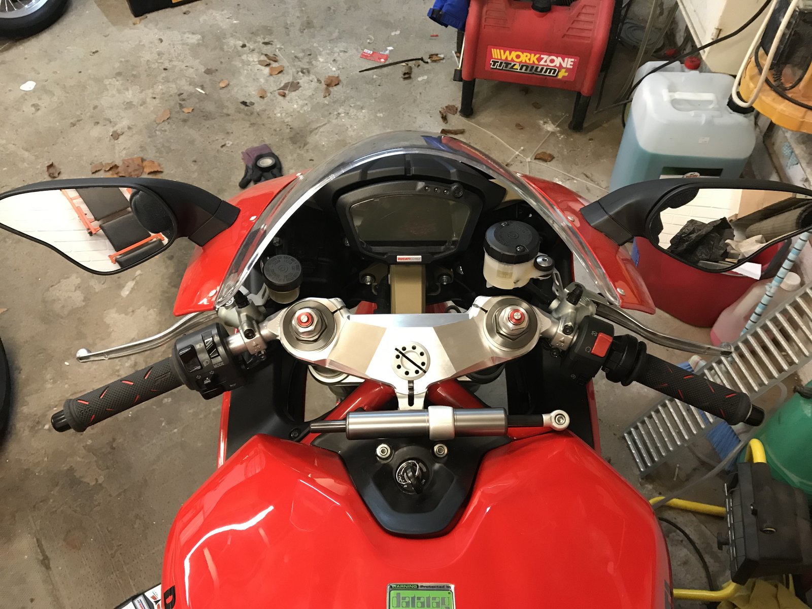

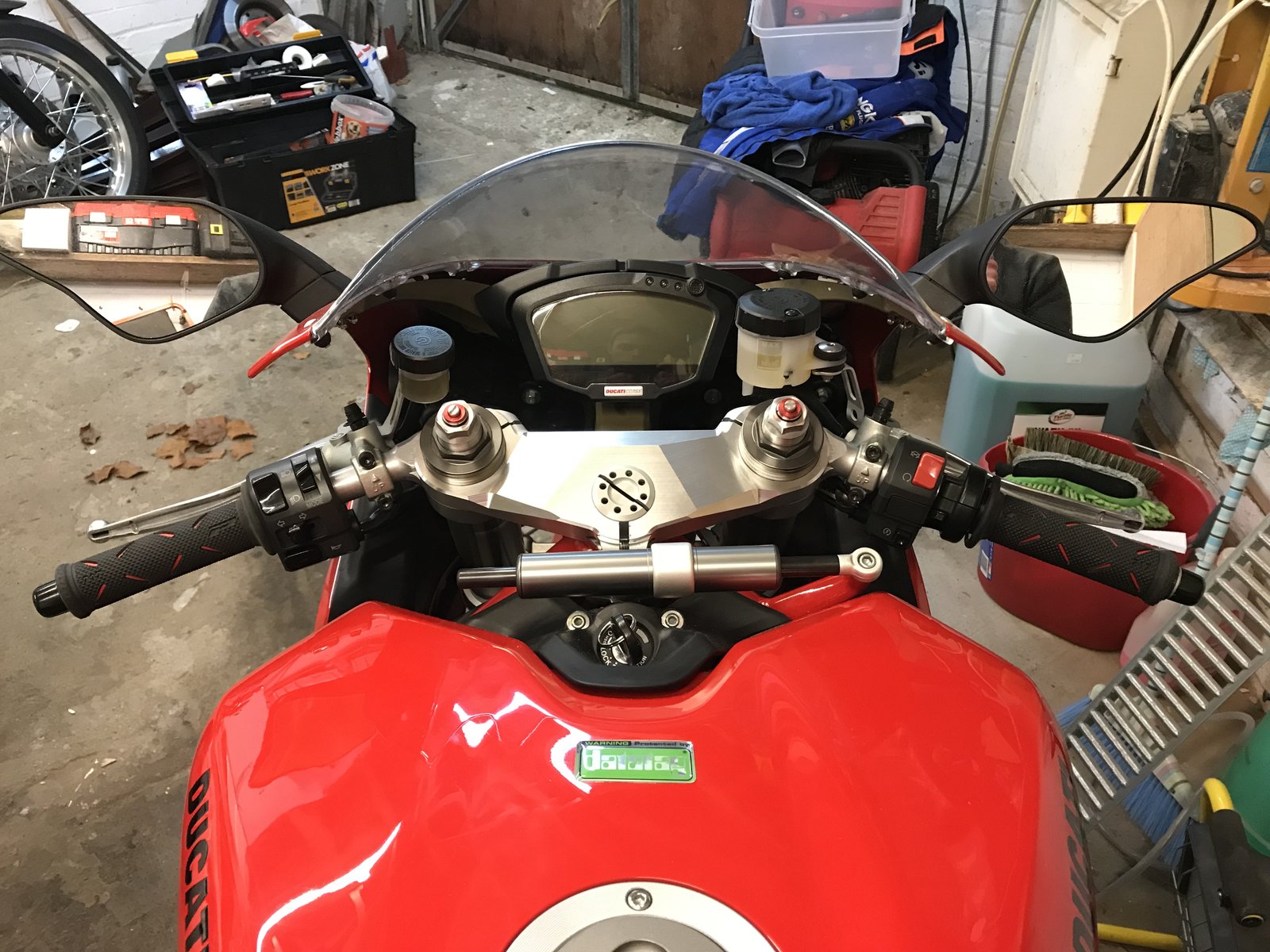

  1. I’ve just fitted these to my 848 and they are lovely. However the suggestion they give for how to angle them would mean there is no way you can use the steering lock. I’ve therefore fitted them as far back as I can but so I can use the steering lock.
    The upshot is that they are very straight, I’ve gone full Troy Bayliss in the way they are set up.
    I can’t ride the bike at the mo so I’m after some comments from others who have changed handlebars as to whether this is going to feel horrible when I ride it? It feels okay to sit on, the handlebars don’t really drop away (as expected) which might make it less comfortable at higher lean on trackdays but more comfortable on the road?

  6. The lock is limited by the steering lock mechanism, I could give myself some option to run the bars swept back if I shaved some metal from the 'Anchor' on the top yoke that the steering pin has to pass (if that makes any sense!) the bars would contact the tank long before the steering lock can engage.
    I rode the bike yesterday and after the initial weirdness at the amount of difference, I got on okay with it, the bike now seems to steer quite quickly, a factor of having wider bars I think. My friend rode the bike and REALLY liked it, says that to him it feels like the handlebar arrangement on the 899 where it's quite wide and flat and you can really boss the bike around.
