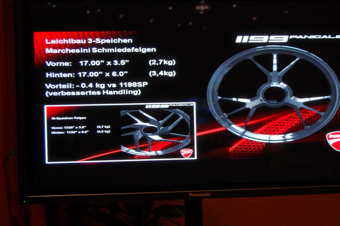

  6. Someone posted weights for the 1199 on another forum a while back:
    base wheels weigh 3.7 kg and 4.5 kg total 8.2 kg
    s wheels 2.7kg and 3.4 kg total 6.1kg
    and also in pounds
    199s forged and 1199 Base case wheel weights.
    1199s F Wheel = 6.8 lbs (w/ bearings, no rotors/spacers)
    1199s R Wheel = 7.8 lbs
    1199 Base F Wheel = 9.4 lbs (w/ bearings, no rotors/spacers)
    1199 Base F Wheel = 12.2 lbs
    Difference F = -2.6 lbs
    Difference R = -4.4 lbs
    Supercorsa F = 9.4 lbs
    Supercorsa R = 14.2 lbs
