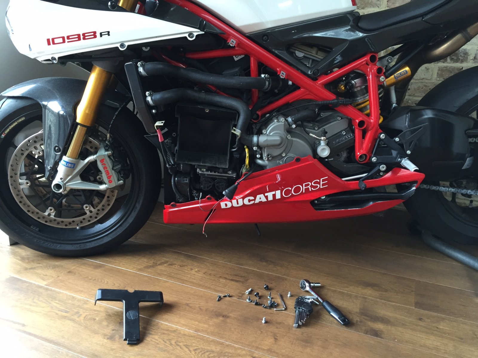

Rolled out my 999 today to take it out for a ride after 6 month in solitary garage. Battery is totally dead. Not even a light on the dash coming on. And it doesn't look like taking charge. Been on for 2 hours now and still no life . Battery was new (yuasa) last March and bike was last run in October with no problem on the button. Can new battery just die??? Anyone aware of any tricks? Pls help

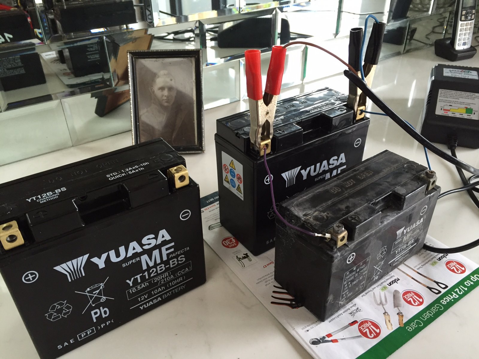

battery was totally dry, deffo no leak. just gave it a little shake to get juices going and see if this (my own method) will work.on charge again now

Optimates wont charge a completely flat battery. You need to fool the charger to get it going eg. connect another battery to the dead one to start it charging then disconnect good battery.
That's good to hear, and saved me from just throwing out a potentially perfectly good Optimate 3! do you know why it is, does their internal circuit just not allow the charge amps to push enough into the battery (i.e. only designed for top ups). I know it charge cycles so perhaps that's why
this is bloody spooky. every single battery in my house have died. except the one from my daily bike. even battery from the bike which is kept indoors is dead. trying to revive them now. long cue to the charger
