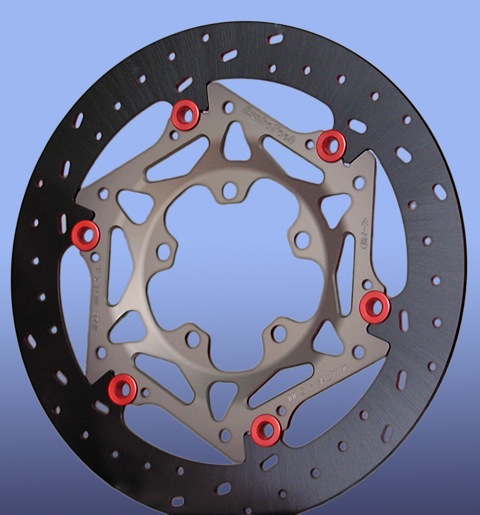

  4. why the wavy rotors?
    if you want the absolute best rotors for street use, look no further than these:
    https://braketech.com/axis-iron-rotors/

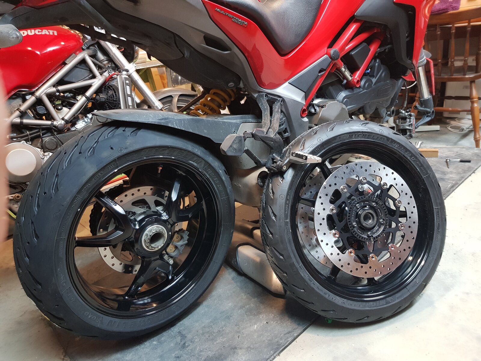

  13. I have just llast night installed brand new 330mm serie oro discs from carpimoto. Have yet to mount the wheel but looking forward to not pulsing to a stop every single time.
  14. If you fit these disks do you need to adjust the caliper as well, plus does it make it harder to get the caliper on and off?
    Thanks.
  15. Bolt straight on, no difference.
  16. No squeaking. They do have a better bite though, especially with the red pads.
