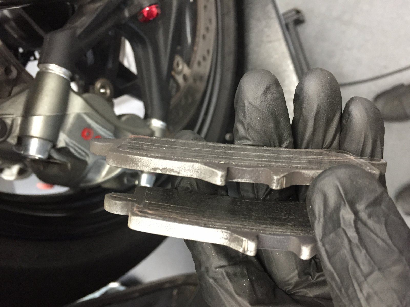

  18. I changed mine this morning and was very close to the edge or well timed lol IMG_4300.JPG
